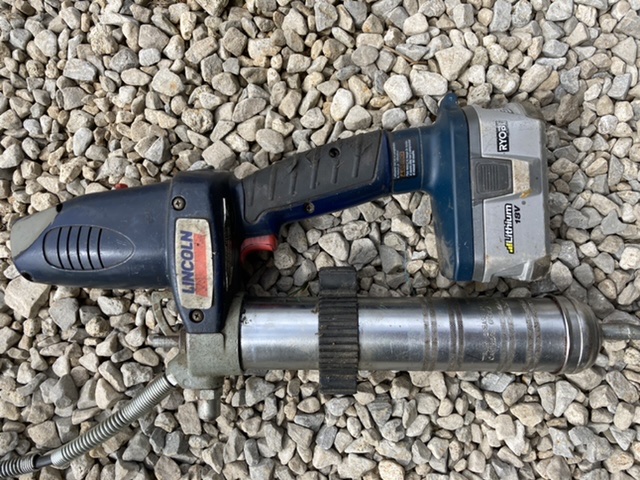

+1 Lock N Lube Couplers.
11 years ago I purchased a 12v Lincoln with only 1 battery, wanted it as light as I could get at the time so be the 12v, and 1 battery only gets charge about 1 to 2 times a year.
Purchased a Lock N Lube coupler a few years ago, and I should of bought it as soon as they came out...
Makes greasing the tractor is so easy a cave man can do it...
KC
