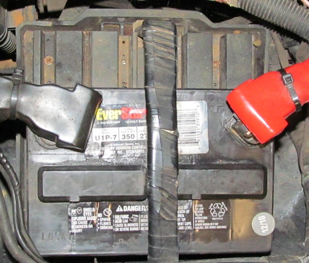

I guess folks are wondering why I went with the Walmart unit. 5 year warranty and I can buy a lot of them for the price of the others. Turns out my bad battery is not totally bad due to a very corroded connection. Corrosion was inside where I could not see it. I'll use it to run my 12V fueling station - should be good for a long time.
Again thanks for the help.

For what it's worth, I did a Walmart battery in my ct235, and cleaned up the connections, about a year ago. I haven't had to charge it or trickle it, yet it regularly sits for 2 or 3 weeks at a time.

Cleaning the posts and clamps once per year would save the needless replacement of literally thousands of batteries.

I actually have a lawn tractor battery in my little JD. Have the same battery in my 99 Mustang and on my gate openers. The one in the Mustang went bad after 5 years and got replaced with the same for another $25. :) I replaced the ends with heavy duty eyelet connectors. I always smear petroleum jelly on my connectors to keep corrosion from happening.
