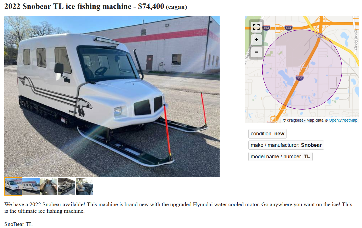

I see this morning that Hyundai has shut down its ICE development division.
Oh no! I see that Hyundai provided engines for Tracked Snow Machines. What will we do now?
Oh, wait ...
