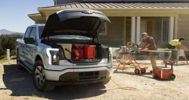

Speaking of the F150 Lightning, that truck looks amazing. I love the idea of their "frunk" that gives you the convenience of lockable storage in front to go along with the open bed in back.
That and the ability to power your home for anywhere from 3 to 10 days during a blackout, or run real power tools anywhere your truck can go. They had almost 50,000 preorders within the first 48 hours. Still trying to decide if I want to preorder or just wait until they hit the lots. Either way it may be a couple years before regular folks can walk in and buy one.

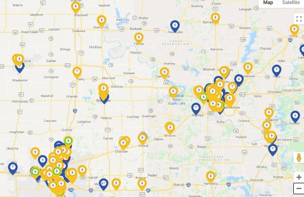

What happens when you decide to go on a long trip and there are only a handful of places to stop and charge the truck overnight?
Charging stations are almost everywhere. Here's a map from chargehub.com showing public charging locations around the Stillwater Oklahoma area. Some are even free! But I'm sure if you look out west you can probably find areas where they're far more scarce. Blues are L2 and yellows are L3 (DCFC) which can charge most batteries to 80% in about 30 minutes.
