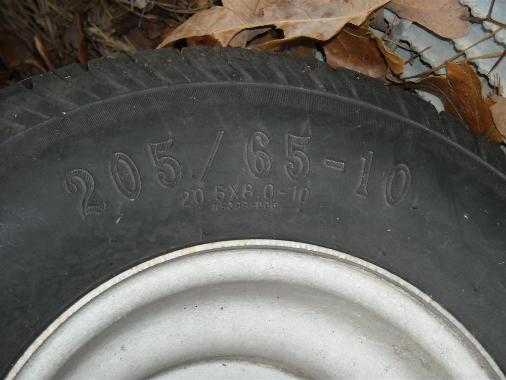

I guess you can always believe what you read!! :D According to my manual, it weighs 1962# with the rops. The 4wd is 2205#. Add a little bit for the fuids I guess.
The tires are rated 1100# each. They are 20.5x8x10.
Couple pics from Fridays visit to the country..

   / basic trailer build question #36
That is a nice looking trailer. I see the 2 WD tractor weighing 2200 with ROPS + 400 for the box blade. What I don't see are any brakes which makes it illegal up here in Canada except if you keep the total weight under 2000 lbs. What is good is that the tires do not look overloaded so if the officer does not notice the lack of brakes its likely you would pass visual inspection. I would put a hand on the tires after 30 minutes of hwy driving to make sure they are not getting too hot. I would expect a lot of sway witht he tractor positioned so far back. Another good thing is that the Pick up can handle a lot of tongue weight, maybe a 1000 lbs with weight distributing hitch so that would help with the trailer loading, (4600 lbs + 1000 on the hitch=5600)
Good eye. No brakes down here. As you mention I do have a nice sized tow vehicle. I thought about adding brakes if I used it a lot more than I do or if I drove like some do. I do stop at least once on my trip home...tires warm, pretty normal. As I mentioned the trailer came out a bit heavier than I thought, more tongue weight than I wanted to. But more tongue weight is better then to little. In the picture with the ATV, that 600# atv is about 4' from the ball! And another 550# Rancher in the bed. Nope the trailer didn't wag or sway. As I mentioned that to depends on how you tow it too.
If I had to change anything on the trailer...I might move the axle up a few inches(easy to do now, hangers are cheap), make a smaller and lighter bulkhead up front, and use lighter material for the deck thus lowering it. Of course making it from aluminum would have been really cool!! But I pretty much built exactly what I wanted, I haven't seen another sled like this in Texas!
I do get some looks though. ALL like it. Especially when we load feed, grass, or other things on a skid from the side my removing the side rails.
