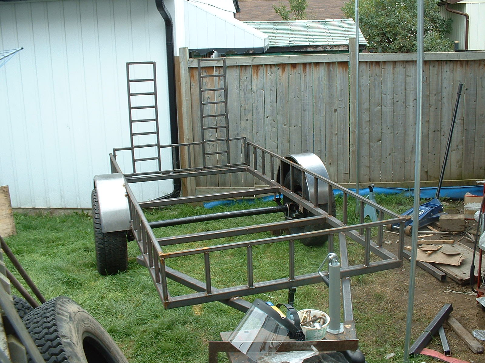

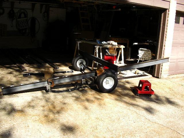

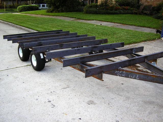

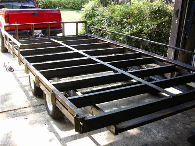

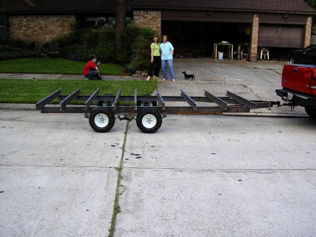

Ok my take...
1) got to go with dual axles. Around here that's less than $100 more
2) stick with a regular leaf spring, cheaper to. I think my 2x 3500# complet kit, hangers, springs, etc, was under $200.
3) I think the steel you have is fine, use the heavier stuff. The extra axle will help sperad out the load.
4) my good friend Lbrown mentioned using 16" tires. I built a deck over (sled) and found some 10" wheels rates at 1150# each. So with my trailer and stuff, I'm under that. Plus my deckis 7.5' wide, and I can remove the 3 sides if needed. The front bulkhead is welded solid.
5) look for surplus steel, Mine is made from 5.5# 5" channel. It came out a little heavier than I wanted (would have gone with 4 or 3" top rails) but I got the clean surplus channel for around 35 cents a pound.
I went 14', just did, my RC hangs off the back a little, so what. The 7.5' deck is really nice!
Couple pics.

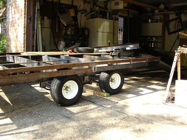

RobJ, what tire size and brand are you using under your trailer ? You say they are rated for 1150 pounds each, wich is 520 kg each or 1040 kg per axle. We used to sell a 20.5x10.0-10 or a 195/50R10C tire which could both carry 750 kg per wheel, 1500 per axle, closely rated to the carrying capacity of your axles..
My brother has a car hauler with tires of similar size, only a lot more narrow, those are 12 ply tires, look like forklift truck tires. When empty, the trailer bounces all over the place.
From the pics it looks like you use the same C-channel for crossbars and main frame runners ? If so, you could easily do with half the size of the crossbars and still have high technical reserve. We used to use 60x40x3mm tubing as crossbars for trailers up to 8 ton ;) The structural integrity of a trailer frame depends more on the side rail (to distribute pointloads over several crossbeams) than on the actual size of the crossbars themself.

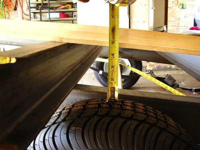

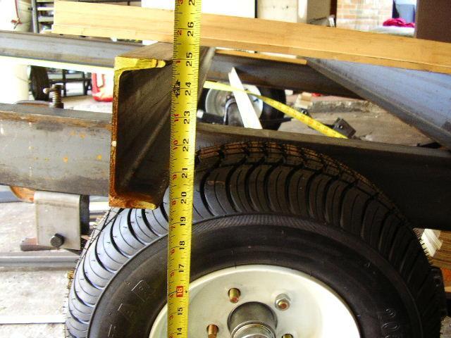

Renze, Can't tell you the actual size, I'm going up to the place tonight and will take a pic. I think they are 20.5x10xsomething. They were the highest rated I could find at Northern tool. So if each tire carries around 1100#, I'm within range.
Agree on the second part, But I bought the steel surplus and this was nice clean 20' channel if I recall. At SSS Steel here if you don't buy it when you see it, it might be gone tomorrow.
Here you can see some of my early thought process...I really only use it a few times a year to bring the tractor home. About 120 miles one way. BIL law used it to haul a Kuhn Kutter and other stuff around.

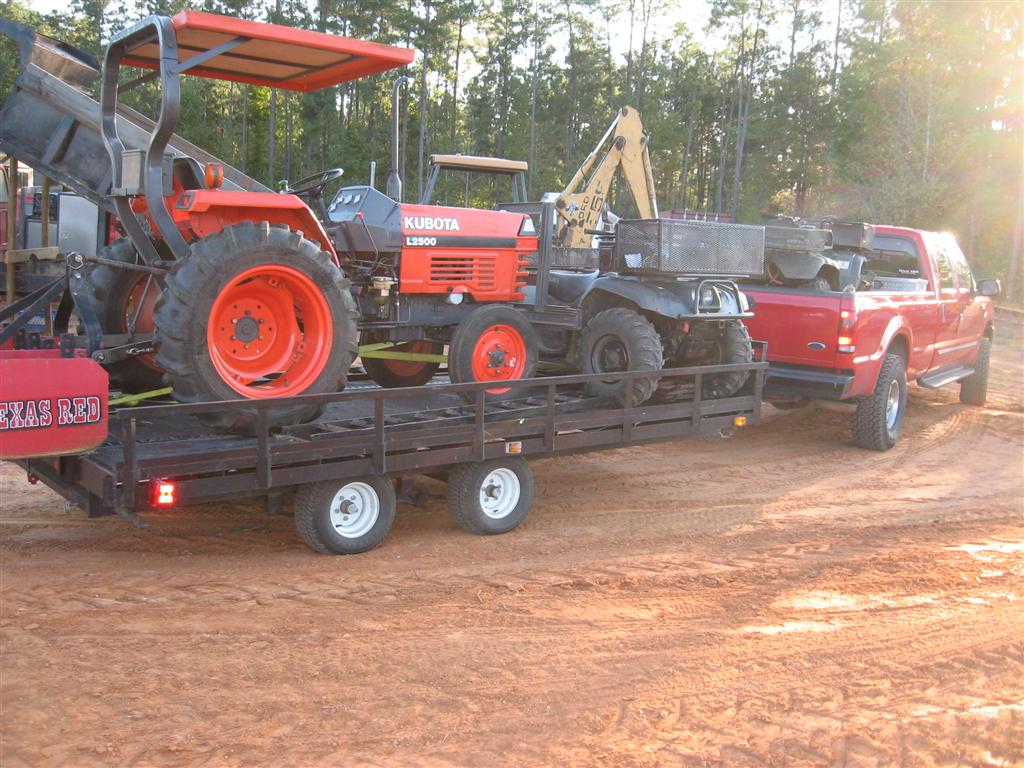

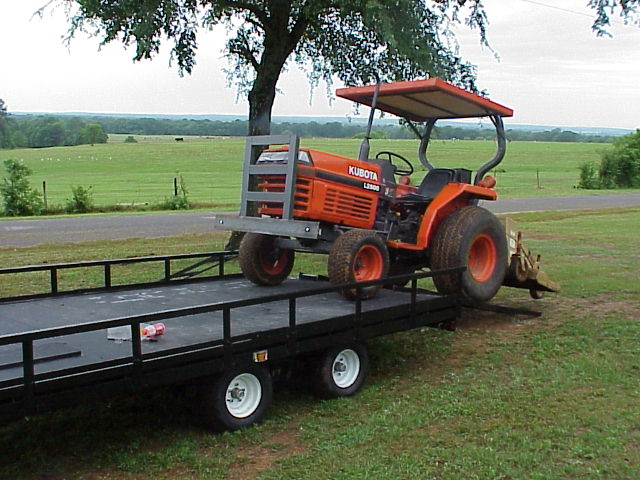

Yep close as mentioned, more than usual. Usually 1 ATV stays home! At around 25" up, it's still not to bad loading.. Oh here is my usual load.. I would guess at 2300-2400#

RobJ,
I was going by tractordata.com which lists your tractor at 2700 plus the weights you just mentioned = 5000 which is 400 above the 4 tire rating. If your tractor is 2WD it may be lighter.

That is a nice looking trailer. I see the 2 WD tractor weighing 2200 with ROPS + 400 for the box blade. What I don't see are any brakes which makes it illegal up here in Canada except if you keep the total weight under 2000 lbs. What is good is that the tires do not look overloaded so if the officer does not notice the lack of brakes its likely you would pass visual inspection. I would put a hand on the tires after 30 minutes of hwy driving to make sure they are not getting too hot. I would expect a lot of sway witht he tractor positioned so far back. Another good thing is that the Pick up can handle a lot of tongue weight, maybe a 1000 lbs with weight distributing hitch so that would help with the trailer loading, (4600 lbs + 1000 on the hitch=5600)

I guess you can always believe what you read!! :D According to my manual, it weighs 1962# with the rops. The 4wd is 2205#. Add a little bit for the fuids I guess.
The tires are rated 1100# each. They are 20.5x8x10.
Couple pics from Fridays visit to the country..
Good eye. No brakes down here. As you mention I do have a nice sized tow vehicle. I thought about adding brakes if I used it a lot more than I do or if I drove like some do. I do stop at least once on my trip home...tires warm, pretty normal. As I mentioned the trailer came out a bit heavier than I thought, more tongue weight than I wanted to. But more tongue weight is better then to little. In the picture with the ATV, that 600# atv is about 4' from the ball! And another 550# Rancher in the bed. Nope the trailer didn't wag or sway. As I mentioned that to depends on how you tow it too.
If I had to change anything on the trailer...I might move the axle up a few inches(easy to do now, hangers are cheap), make a smaller and lighter bulkhead up front, and use lighter material for the deck thus lowering it. Of course making it from aluminum would have been really cool!! But I pretty much built exactly what I wanted, I haven't seen another sled like this in Texas!
