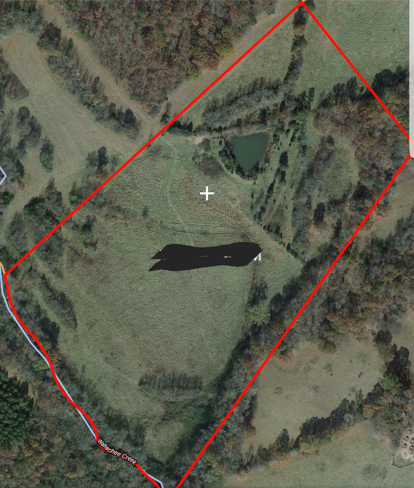

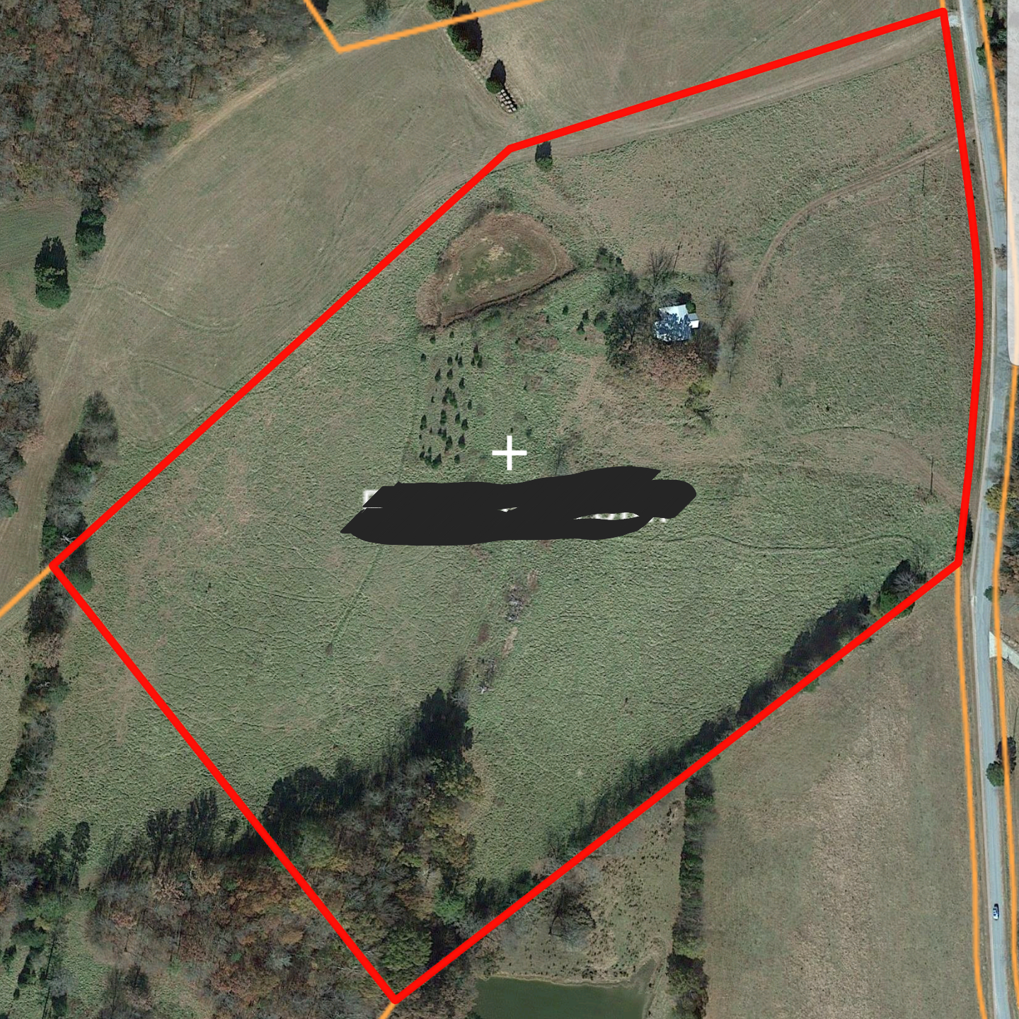

The front parcel is gently rolling with roughly 18 acres of pasture and 2 acres of woods, most of that is perimeter woods with some scattered trees.
The back parcel is essentially level with an abrupt slope down from the front pasture. Roughly 27 acres of pasture and 7 acres of woods, again, mostly perimeter woods with some scattered about.
So...primarily pasture. I would keep the few acres around the home site close cut and the rest rough cut with a rotary cutter.
Horses may be in the future.
As far as size of tractor I've been pricing Cab tractors in the 40-55 hp range.

You will have 45 acres of weed trees if you don't keep them maintained. Have you approached your neighbor to the north about haying your land?
It looks like in 2014 they had a lot of round bales.
/ Basic Question
#31
Ok, I'm running on 1.5 hours sleep. How can you tell what was going on in 2014?
