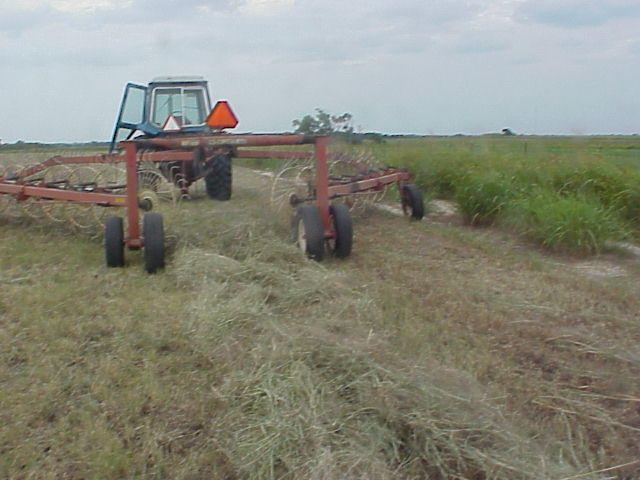

I'll never understand how people think a 180 degree corner is easier/faster to negotiate than a 90 degree corner. Cutting in multiple strips/lands takes longer than going round & round. I rake 3 nine ft swaths at a time with my H&S Hi-cap rake and have no problem raking around corners.

It is true that round and round, in theory, you never stop, while strips/lands you have travel time on headland that is the machine is not "working"
Baling while towing a wagon and stacking squares is a pain with 90s, chute always has a bale coming off when turned from the wagon = bale on ground.
I think it's also dependent on equipment size and field size. I run smaller gear in smaller fields, so for me it's way more trips around the field than if I ran larger gear. I find making 90's all the time takes more time and concentration than simply clearing the swath/windrow and making a gentle arc. I also mow with a 3pt disc mower, higher speed perfect 90 degree corners I loose speed on and risk the cutter bar break away snapping from sudden change in direction. I do round and round on one large field that is a near perfect rectangle. Irregular small fields strip mow wins every time.
