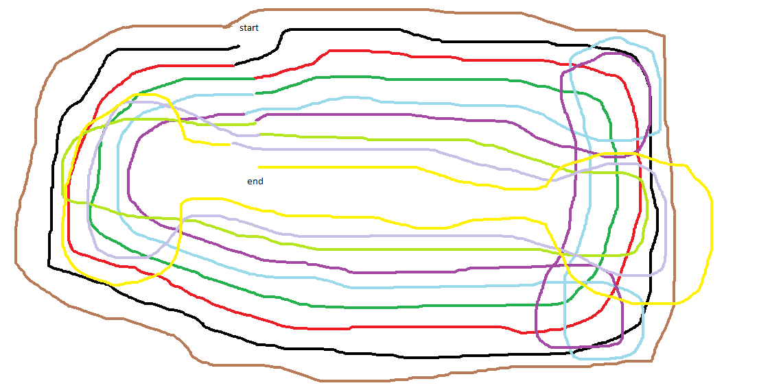

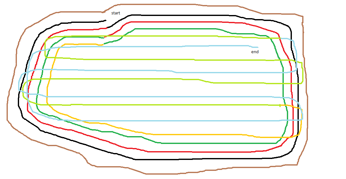

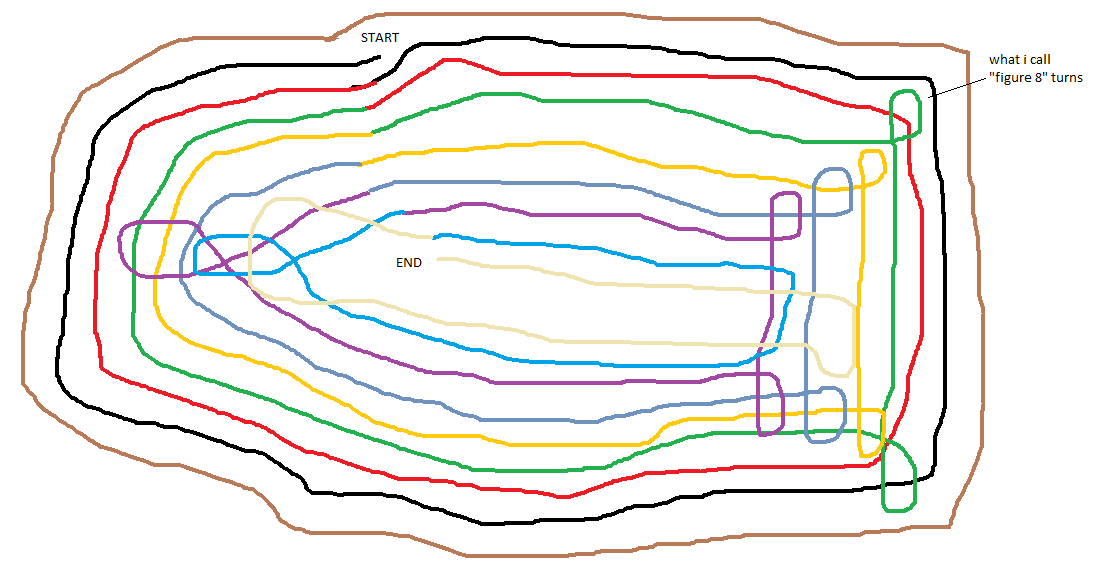

Many around here use a small baler and wagons. 90 degree turns are a pain in the neck with that set up.
Some of our fields from the air look like figure eight's due to natural issues like creeks, ponds, woods, hills etc.
Actually you have less corners doing strips..
I'll never understand how people think a 180 degree corner is easier/faster to negotiate than a 90 degree corner. Cutting in multiple strips/lands takes longer than going round & round. I rake 3 nine ft swaths at a time with my H&S Hi-cap rake and have no problem raking around corners.

It is true that round and round, in theory, you never stop, while strips/lands you have travel time on headland that is the machine is not "working"
Baling while towing a wagon and stacking squares is a pain with 90s, chute always has a bale coming off when turned from the wagon = bale on ground.
I think it's also dependent on equipment size and field size. I run smaller gear in smaller fields, so for me it's way more trips around the field than if I ran larger gear. I find making 90's all the time takes more time and concentration than simply clearing the swath/windrow and making a gentle arc. I also mow with a 3pt disc mower, higher speed perfect 90 degree corners I loose speed on and risk the cutter bar break away snapping from sudden change in direction. I do round and round on one large field that is a near perfect rectangle. Irregular small fields strip mow wins every time.

You are turning 180 degrees, but it's not like you are locking the brake and spinning around 180 at once.
Turn wheels about 45 degrees you go in a somewhat rainbow shape arc (yes it's flat at the top if your land is wide)
The only time the mower snaps on a 90 degree turn for me is at 5 MPH + and I'm turning uphill in heavy hay on rougher ground and the mower is at the point it stops swinging backwards and starts moving forward again (My perfect 90 degree turns at speed I am locking the right brake and pivoting the tractor on right tire)
If I wanted to do sharp turns all the time I'd make 90s. 90's are also harder on PTO joints on pull type machines. My round baler doesn't like 90 degree turns and I don't like running the windrow over with the tractor tires. Also don't like bouncing across dead furrows. I run a 3pt tedder that doesn't turn corners in the hay, you have to lift it, so to ted properly (tedder takes 2 mower swaths) you have to turn in a 270 degree loop after lifting tedder to follow the 90 degree turns. If I raked in a circle (yes rake would always stay in the hay and make "one" window) it's not easy to double up windrows (NH side rake, 17' two passes, don't run a nice V rake) and in the middle you are driving around until you are "trapped" and then either ruin the windrows pulling the rake back out (pull type) or leave the rake in the middle and drive the tractor over the raked hay.
I still say it depends on field size and layout and equipment set up. I use both methods, but strip mow fits the bulk of what I do. I don't see round and round assaving me any time when you factor in all four passes (mow/ted/rake/bale) and having to go slower crossing the field in the bulk of the fields I hay.
