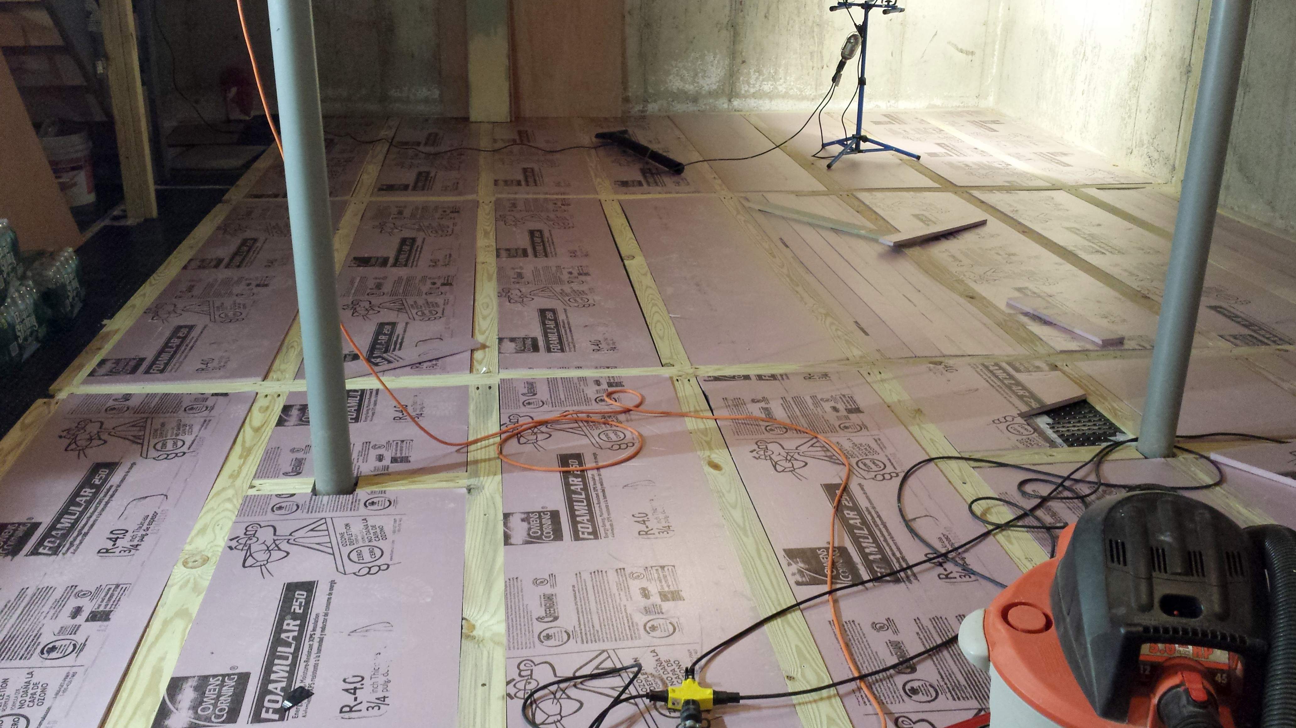

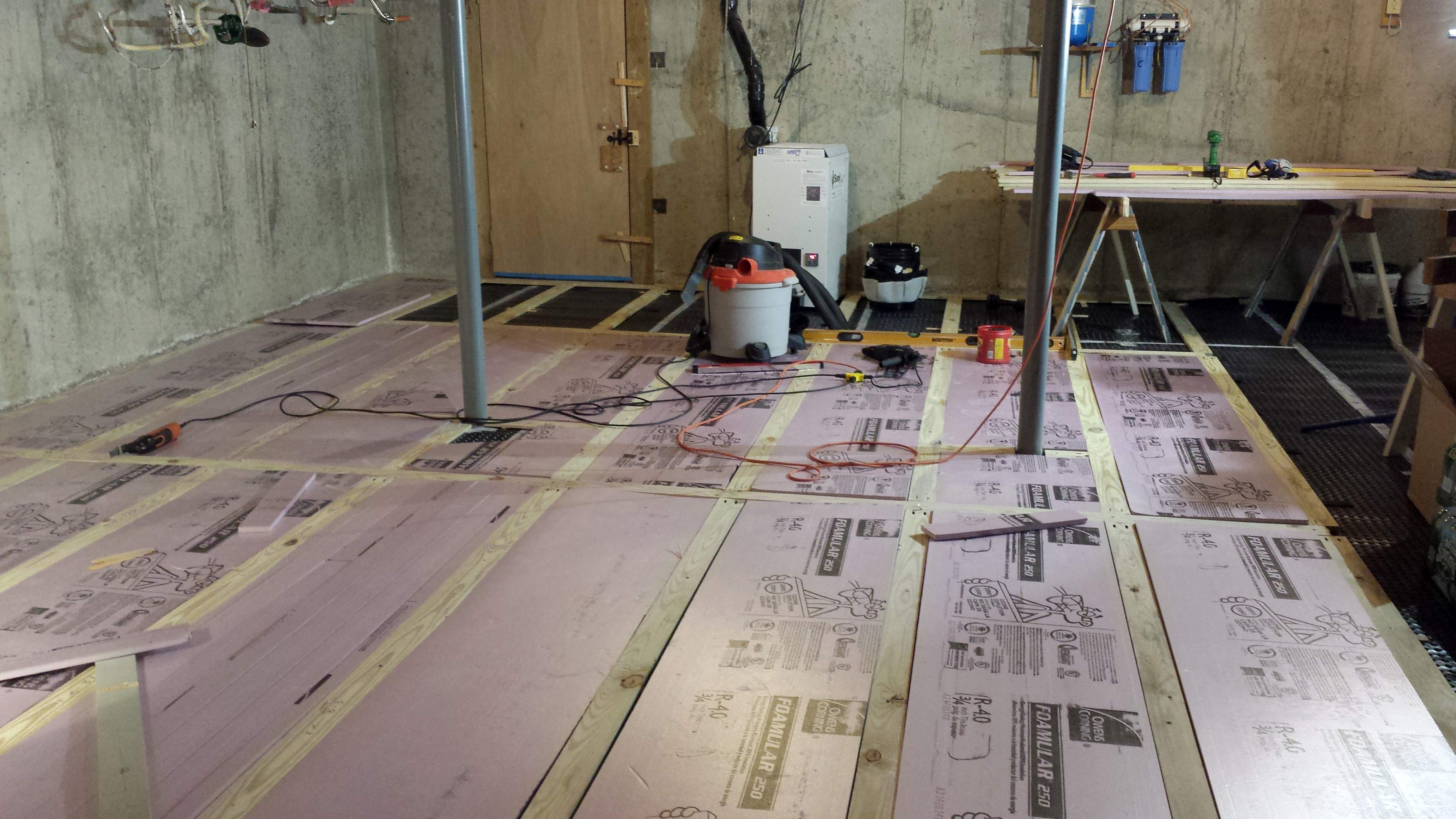

Just a few pic's of where things stand now. Didn't get too much done over the holidays due to being sick and then everything else going on. Just got the subflooring yesterday and hope to start putting that down soon. I need some finished square footage so I can move stuff around in order to finish putting down the Platon vapor barrier and sleepers on the other side. When you live in a house for over 25 years, you accumulate too much junk (that your wife won't let you throw out - ha)!

/ Basement Sub-Floor Using Sleepers - Need Some Pointers #43
Hello,
Since you only used 3/4" material as joists, how are you going to nail down hardwood flooring ? Or are you putting down a subfloor on top of the joists? Do they make short nails to fit hardwood flooring nailers and will short nails hold ok ? What is the spacing between the floor joists ? I saw places where you shimmed that set a good section of the joist up off the floor.....won't that cause a lot of deflection of the joist and cause the floor to be bouncy? Maybe you should [put in some more shims closer together to give more support. I'm not trying to bust your....just some observations and some questions. Good luck, I hope everything turns out fine !!!!

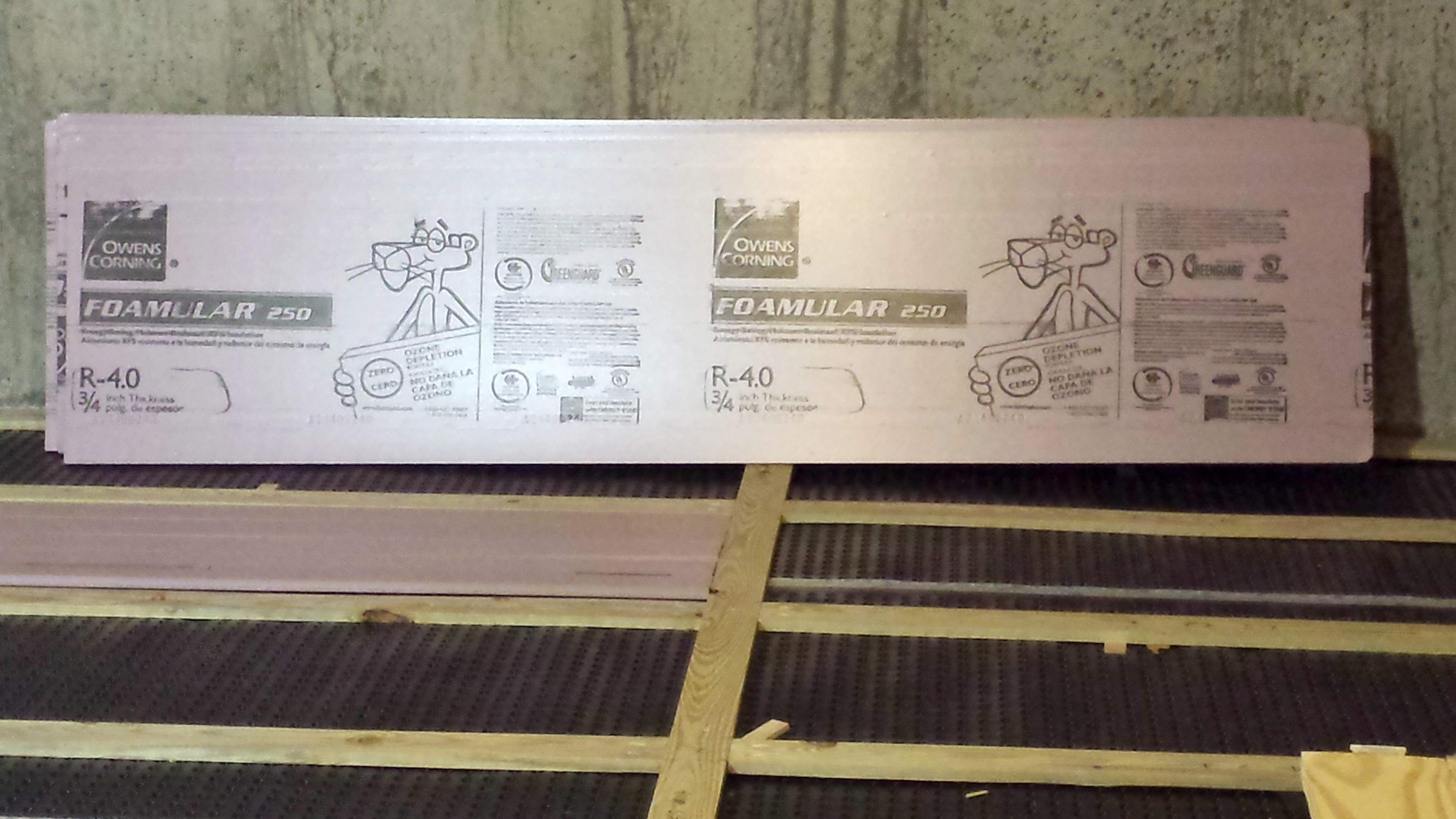

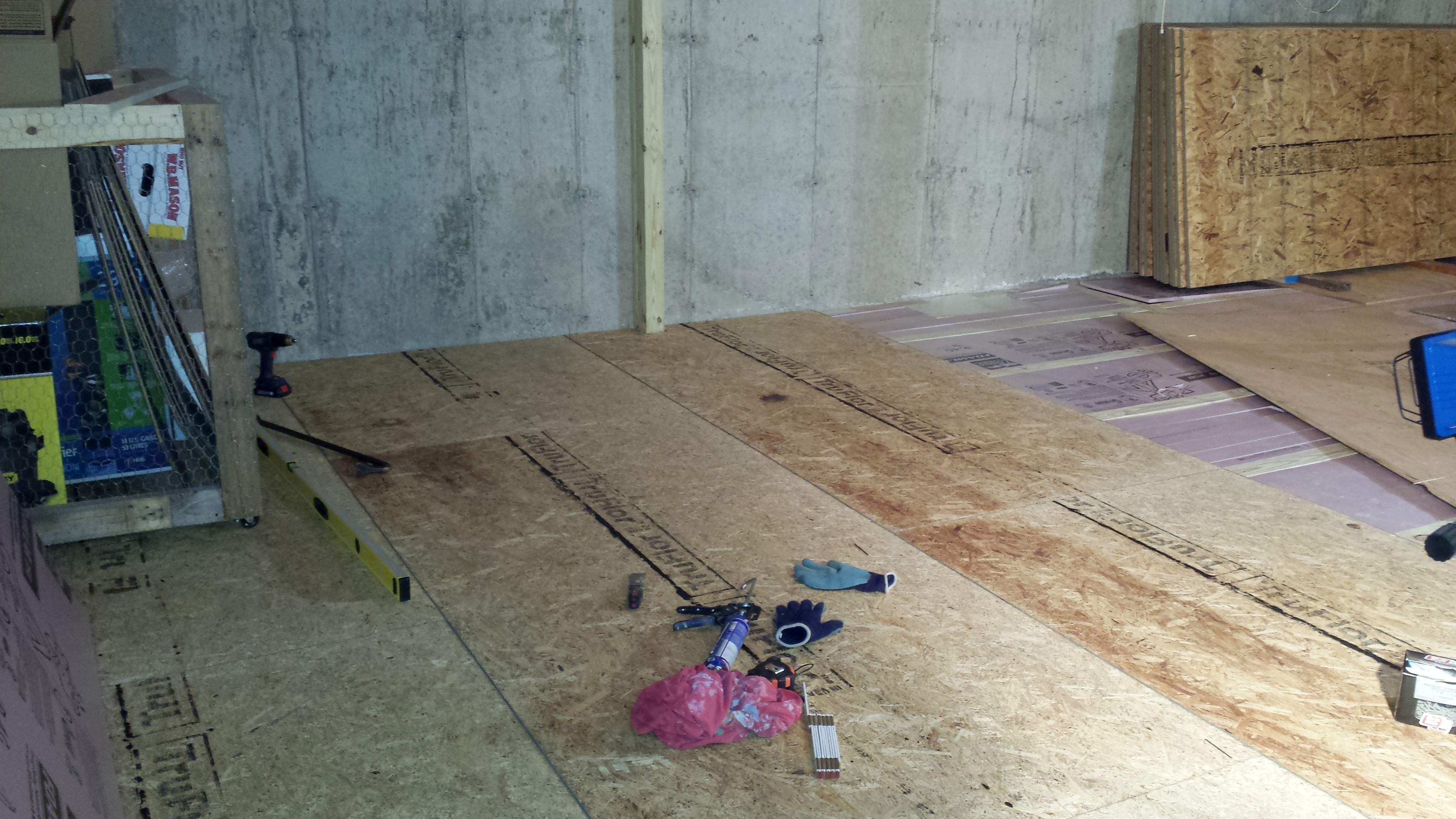

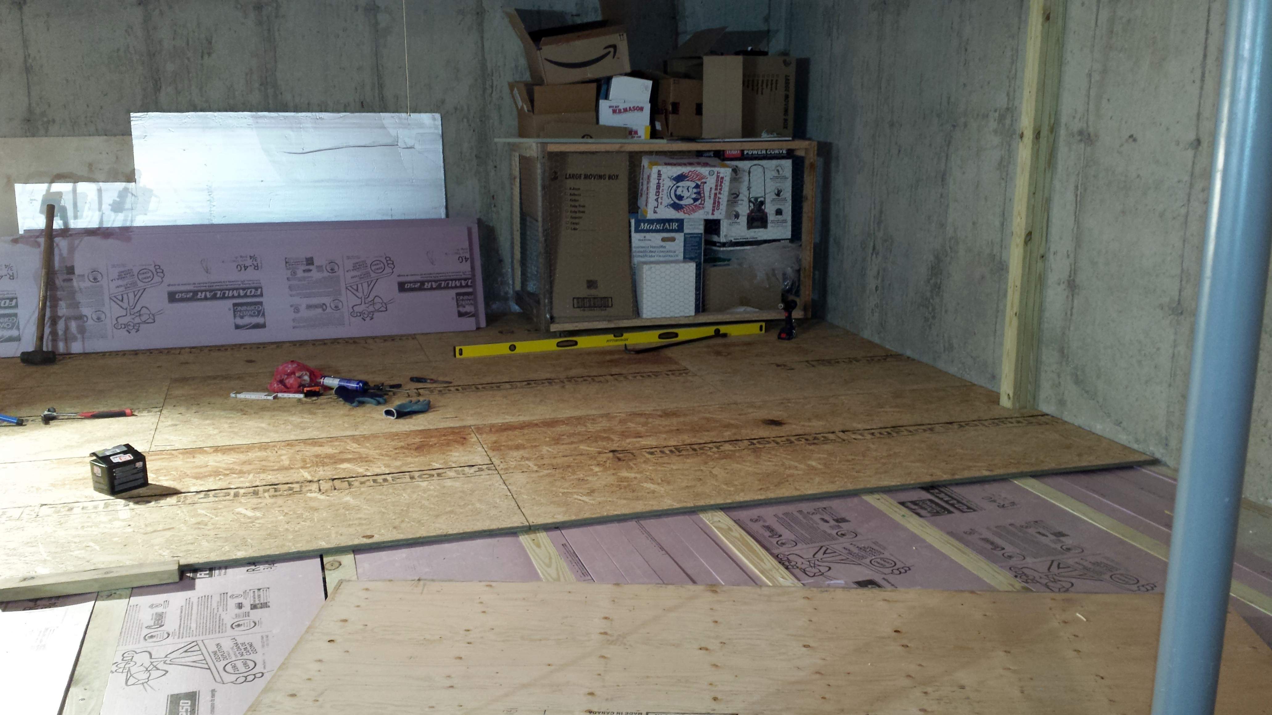

I'm putting 3/4" T&G OSB subflooring down for now, rated at 24" OC max, which is more than what my frame openning is. I've been adding shims and tapcons wherever I find defection. These pic's are in progress so you're not necessarily seeing the final set up. Also, I switched to black composite shims early on so you probably can't see all of them. Anyway, got some of the subflooring down and nice a solid so far. If necessary, I can come back and add a few tapcon's wherever necessary to eliminate any flex, but like I said, so far none needed.
By the way, when I was putting the insulation boards in I started cutting them with a utility knife and straight edge guide. That got tiring so I tried running a test piece through my table say. Wow, cut's nice and straight with no tearing except a little right at the end sometimes. Only issue is it leaves a lot of residue on the saw blade that doesn't want to come off easily. The blade is old so I'll just change it out once I'm done with the insulation.

I was originally going to use Dri Core until I realized how rough the leveling job was. I literally have ridges in a few spots. I would have skipped the sleepers if the floor was close to level, which would have saved a lot of time and expense. No, there's no vapor barrier under the slab if that's what you're asking. Also no plastic between the Platon and cement slab. No other organic material touching the floor. I've vac'ed up everything I could first and have tried to avoid even getting sawdust under the Platon. Best I can do. Neighbor across the street put plastic right on the slab and sleepers on top of that 20 years ago and he's said he's had no problems, but who knows what's under his subflooring at this point.

Hello,
The last two pictures that you posted look really good. I'm glad that everything feels nice and solid. So, now what are you going to put on top of the subfloor.....hardwood flooring, tile, carpet ????? Looks like you'll have a nice floor whatever you choose !!!! Good luck !!!!

Nothing for now. Just going as far as the subfloor at this point. I wouldn't put anything over it unless we decide to finish the basement. In that case maybe laminate or carpet squares. Not sure.

Well, now you tell me, LOL. Never heard of Crystalline waterproofing but it sounds like the solution I was looking for. Too late now, but I'm not that worried. The dehumidification system will keep the relative humidity below where mold will grow and the Platon membrane should prevent any dampness that does come through the slab from getting to the subfloor. As to the weeping system, I may dig it out in the one back corner of the basement near my bilco doors that seems to be the dampest come Spring. All in all, at this point, I'm pretty comfortable with my approach. If I were starting again, or for my next house someday, I'll take a look at this waterproofing system. Thanks

Just to close this thread out, I did finish up the subfloor about three weeks ago. Just never got around to posting an update. The basement seems so much more hospitable with just the floor in. Makes me want to finish it as a man cave, etc, but the dear wife say no-no for now. Truthfully, this is as far as I planned and wanted to go for now anyway.
