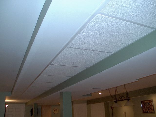

I plan to start finishing a good part of my basement soon. I have been considering sheet-rock (drywall) ceiling over a Drop Ceiling. It looks as though you went this way. IF I see correctly.... Was it the finished look you liked more?... verses accessabilty?
My concern is if I need to access the space in the future and having to tear out ceiling for repares. But the sheetrock finish sure looks so much better.... than grid ans tiles....

I actually did both. Here's a pic of the single row of ceiling ties I used in the soffet. Its tucked up behind the main soffet, so you don't even notice it. My water lines are above the tiles.

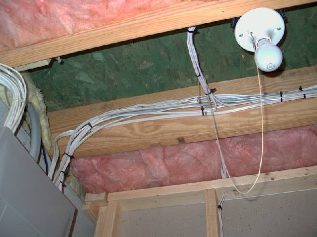

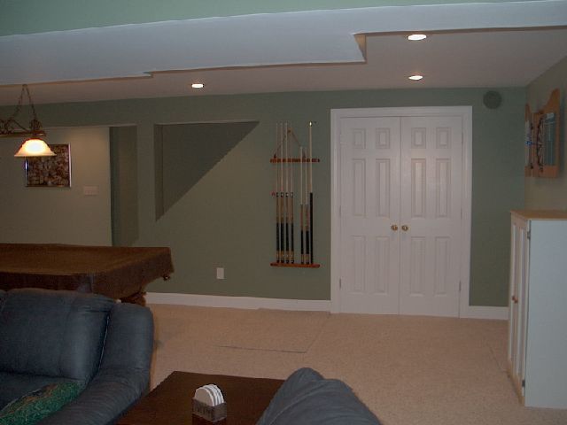

Here's a pic of the ceiling above the panel. I left one joist space without insulation so it would be easier to add wiring. This "channel" is only about 8' to the ceiling tile soffet.
Another comment on drop ceilings. It was actually cheaper for me to drywall the ceiling than it would cost to put in a drop ceiling. This cost also includes paying a pro to finish the drywall. After I did that math, it was a no-brainer for me.
