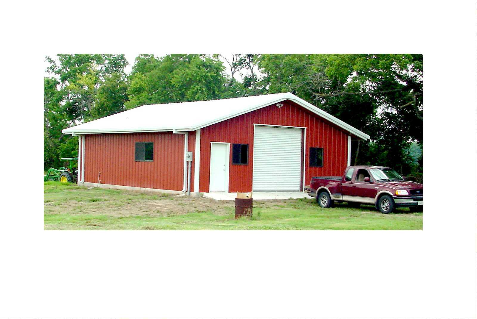

Brandon - Look at <font color=blue><A target="_blank" HREF=http://muellerinc.com/>http://muellerinc.com/</A></font color=blue> for their pricing. Look at the S.P.E.E.D. buildings. You can enter the size you want and it will give pricing for different wall heights and roof pitch.
I was very happy with Mueller. They made a couple parts wrong but responded very quickly and had the parts remade.

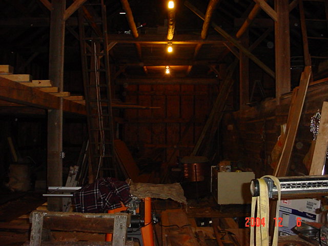

Rancar,
I put a few interior pics of the barn on my site. Check my profile. Look in the Barn folder. Sorry they are so dark, but you should still be able to see a decent amount of the beams etc.
- Gerald

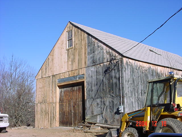

Here's my 2 story with a 3rd floor loft 36'x60 almost finished barn circa 1830's. There is also a full basement under it.

Here's the front. The 16 light 12 foot barn door front window will be finished next week if I get around to it.
