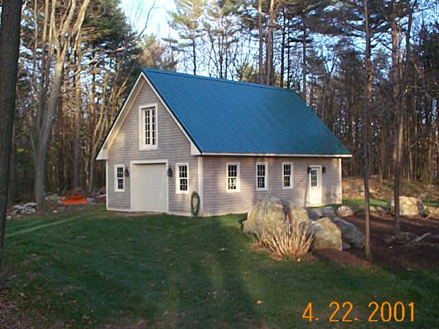

/ Barns #27
Tsh3,
24x36 footprint 12/12 pitch means 24' wide by 36' long and a 12/12 pitch means for every 12" up 12" in, so effectively at 4' inside the outside walls upstairs there is 4' head room. Here's another shot of the upstairs.
A more direct answer is we have about 16x36 effective area to use upstairs. Since I'm 6'4 tho its 14x36 without too much head knockin.
Carl
