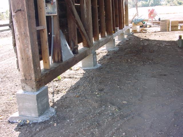

I am finally getting around to an update, My wife and I just became foster parents for 2 little girls on the 11th of August. I thought I was tired before /forums/images/graemlins/shocked.gif Anyway this slowed down my progress a little /forums/images/graemlins/grin.gif but I have been hacking away albeit slowly.
Here is the north wall with the forms pulled.

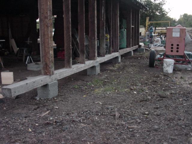

Here is the south wall piers completed and far base beam replaced.

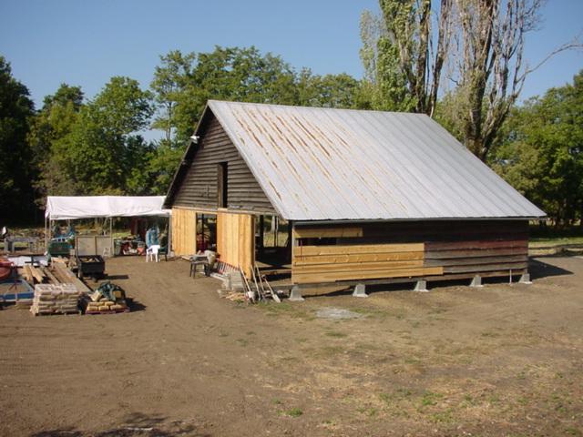

I am getting to the point where I have to deal with the floor, so that meant clearing all my stuff out of the barnshop. That meant creating some kind of temporary shelter. I had 2 10x20 shelters that I had been using before but had trouble keeping on the ground due to winds. I found some 8' galvinized poles and drove them in to the ground and bolted the awnings to them. Then I cleared the barnshop out....
This is a kind of overall progress shot, one of the shelters is hidden behind the structure. I placed them close to access my tools and compressor.
