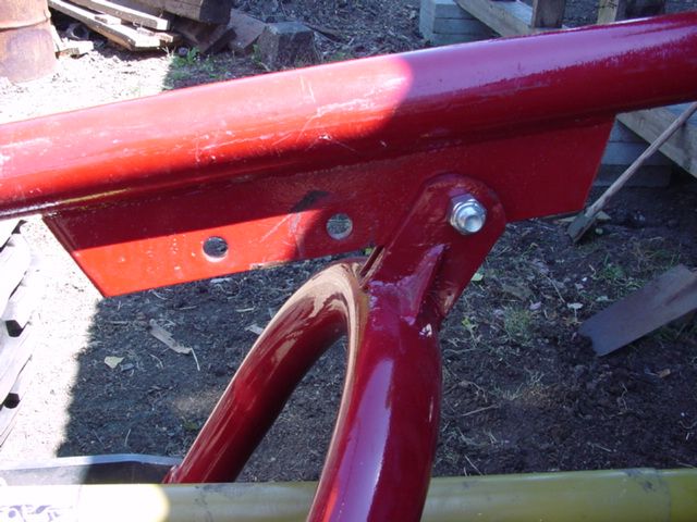

</font><font color="blue" class="small">( Boom support all the forword..... )</font>

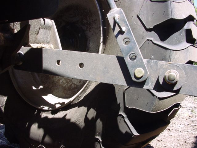

   / Barn to workshop
#122
</font><font color="blue" class="small">( raised the lift link to the bottom hole..... )</font>

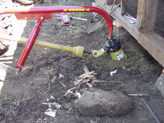

#123

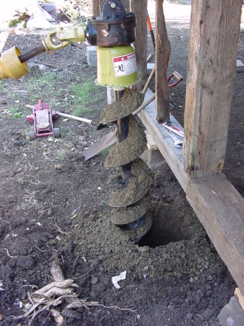

</font><font color="blue" class="small">( Went back and tried again, soil on this side was remarkably easy to drill. The fence posts I had set before were quite alot more work as I hit wet clay about a foot down and it just gummed up the bit and sent it into an out of balance frenzy. Sank it to the cover, bit is 3 1/2 Ft long. )</font>
   / Barn to workshop
#124
</font><font color="blue" class="small">( Last pic tonight, pulled the bit, soil was pretty dry all the way down. Should, and I say should make for fairly straight forword work. I guess we shall see........ )</font>

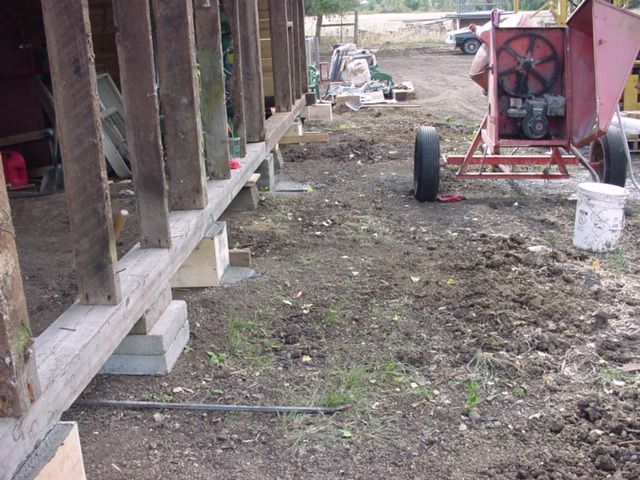

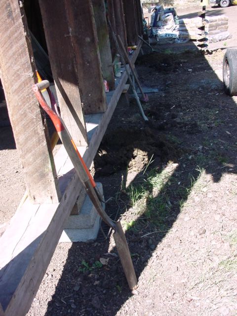

I have been busy, just not getting all the major stuff I want done,done. The test pier went well so I did the whole North wall. here is the pre forms pic.

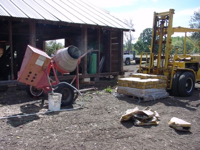

#127
I went with a premix called Sakrete, 4K PSI. 3 foot holes drilled from the outside diagonally under beam and then widened by hand to the inside, think inverted [A]. This is upside down from what Harv suggested but I do not have the auger length to go the other way, also each hole took 7 - 60lb bags or 2 mixer loads. I was mixing 4 bags per load in the mixer, not sure if that was a full 1/3 yard but that was all I could handle by myself dumping to a 5 gal bucket. I used 36 bags total for the North wall or 9 mixer loads which theoretically is 3 yards of concrete all by my lonesome /forums/images/graemlins/shocked.gif needless to say I was beat by the end of the day. When I did the math on the mixer loads I was a little put out because it sure felt like I did about 20 loads. /forums/images/graemlins/tongue.gif

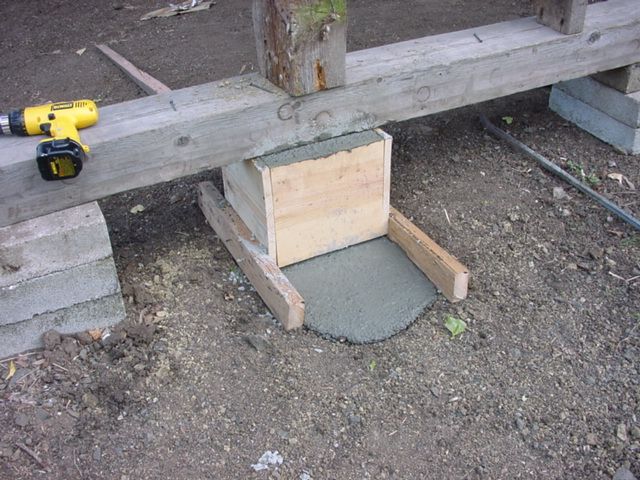

Here is a shot after all 5 piers were poured. What look like puddles coming out to the right is the initial hole angled under the beam.

Close up of the NE corner, I will pull the forms tomorrow and post some more pics.
   / Barn to workshop #130
</font><font color="blue" class="small">( I was mixing 4 bags per load in the mixer, not sure if that was a full 1/3 yard but that was all I could handle by myself dumping to a 5 gal bucket. I used 36 bags total for the North wall or 9 mixer loads which theoretically is 3 yards of concrete all by my lonesome needless to say I was beat by the end of the day. When I did the math on the mixer loads I was a little put out because it sure felt like I did about 20 loads. )</font>
I can feel your pain. /forums/images/graemlins/blush.gif
But if those bags are eighty pounders as they appear to me each bag makes six tenths of a cubic foot of concrete. That means your net concrete is twenty one and a half cubic feet mixed and poured. There are twenty seven cubic feet to a yard.
Dispensing it in a five gallon bucket will wear one slick. Even if one has the world's greatest front loader there are times when a good wheelbarrow is the only appropriate tool. I would highly recommend one in your circumstances.
Fencemen mix their concrete on small jobs in the wheelbarrow. They layer their material in. Five shovel fulls of sand and gravel, one shovel full of portland cement. Then the material is mixed with a shovel as required.
On some jobs we use sacrete. Six eighty pound bags to a six cubic foot wheelbarrow (it's heaping dry but less than full wet). There are forty five bags to a pallet. I'm old now. But in my prime I've put two pallets through a wheelbarrow in a day by myself. That's mixed wet concrete mixed with a shovel in a wheelbarrow.
Mixing concrete in a wheelbarrow with a shovel is fifty percent effort and seventy percent skill if you're doing it right. If you're not accustomed to doing it the ratio is hundred and ten percent effort, ten percent skill. It's one of those things where a pro makes it look so very easy. I learned from the best, my father.
