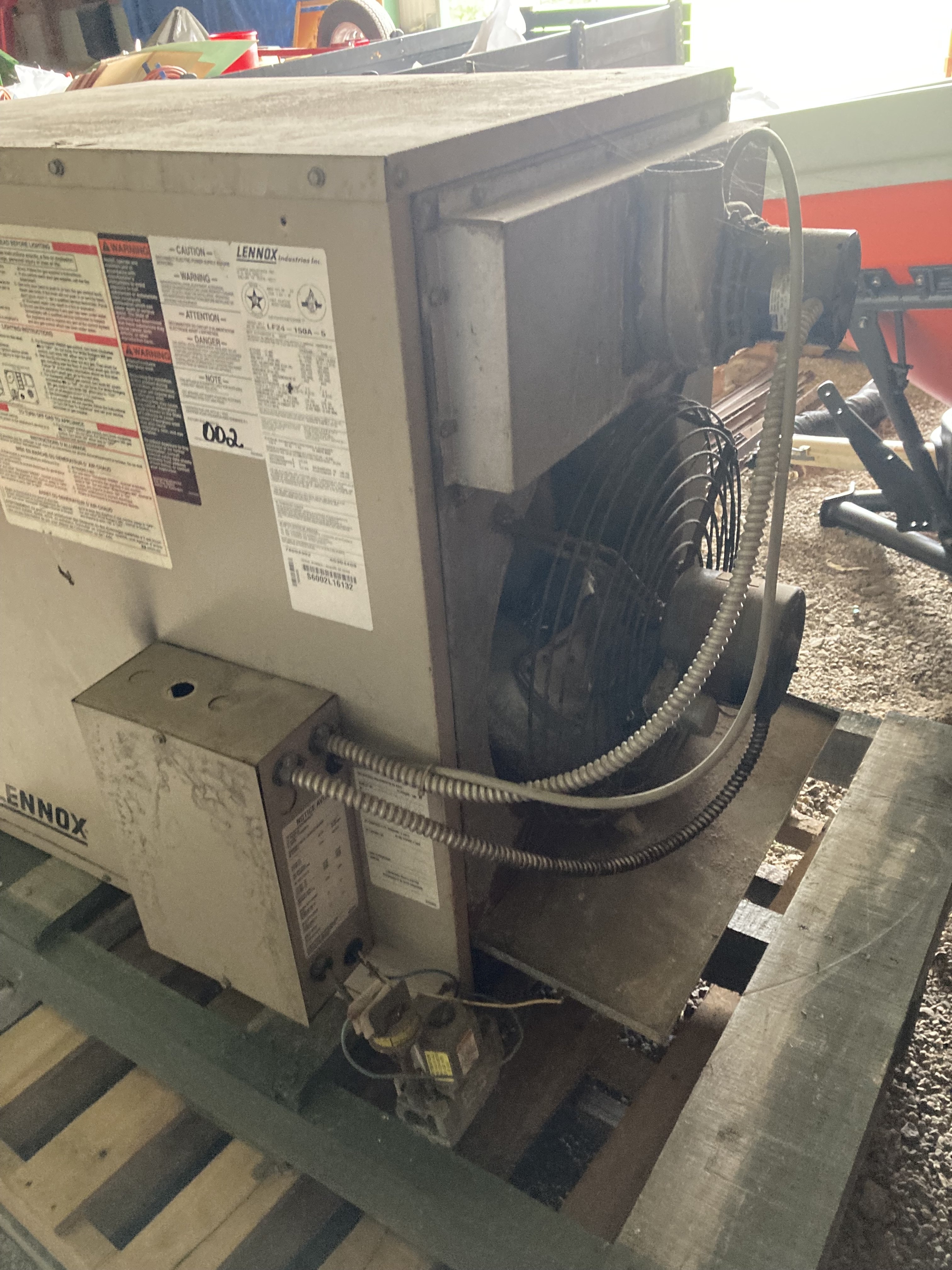

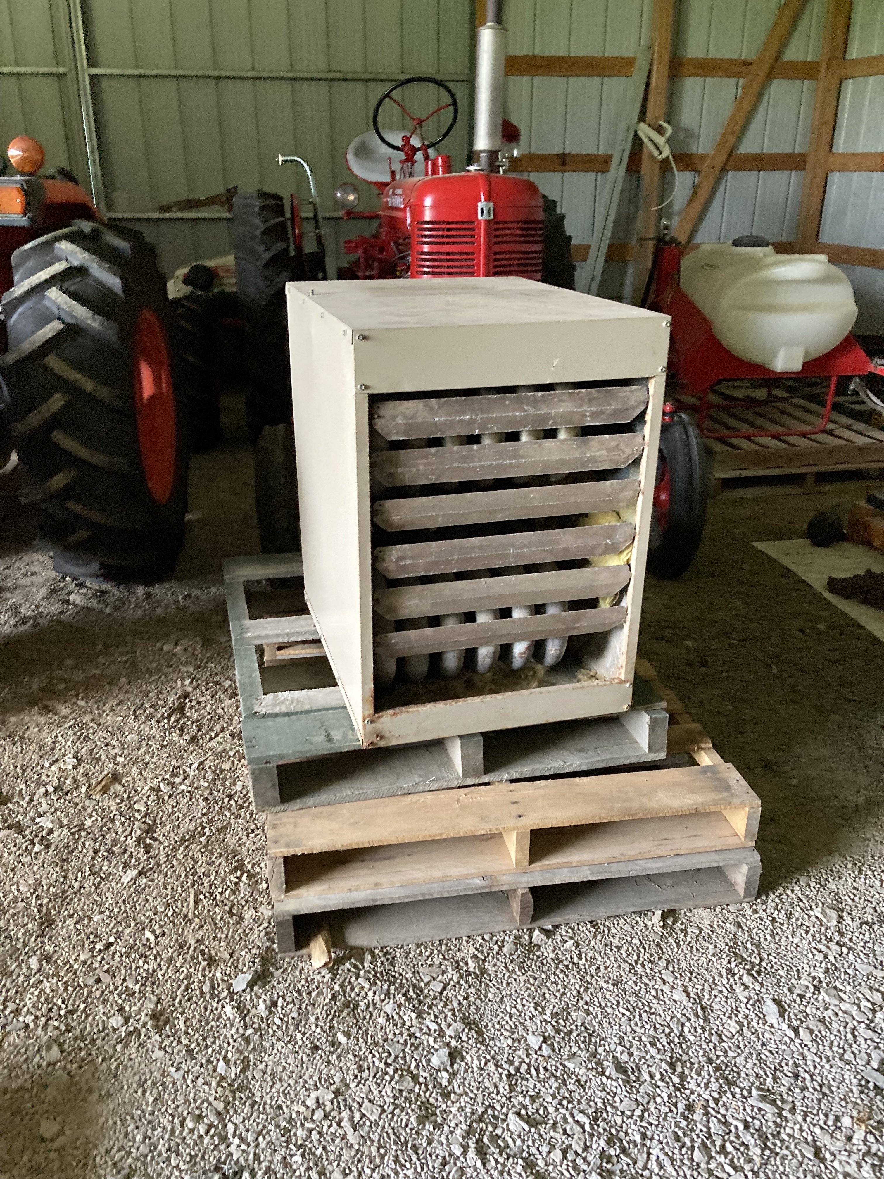

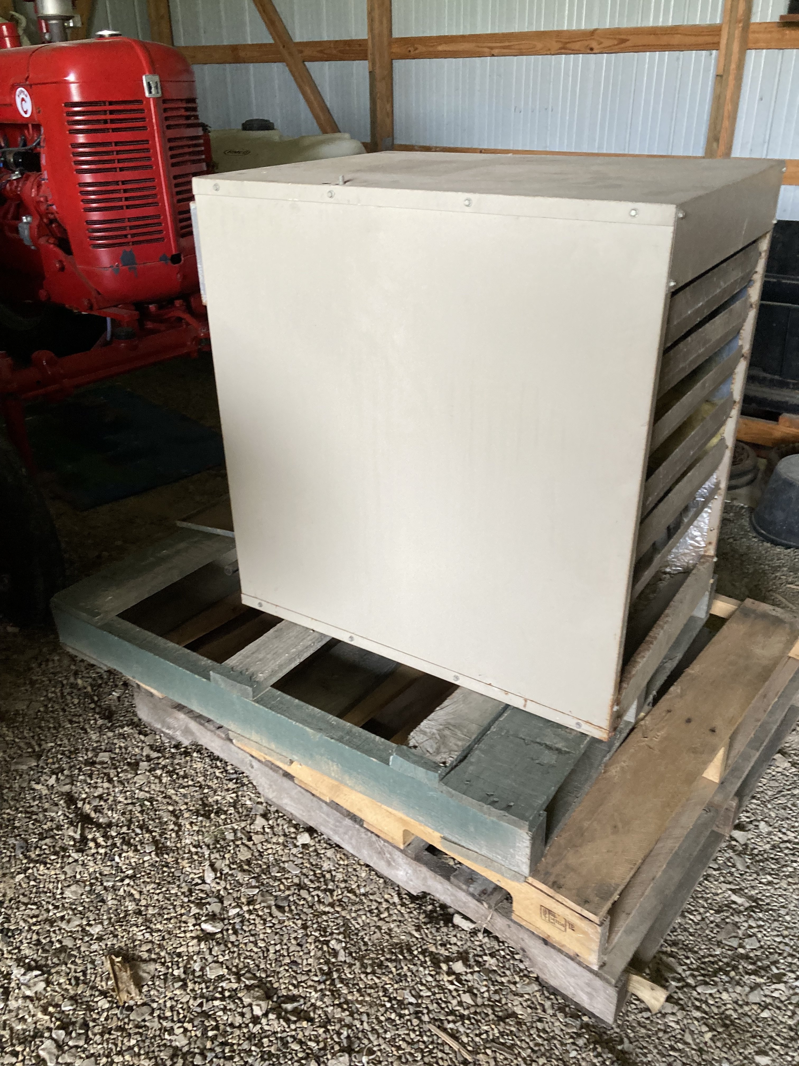

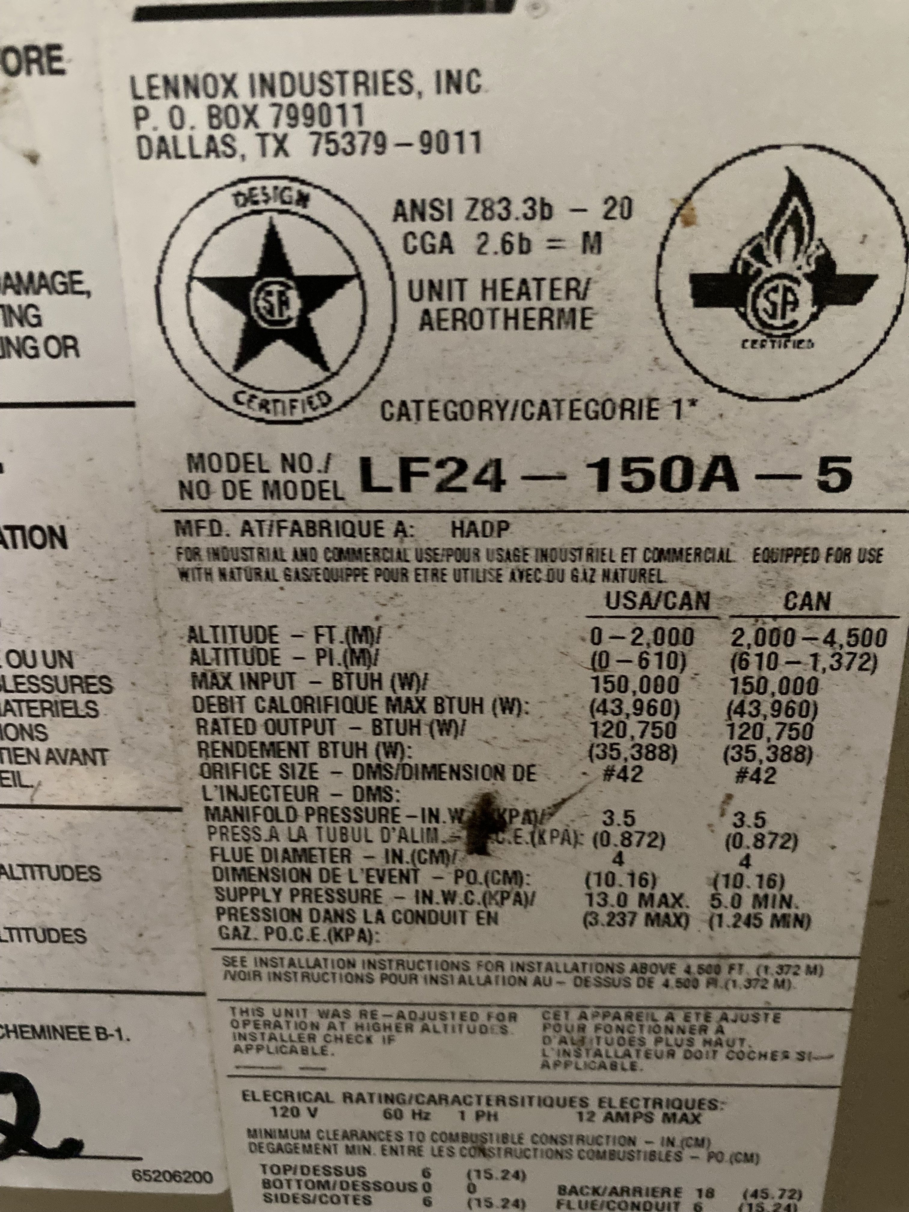

If it matters, this is the heater I planned to use until I learned it was top vent only. That means I would have to cut a hole in my roof and I'm not doing that. It cannot be converted to side vent on this model.
