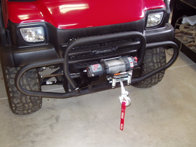

Yes, you can put a tow hook on the front.:thumbsup: Warn RT40!

Something that I've been wondering since pulling my lawn mower out of the mud with it, is mounting a tow hook to the front. Has anybody done anything like this? I figure that when I buy a tow hitch for the back, I'll be fine there, but I'd like something on the front in case I need to pull it for whatever reason.
Any thoughts or suggestions? There is a place for a winch, and I think that would be a good place to mount something.

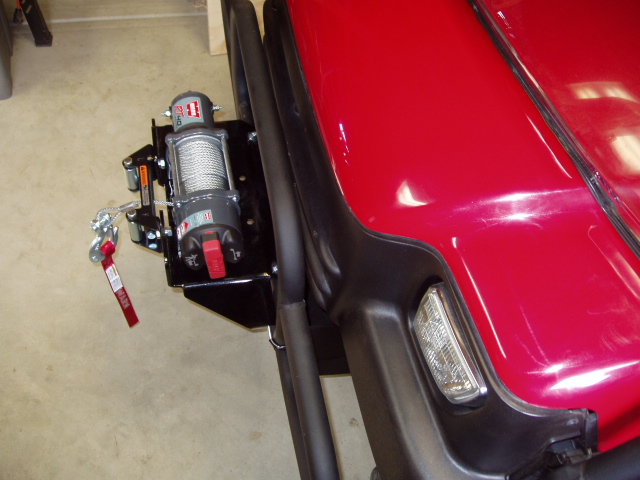

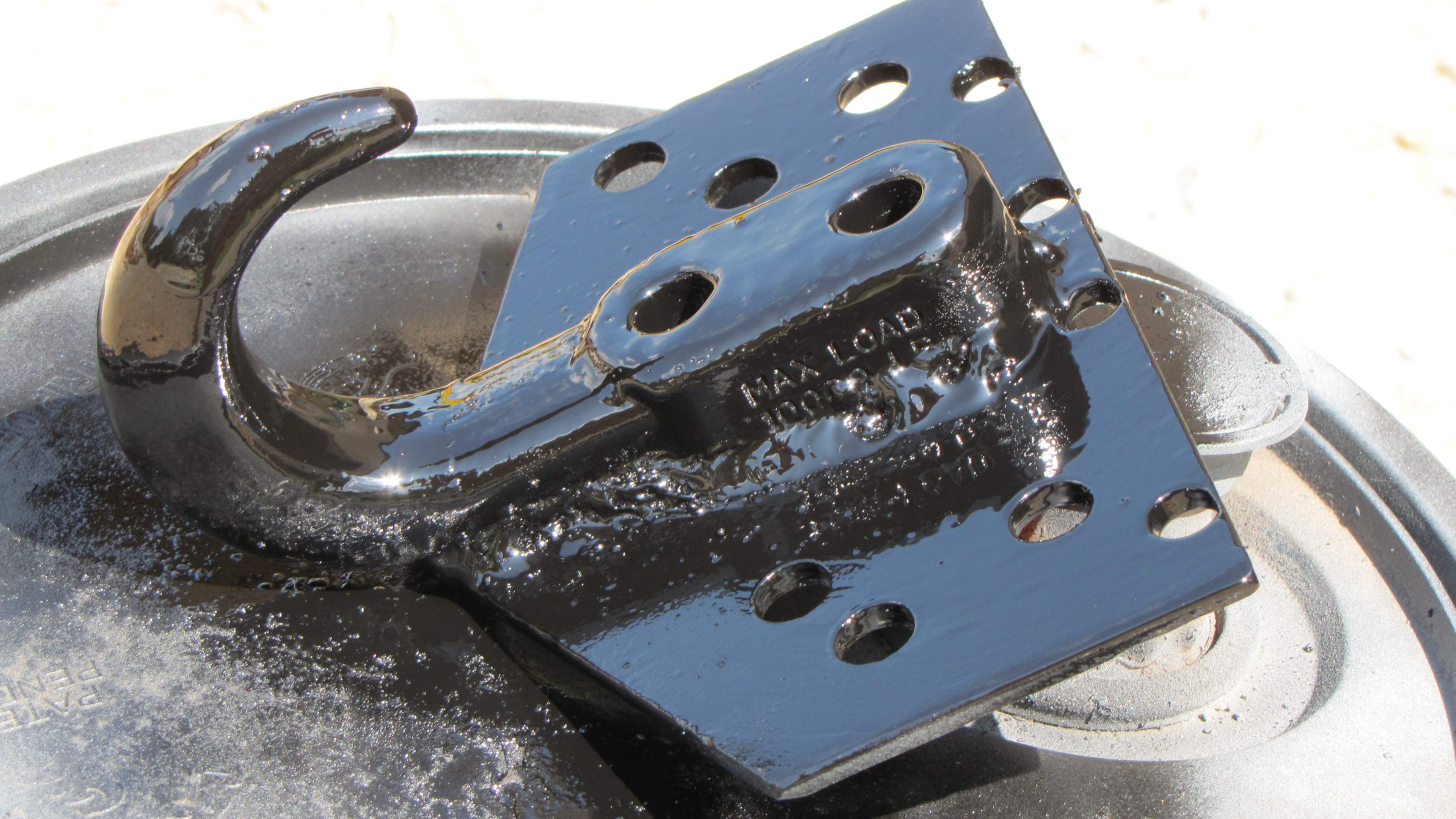

All my stuff that I ordered came in this week, so it's been a weekend of installing and fabrication on the Mule.
I have already bought the tow hitch. It's the tiny one that I think is an inch and a half. While looking at 2 inch balls to put onto it, I realized that the hole for the hitch was smaller then most of the balls. There was only one 2 inch ball that would fit, and it was almost twice as much as the cheap ones. Oh well.
For the front end, I bought a tow hook from Norther Tool. I cust a piece of scrap metal to fit where the winch would mount, and drilled some holes for bolts. Since I'm not very accurate with my hole drilling, I used a half inch bit for 3/8's holes and it worked out perfectly. Six grade five bolts holds it in place.
Eddie

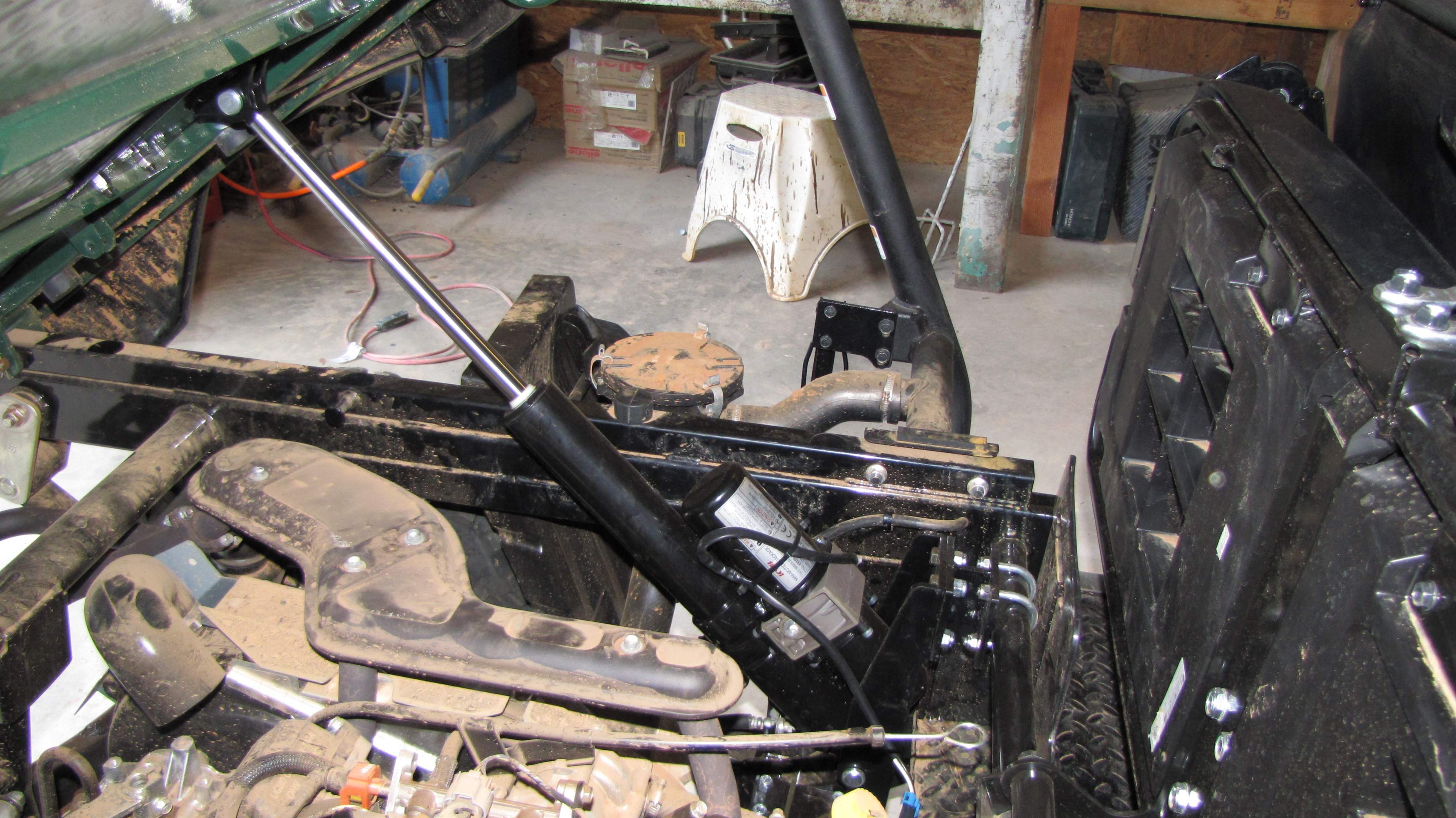

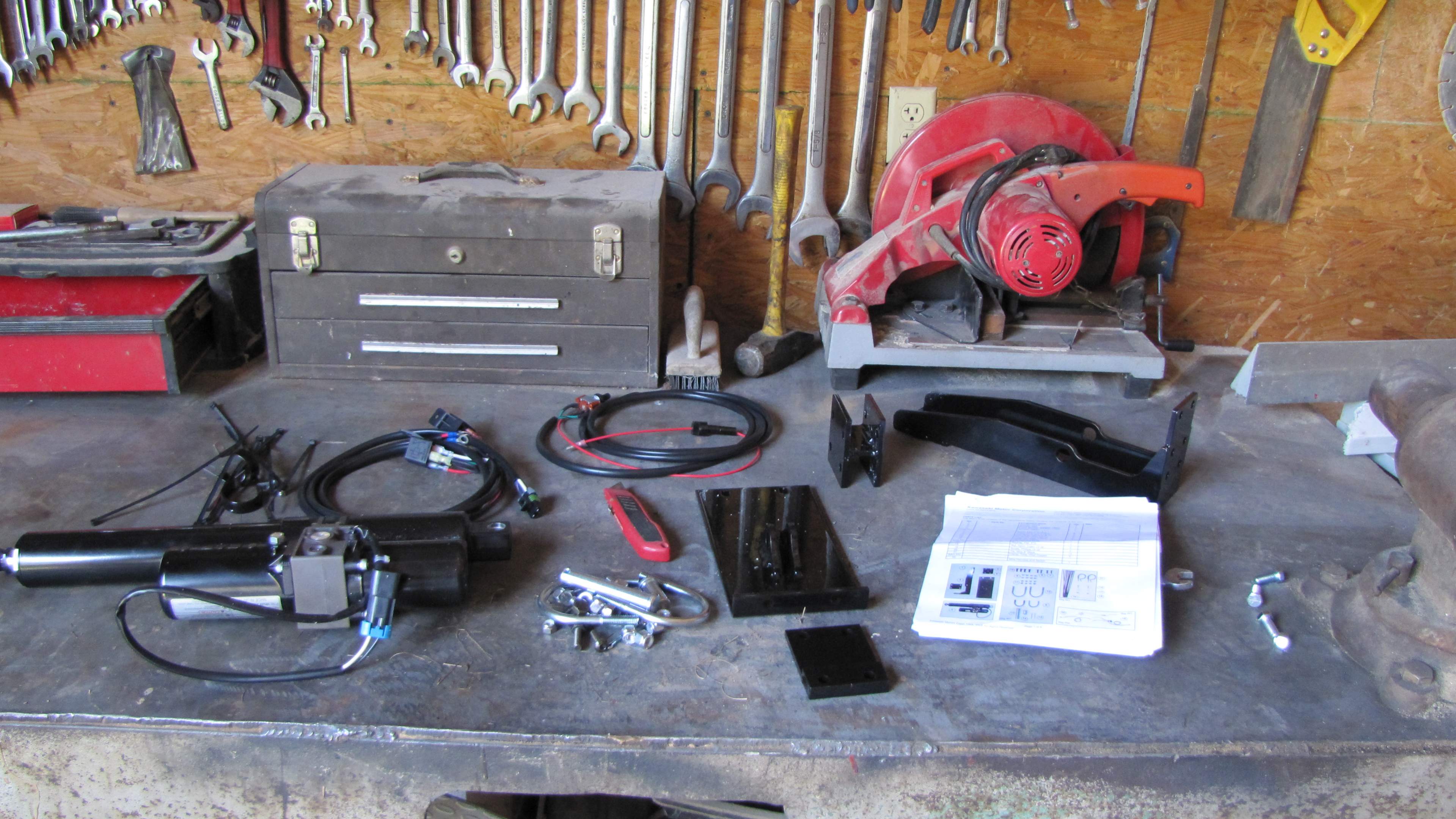

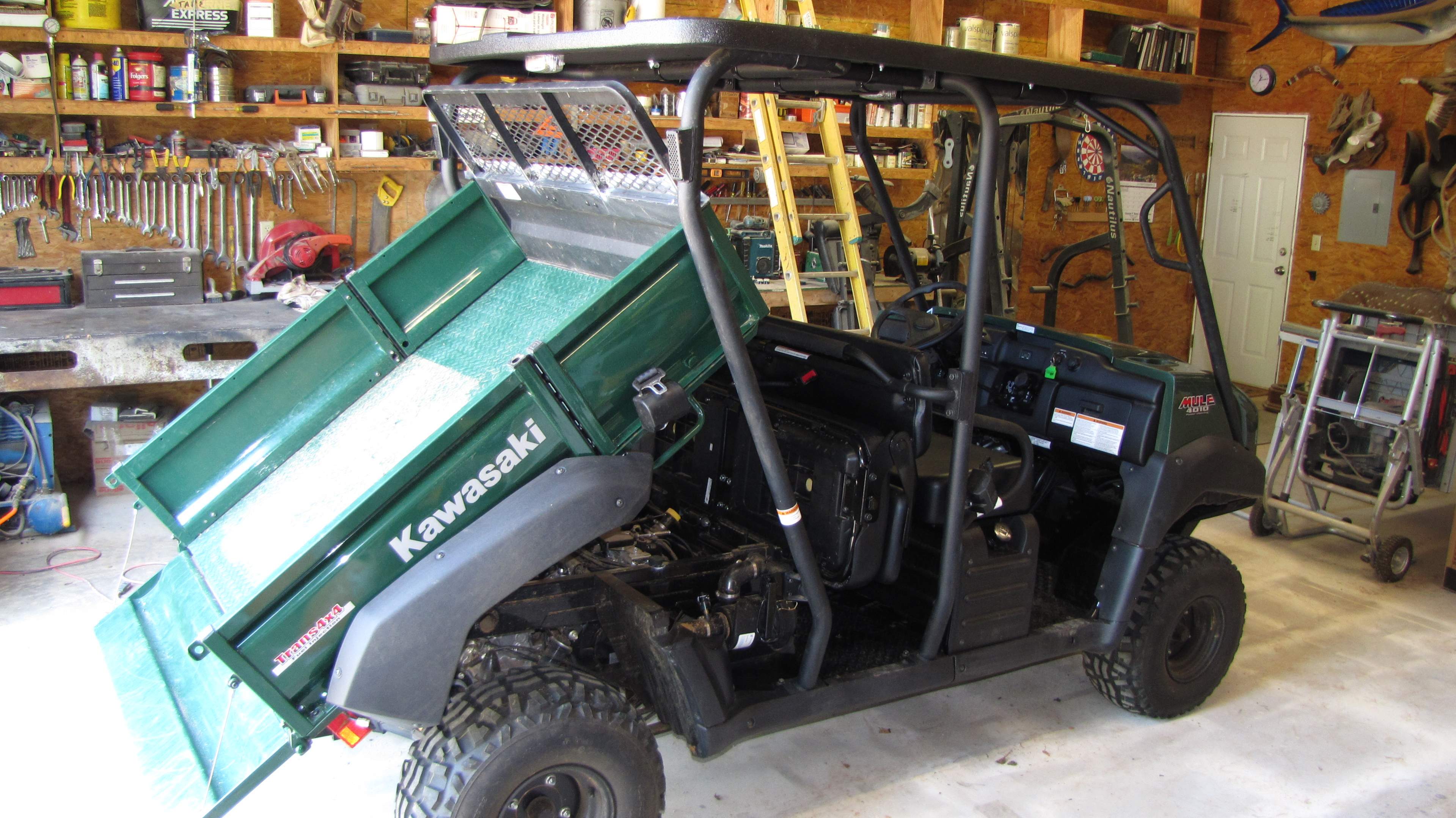

I wasn't sure about a lift for the bed and honestly thought they were something that might be nice, but really of no use. It didn't take long to realize how wrong I was, and how easy it was to load up the bed so it was too heavy to lift by hand. Unloading it by hand turned out to be twice the work. I found the same hydraulic lift that Kawasaki sells for $820 on ebay with shipping included. That's the best deal that I could find, and after playing around on ways to build one myself, I relized that this was a very good price.
It was here in about a week and a half after paying for it. The box was well packaged and in good shape. The instructions were fairly straight forward with pictures that confused me. In some of them, I just couldn't figure out what I was looking at. This confusion really added to how long it took me to get this done. All the parts looked to be in excellent shape. The lift is made by KYB out of Japan.
The instructions had me start with the electrical stuff under the seat. From there I went under the dash and then back to the engine compartment. Last thing was to install the lift itself. For whatever reason, I couldn't figure it out. I sat there for an hour trying to figure out the pictures and where it went. I don't know if I hit a mental block, if I'm just slow, or if it was too hard for me. But after awhile, I figured it out and it fit perfectly. In hindsite, it makes perfect sense because that's the only place with space for it to fit.
It didn't work.
I forgot to connect the hot wire. OOOPS. Then it didn't work again. I had unhooked the wire to the cylinder. It still didn't work, but it was now making noise. I tested the switch. It made noice in one direction, but nothing in the other. I pulled the wires for the relays and switched them around. That fixed everything and it works like a charm. My intention was to see which relay was bad. I figured that the switch was fine, but only one relay was working. If I changed them from the bad one to the good one, I was hoping to get the cylinder to move. What happend is a mystery to me, but I'm not going to spend any time trying to undersand it. It works and I'm happy.
The switch is on the dash, right under the viewing hole for the brake cylinder. Push it up and the bed goes up, push it down, and the bed goes down. I love it when things are that simple!!!!!!!!
Eddie

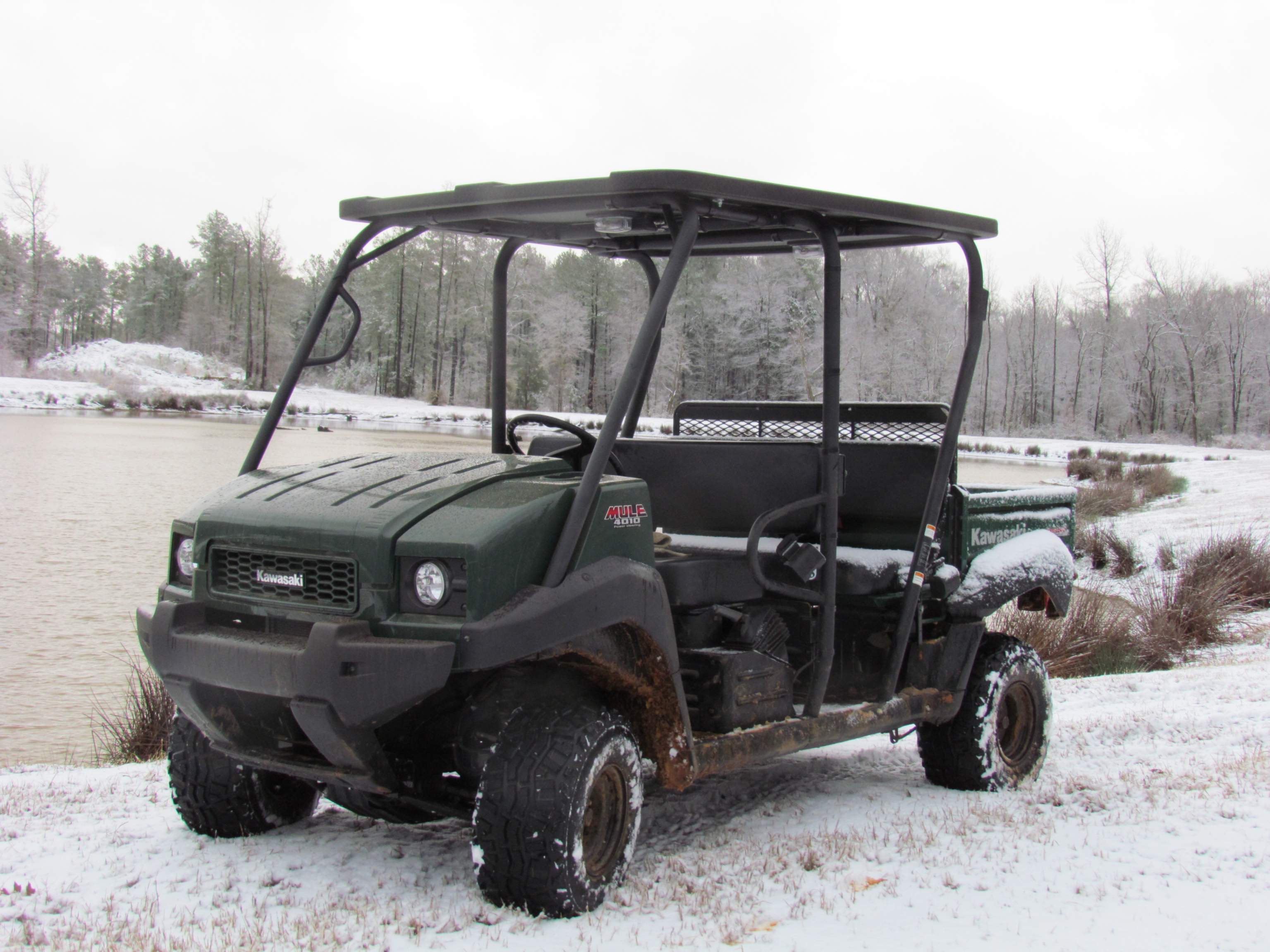

Next was the top. Kawasaki didn't have them in stock when I bought it and told me it would be $65 to install it. They only sold two types of tops. With or without the stereo. I went for the cheaper version, which was still rediculous, but from what I could tell on the smaller Mules in stock, a nice top and maybe worth it.
I declined having them do it because I'm not very smart and figured I could install a top easy enough. How hard could it be? hahaha
Fist mistake was putting in on backwards, but that was easy enough to change. It didn't come with any instructions because it's so easy to do, who would need instructions. Heck, I couldn't even figure out what end was the front end!!!!
There are 12 brackets that go around the roll cage and then a bolt comes through the roof and into the brackets. It's very simple until you try to get the nuts on the bolts. That proved to be the real challenge after about half of them were on. None were tight, just getting the nuts started was a nightmare. My dad and I spent several hours working on it, and when we were done, I spent another hour wiring it up.
For $65, I sure wouldn't do that again!!!!!!!!!!!! DUMB DUMB DUMB DUMB
Eddie

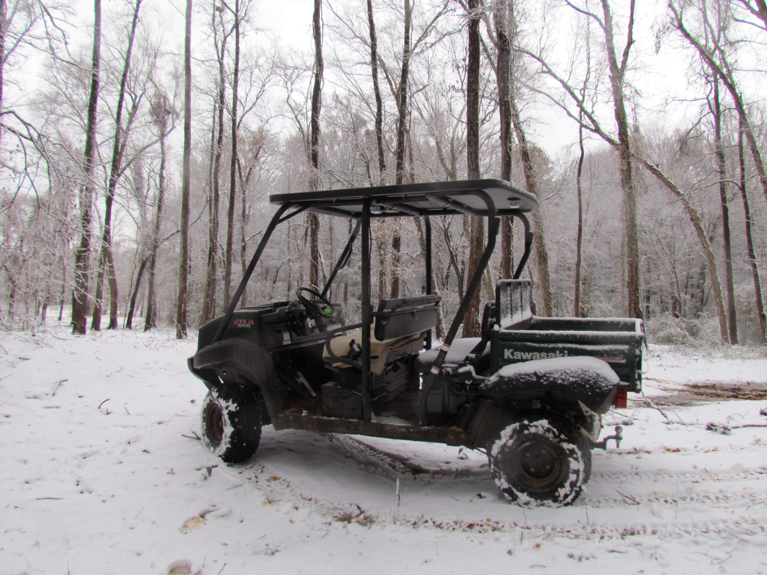

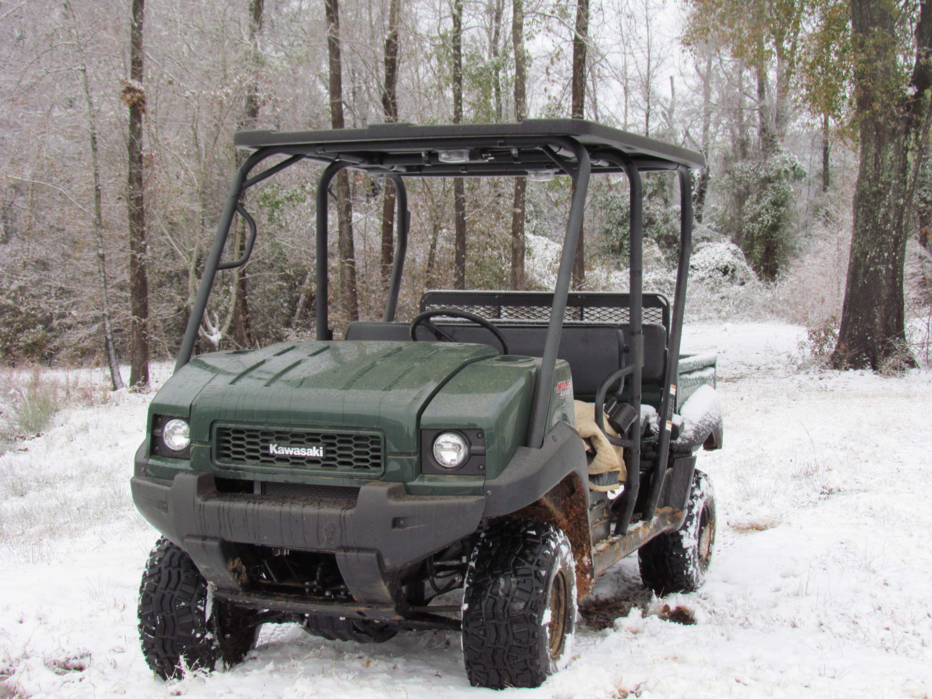

Update on the Mule. It's just been one of the best things I ever bought. From doing chores, to having fun, it never dissapoints. Being able to seat 4 adults comfortably has been a big plus, but so is being able to put so much into the large sized dump bed and to haul it around.
I'm still thinking about a windshield. There have been a few days that were pretty darn cold, but I really like not having anything in front of me, so it's stil a tossup.
One of my initial thoughts was that I didnt need or want four wheel drive. With winter, and heavy rains and snow, I realize how wrong I was in that idea. If I didn't have four wheel drive, I wouldn't be able to go anywhere. With fourwheel drive and the rear differential locked, I've been able to go anywhere, and through anything. Water has come in over the floorboard and I never slowed down. I can go slow and easy, or off road it and have fun splashing around in the mud. With snow, it just goes over the snow and keeps on going!!!!!
Eddie
