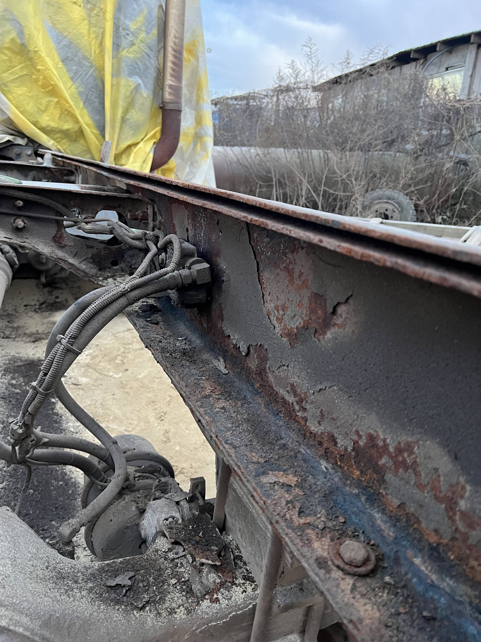

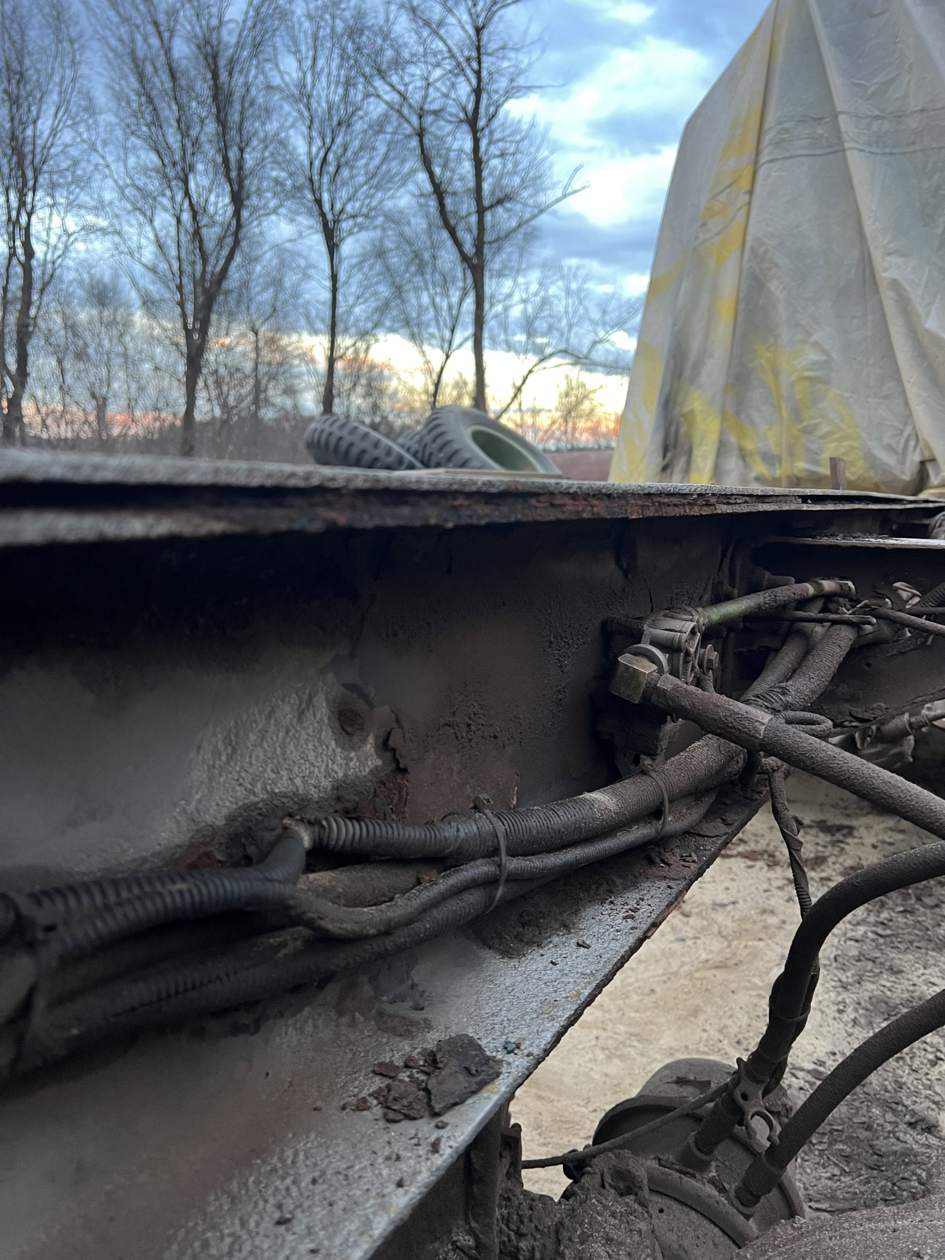

A little more “fuel for the fire”.
We started a little sandblasting the frame and stopped. The rust jacking was bothering me so I took out a sledge hammer and proceeded to beat the the frame and the rust came out.
But now I got me a gap.
I think if I left it in, the fames would separate so much they would crack.
More time and labor.
