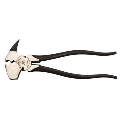

I am still kicking my own but, i had my great grandfathers fencing pliers in my coat pocket and i lost them out in a field. I have never found them. I liked them alot as the grip in the top was split it wasnt a single point.
Yeah I know what kind your talking about,I have 5 different pair, one in every truck,my UTV,my tractor and my wife has her own pair,cause mine doesnt have the rubber hand grips on them just metal,hers are pertty:laughing: For fixing fence I have always wonted to get a [ame=http://www.youtube.com/watch?v=ZgPHXvgLB98&feature=player_detailpage]Texas Fence Fixer | LivestockShed.com - YouTube[/ame]

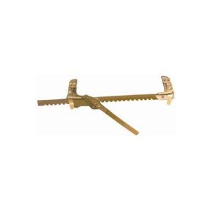

i use a normal fence stretcher, put it inline in the fence tighten it up. Cut it, and put a splice in the fence then release the stretcher. Works great until the bull jumps it, and crushes it then the splices come apart.

Do you know where to get a pair of fence pliers like the ones i described? I would seriously spend 50 to 60 bucks for a pair of them over these cheap junk ones that are 10 to 20 bucks.
/ Barbed wire fence help #28
Man,my wife and mother go to flea-markets and alot of them have the people that sell the old tools and the wife picks up everyone that she comes across,because im always needing a pair and dont have them in the vehicle were in. I have a pair everywhere you look(she keeps hers in the house:laughing:). If we come across one I will sure send one your way...
/ Barbed wire fence help #29
thanks man, ya i was so mad at my self for loosing my pair. Its sad when a +100 year fencing pliers work better then new ones. The new ones i dont like either is most of the time you cant hardly operate them with one hand they are to tight.
/ Barbed wire fence help #30
fence pliers.jpg Cooper tools apex Heavy-Duty Fence Tool Pliers - 193610VN - SEPTLS181193610VN
I have two pair this brand,how I found them,lol.Wish it had top view but looks like'em
http://www.ebay.com/itm/Vintage-Cre...989?pt=LH_DefaultDomain_0&hash=item2a19fadb5d
http://www.ebay.com/itm/Vintage-Cre...067?pt=LH_DefaultDomain_0&hash=item35b9e17c4b I know for sure these are the ones your talking about...

those look exactly like the pair i lost. Those have the split nose on the top?

thats them, thank you very much. I will have to watch them and see what they go for. That split nose works so much better.

nah man, i will get a pair you keep those. I thank you for helping me find a pair i had looked before, i might look at some of the new higher priced ones and see if they are split like these old ones are.
I know that different top makes wire clips work alot better as well.
