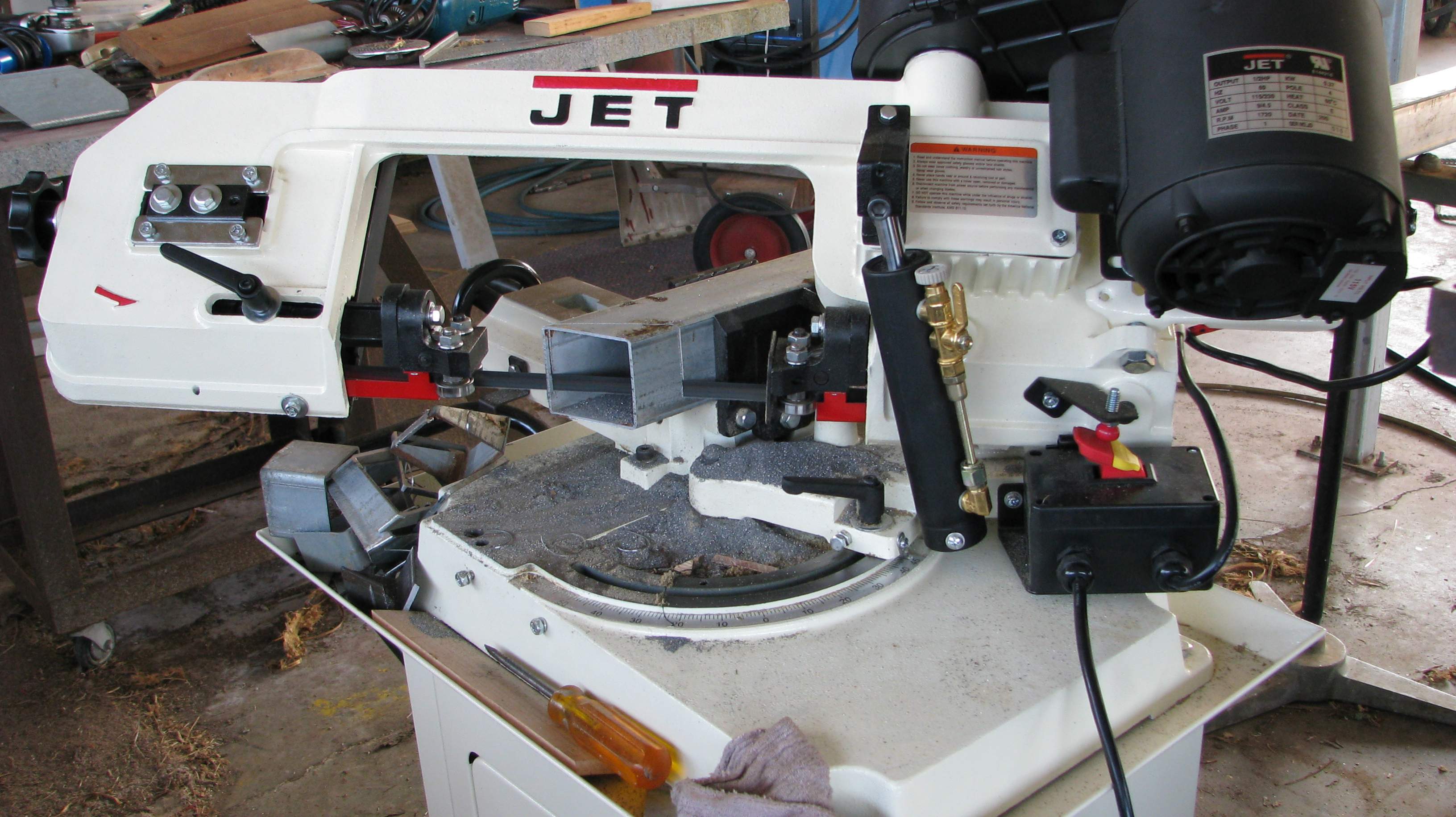

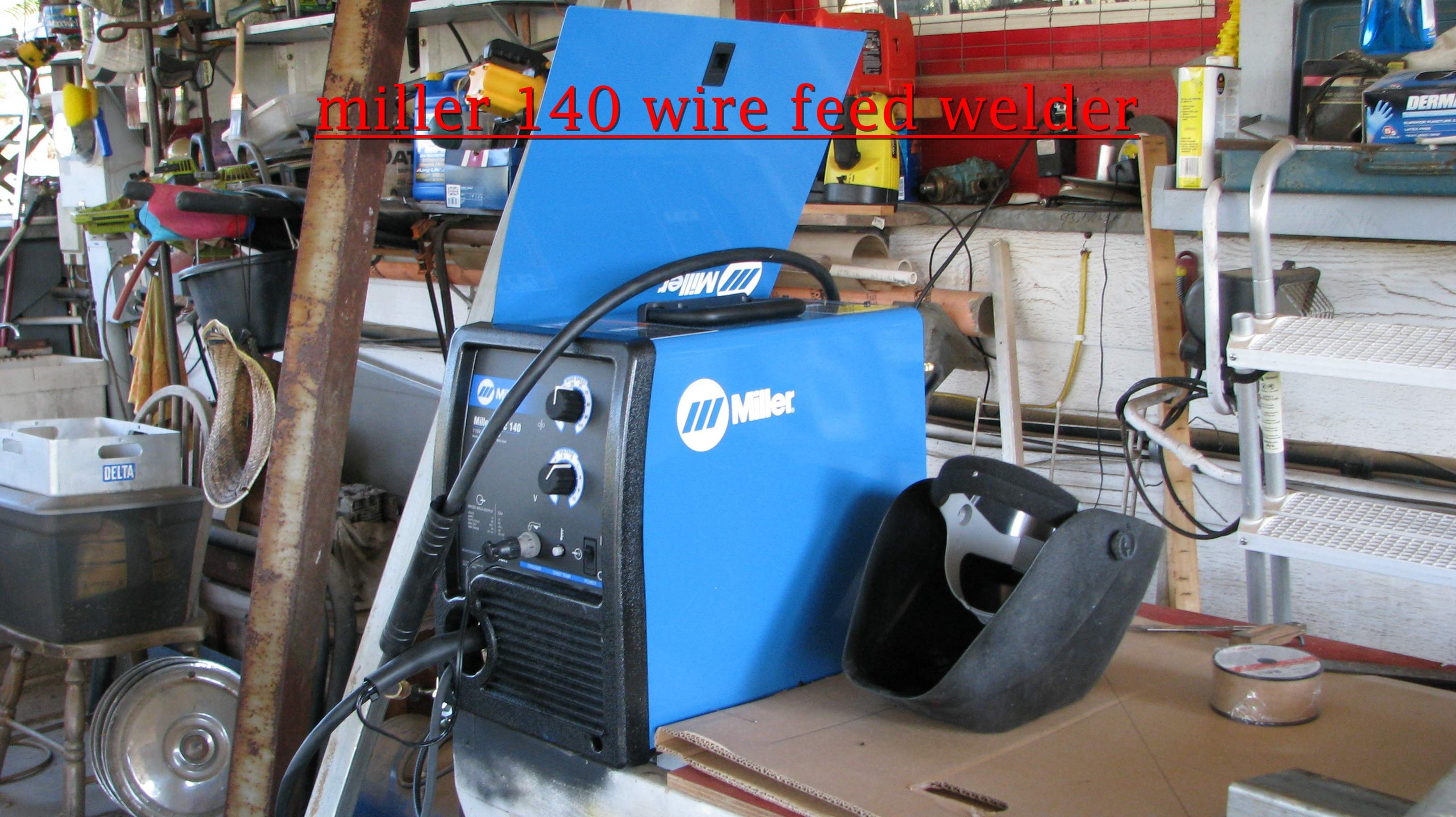

I have a Jet band saw it was like 5 or 600 as I rember it was part of a program the VA had it came with a wire feed welder.

That Jet saw is the same as my Grizzly. It just has a nicer stand and a few other niceties the Grizzly doesn't have.

Same here, the only difference I can see is the drip tray, and the storage door in the stand. By the way here is what I do to clean up the chips or metal saw dust. I put a small yet powerful magnet inside a small ziplock bag then put that bag inside of a larger ziplock bag, that is big enough to get your whole hand into. and and then put the bags in the path of the chips under the blade. All the chips are attracted to the bag. When you get enough, take the whole mess over to a trash can, and reach in and pull out the inside bag containing the magnet while holding the outside bag, and all the chips fall into the can neatly.

When I saw Jet in person, I noticed the hand-wheels were metal, and that there were miter stops for the common cutting angles.
Maybe newer Grizzly's have those now too as I bought mine shortly after Grizzly started offering them before anyone else did.
Regardless, it's a good little saw with mitering capabilities at an affordable price.
