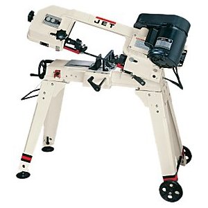

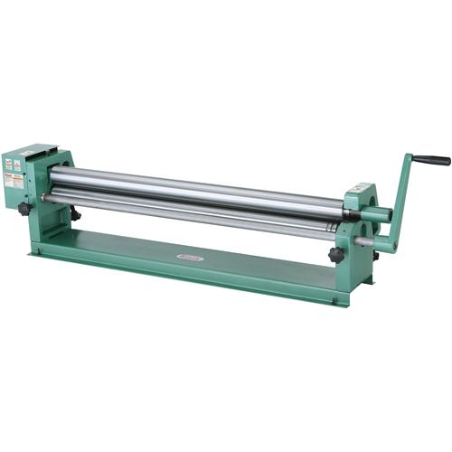

I have a large metal roller and box brake from grizzley. there well made and weigh a ton. They dont scrimp on the steel. Have had them for several years. No issues.
As for my bandsaw, i have a basic cheap JET brand non lube bandsaw. Have had it for about 8-9 years. again, no issue and i only paid in the $275-300 range at the time.
That is true. Metal is cheap in China...they get all out scrap....:D
I've seen some really funky gears and mechanisms come from there however. I have an issue with Grizzly as far as anything with maching involved. I've seen their gears and trunions in their table saws. Powdered metal and pot castings don't get it.
I still prefer my Pexto box and pan brake and my Dries & Krump hydraulic shear over anything imported from the land of chopsticks.

That JET saw you have is the one I refer to. It's a generic (everyone rebadges them) and sells them. My TSC saw is the same, but grey. Grizzly is green. Good basic saw with some modifications.

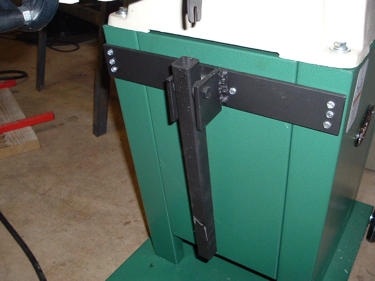

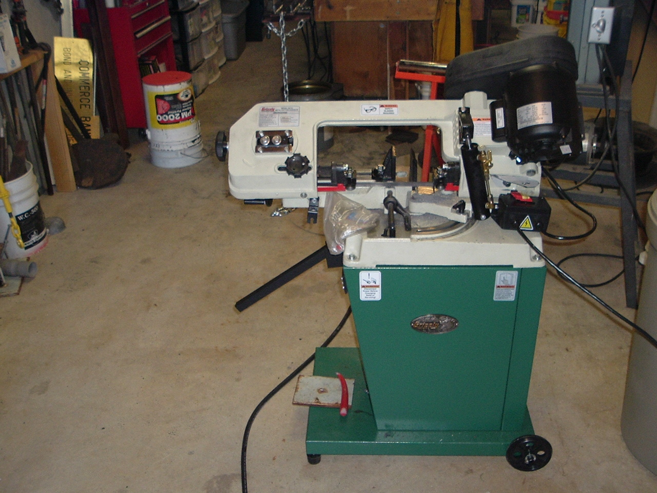

I have this Grizzly:
G9742 5" x 6" Metal-Cutting Bandsaw w/ Swivel Head
It works very well, and I really like the swivel head feature. but the automatic stop switch engagement bolt, I never got to work correctly. I stay with the saw anyway when it is cutting and just operate the switch manually. I also added a folding handle to the stand to make it easier to move around. Overall a good saw for the money, Any bandsaw you buy will be so much better than what you are using now, you will be in heaven.
