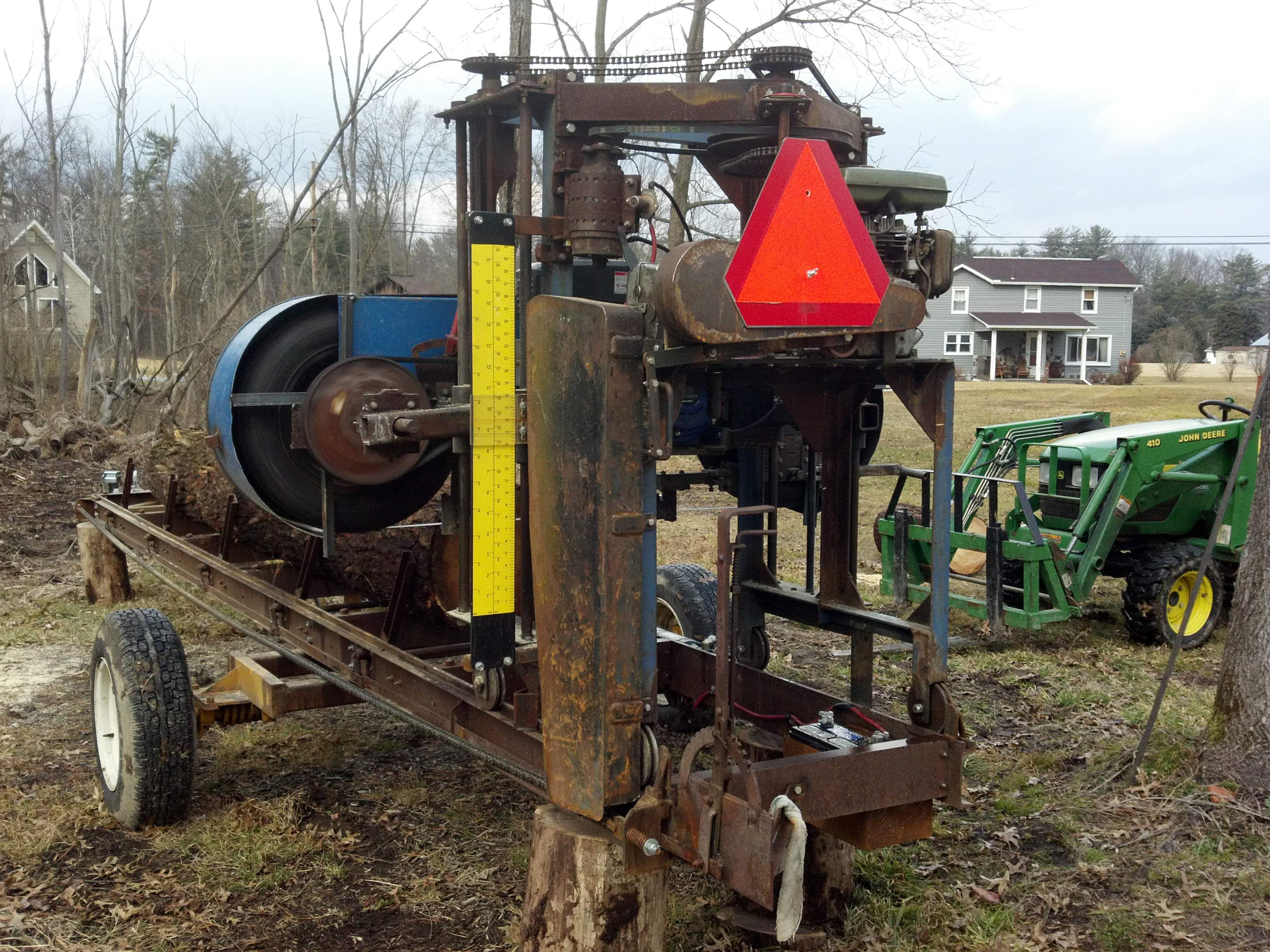

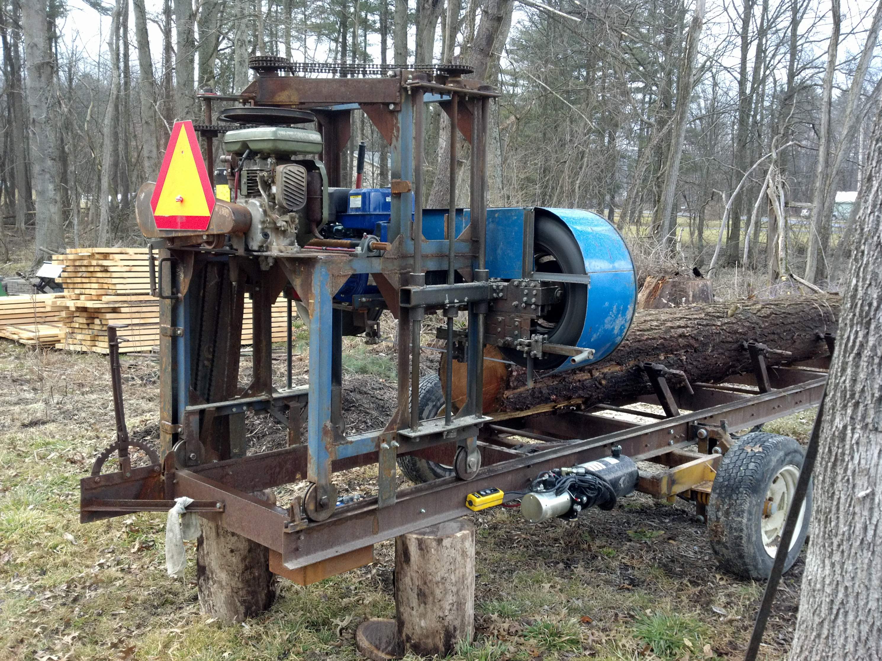

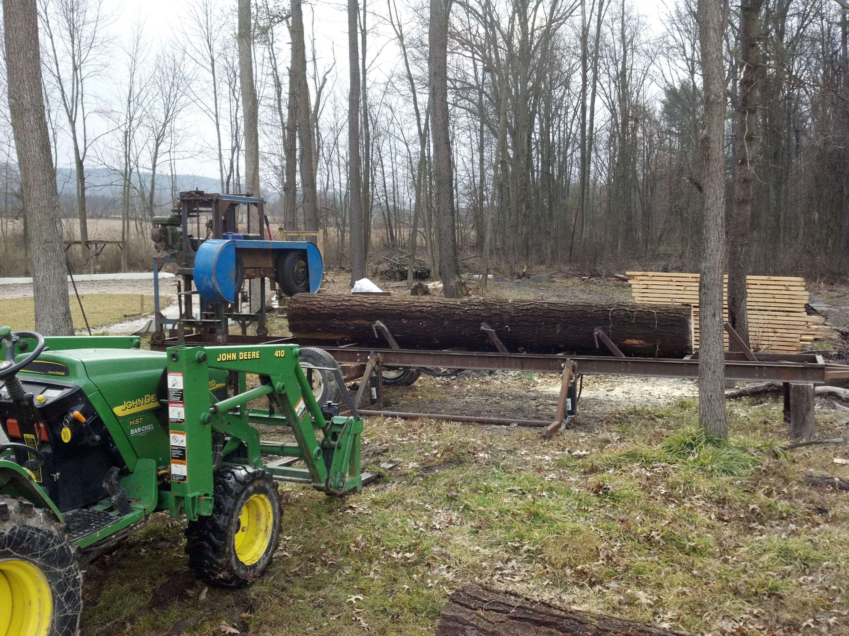

Ok, so I know this is a tractor forum and all, but I see some good input on here from people so I thought I'd post my question here. I had just bought a bandsaw mill and it looks like it was someone else's "build it yourself project" Anyhow, to anyone that knows anything about bandsaw mills was just wondering what you think its worth. It can cut up to a 24 inch diameter log at 16.5 feet long. It has a power feed and a log lift system. It also has power up but manual down for the carriage head. Everything else is manula. like turning the log and clamping it. It has a 13 horse engine on it to run the bandsaw and what must be a 3 to 5 horse to run the power feed. Anyhow, any input would be appreciated, I like it so far. I want to eventually paint it and add a few things to it. Just for the record, my tractor is in some of the pictures, so It's not totally out of line posting a bandsaw mill question on a tractor forum. haha

Bill how do you strap the log going down past 1/2 way?
Or are you done and the rest is firewood?
/ bandsaw mill questions.
Its designed that when you square it up you can clamp it down at the bottom. It will cut down to 1 inch boards.
/ bandsaw mill questions. #4
I went looking at these things yesterday and looked at a few prices. My vote would be in the 1600.00 to 2200.00 range in value. Pictures never show whats wrong w/ a unit so IRL review might knock some off this. I am NOT really qualified to place a value on it, others are, just IMO.
/ bandsaw mill questions. #5
It has most of the features (feed,hudraulic lift, etc) of a 20- 30k factory unit but i suspect functionalty and realiabilty is not quite as good. Judging by the pile of lumber in the background you are getting your money out of it, might be worth 2500$. the issue will be repairs when any part fails you may have to re-engineer the system to make a diffrent part work.

We've got a timberking 1600, the only things missing from yours are leveling jacks on the four corners and a log turner.

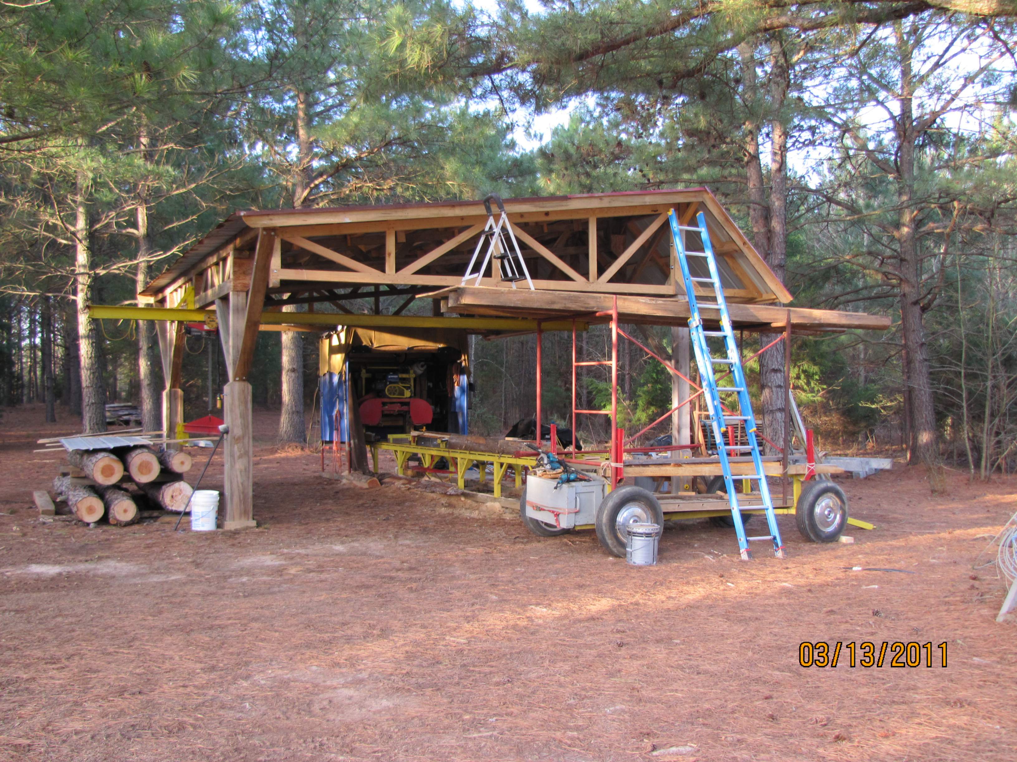

Not counting my time, but I am sure theres3,000 in my mill.I built it a few years back. I like the coment"tlbuser

I don't know how long you plan to leave those boards stacked as they are (or what you intend to use them for) but if this lumber will be processed into boards for making furniture, etc. from what I can see in the photos you need to be careful when stickering to keep the stickers one above the other so the load is transfered down through the stickers and not offset as I see on many of your boards.
If you leave them how they are (especially when first cut and still green) even for a day or two you boards will be ruined. You should think about setting up a level starting point (as measured with a 48" level) at least 12" above the ground or better yet over concrete and then sticker and stack there or you will have twists and/or waves in your boards. Cover the top and sides but leave the ends open for air flow through the stack. If stacking side by side leave a minimum of 4 inches between each stack for air flow.
Grunt; I like your hoist, nice job. Did you build the spreader bar?

Army Grunt;
that's an interesting milling shed you have there :thumbsup:
any chance of getting a few more detailed photos of how it's put together?
