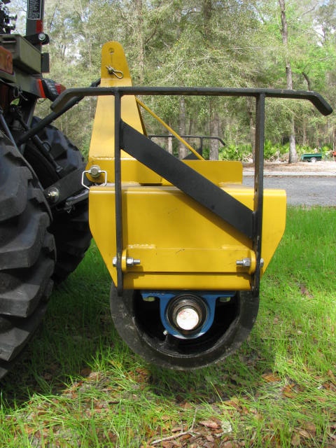

I have GL3560 with LA805 FEL. Air in R4/industrial tires. I carry a 60" / 700 pound Three Point Hitch Cultipacker as ballast most of the time. It is ample for 1,000 pound lifts. If I anticipate an unusual max lit, I mount a heavier implement.

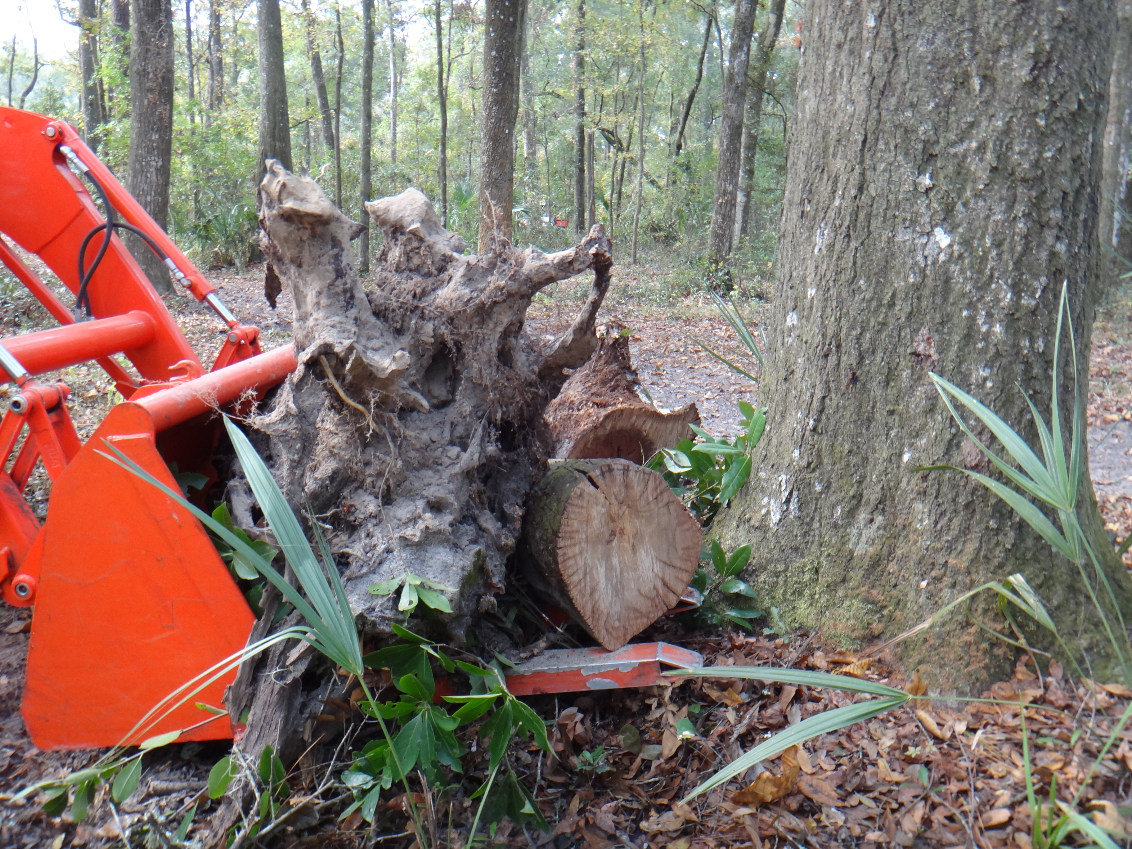

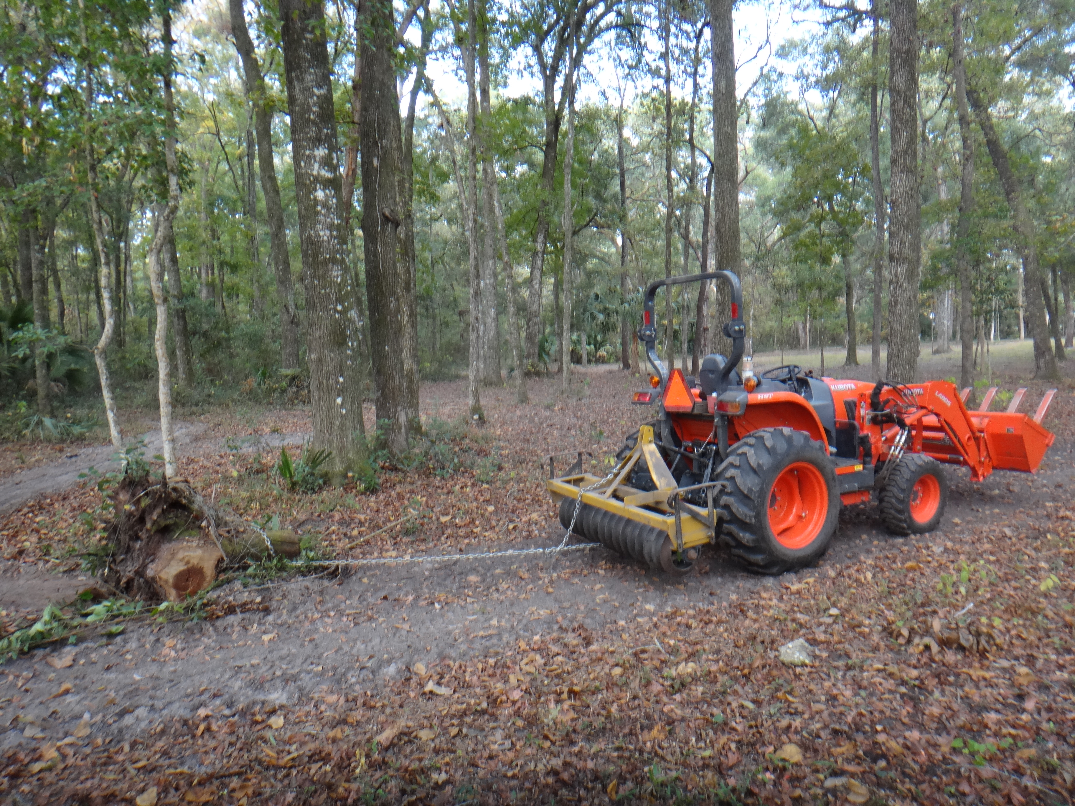

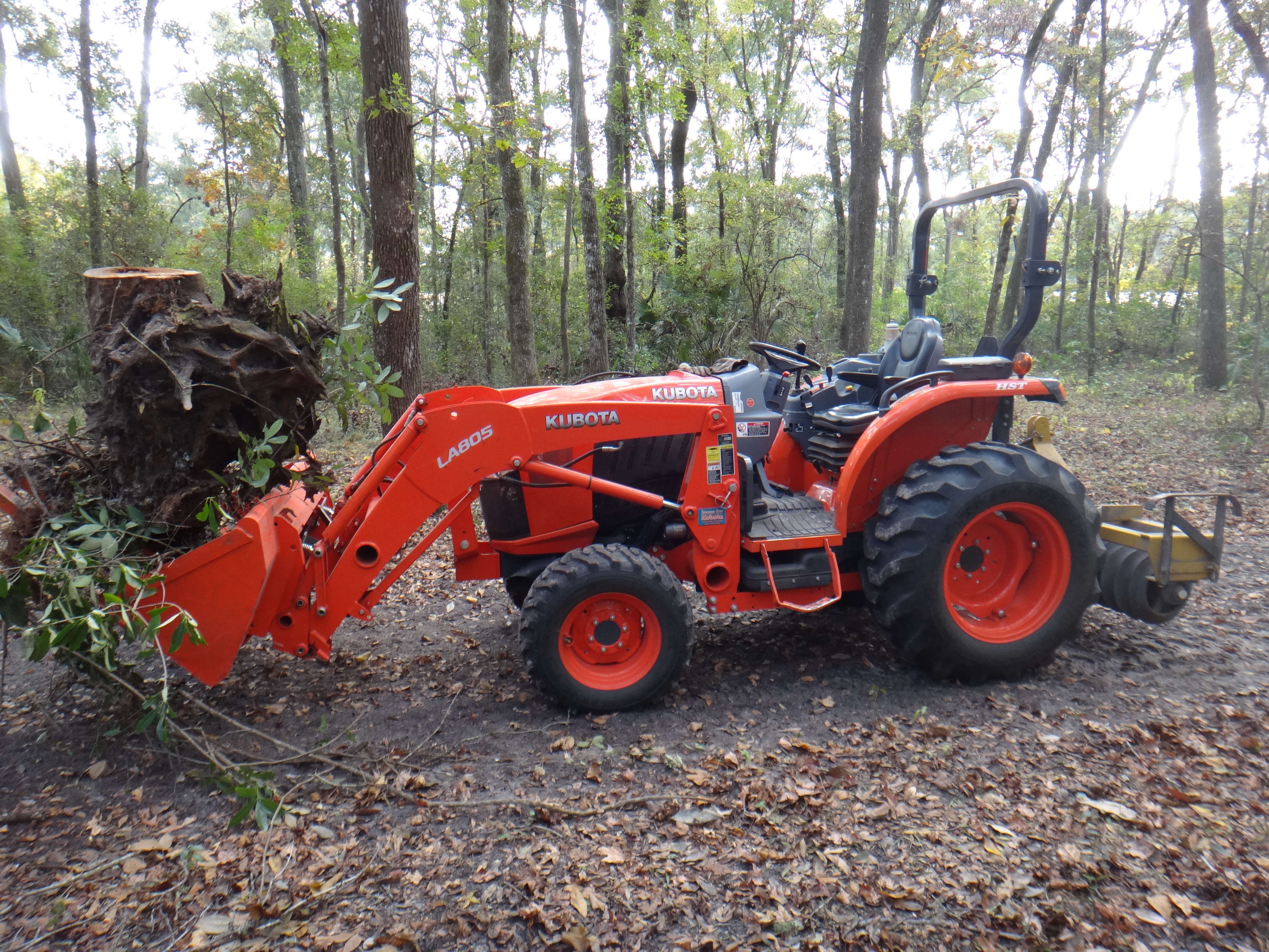

Photo #1 + Photo #2 This wood was all one stump. I could not pull it entire, partly anchored in the dirt as it was, so I cut it in to four pieces to make two loads for the Debris Forks.
I dragged the stump in Photo #1 with Grade 70, 5/16" chain. The ground was too uneven in the woods to attempt a heavy FEL lift.

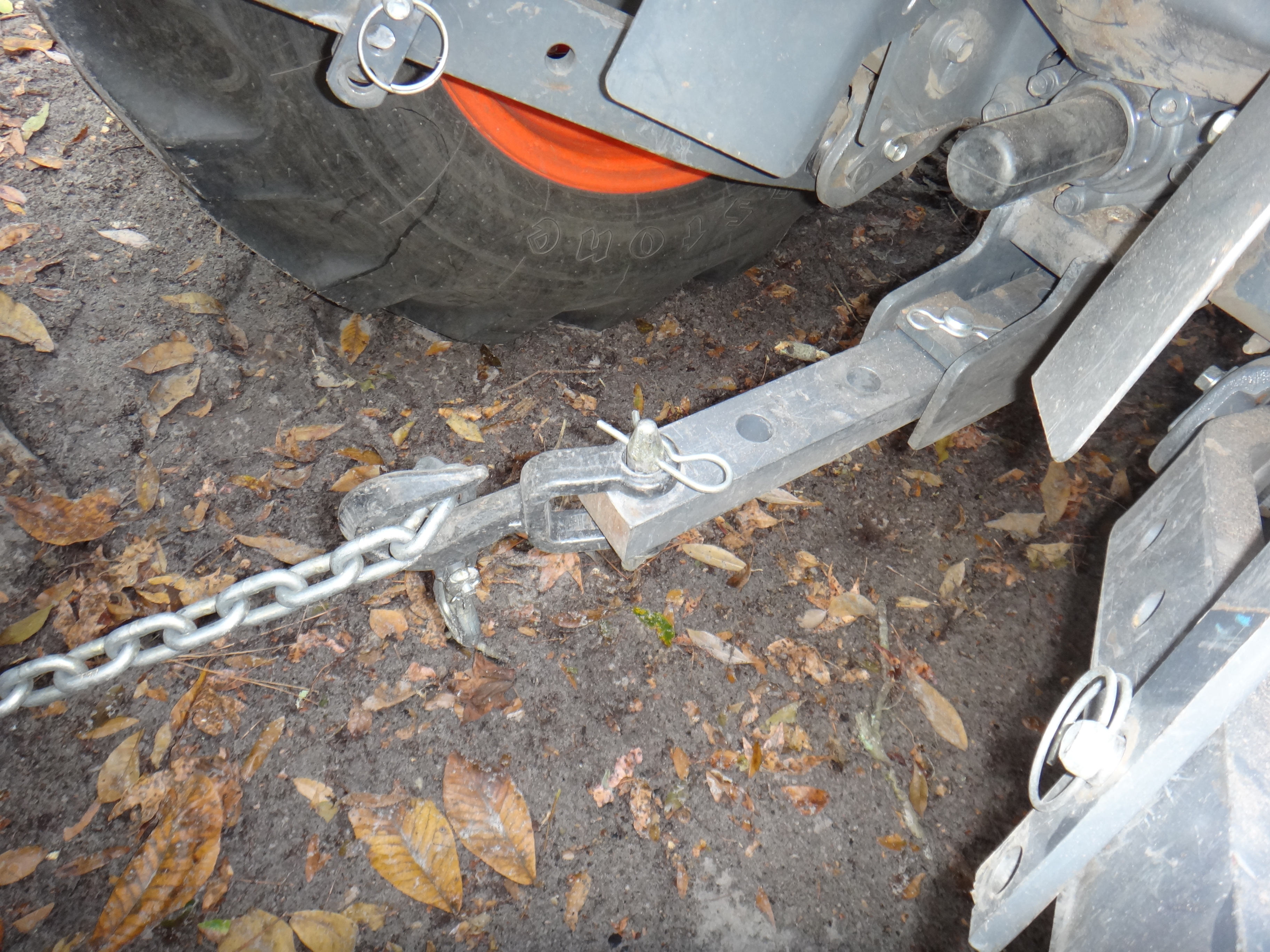

Photo #3 Chain(s) attached to tractor at rear center drawbar using TSC 1/2" clevis Grab Hook pinned on drawbar.

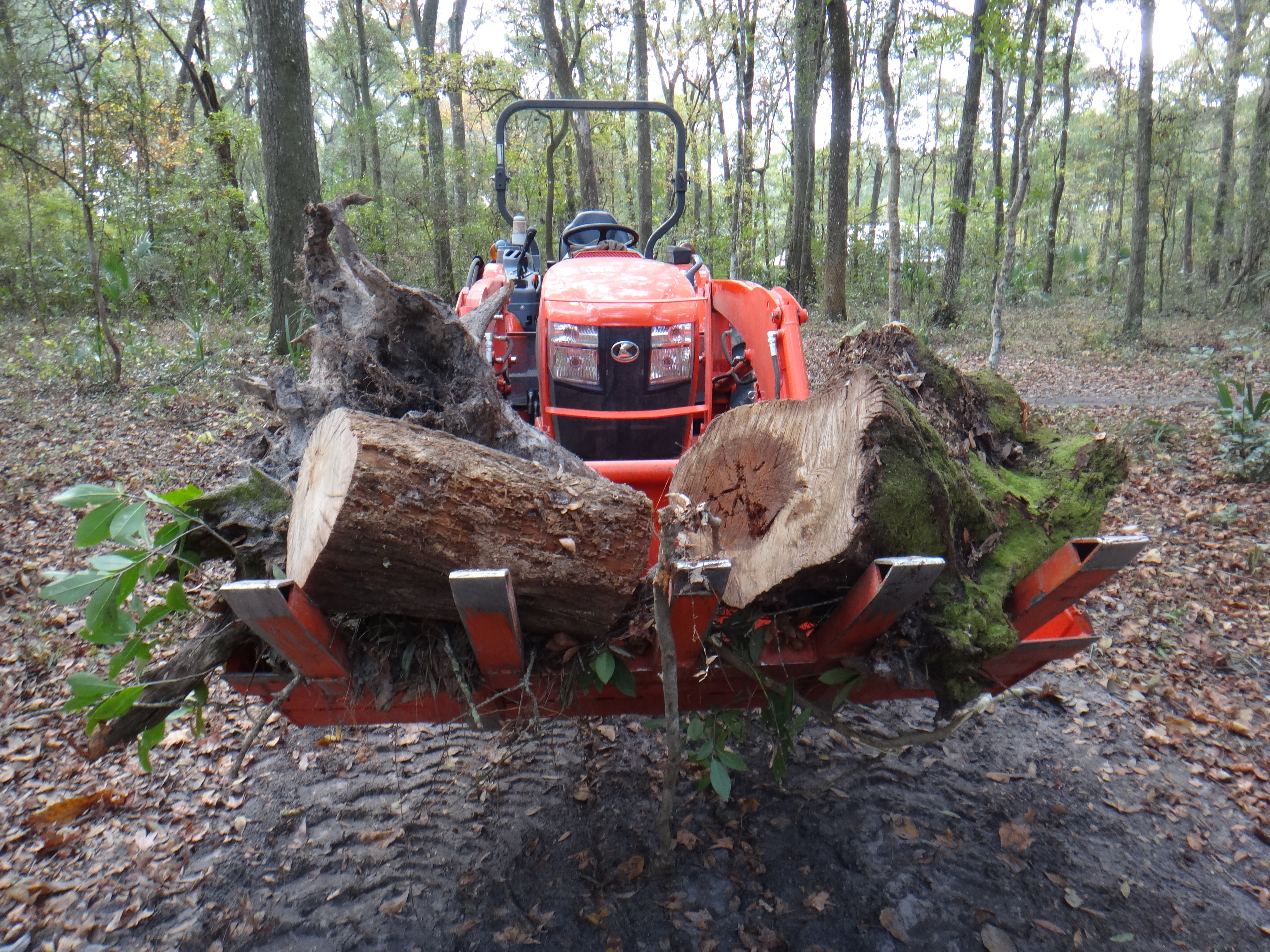

Photo #4 After dragging the stump to an accessible location I loaded it onto the Debris Fords and transported stump to the community burn pile.

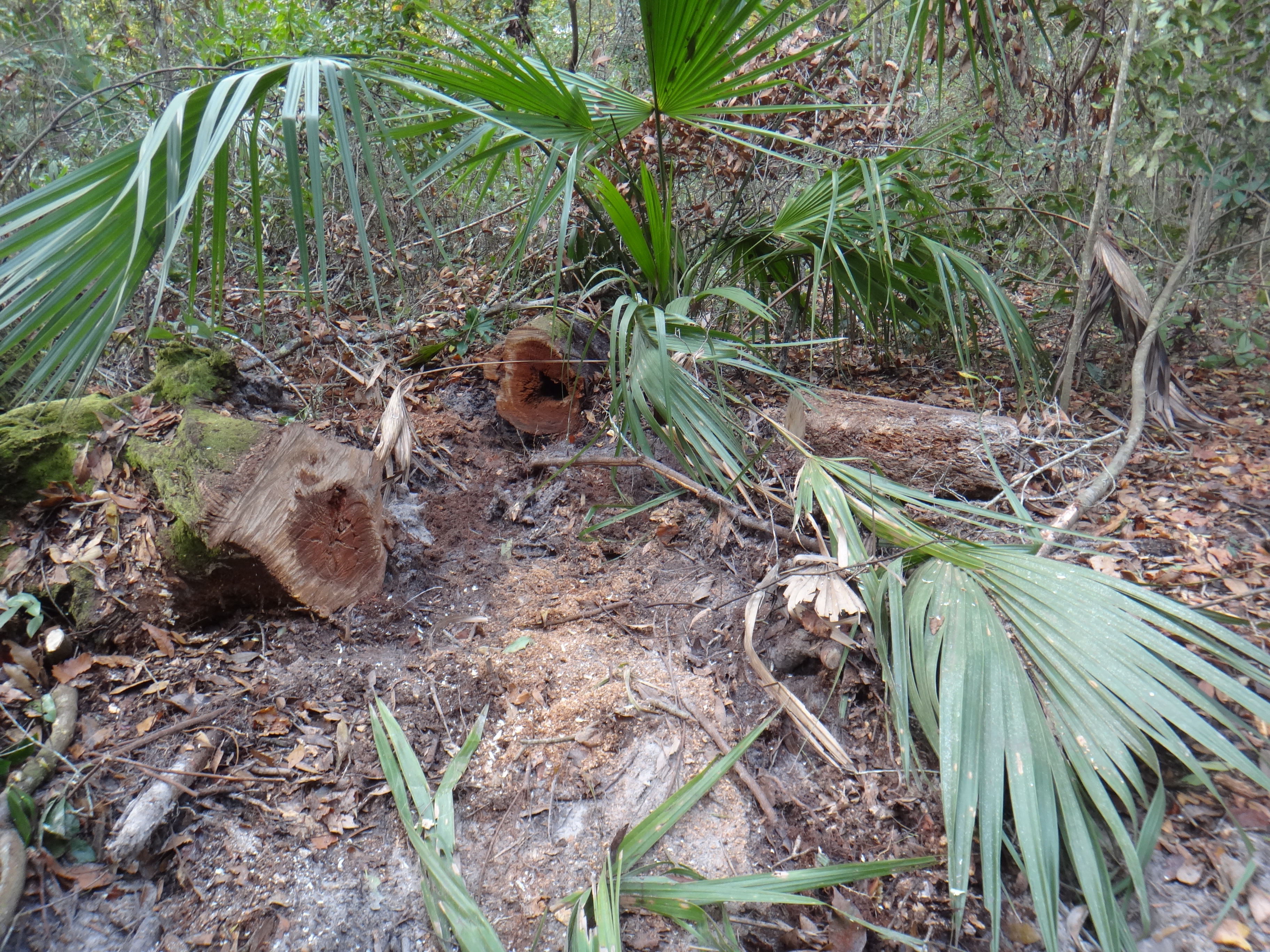

Photo #5 + Photo #6 I wrestled out the three partially buried, residual stump pieces in two loads, then placed pieces against the base of an Oak and picked up all three pieces with the Debris Forks for transport 1/2 mile to the community burn pile.
