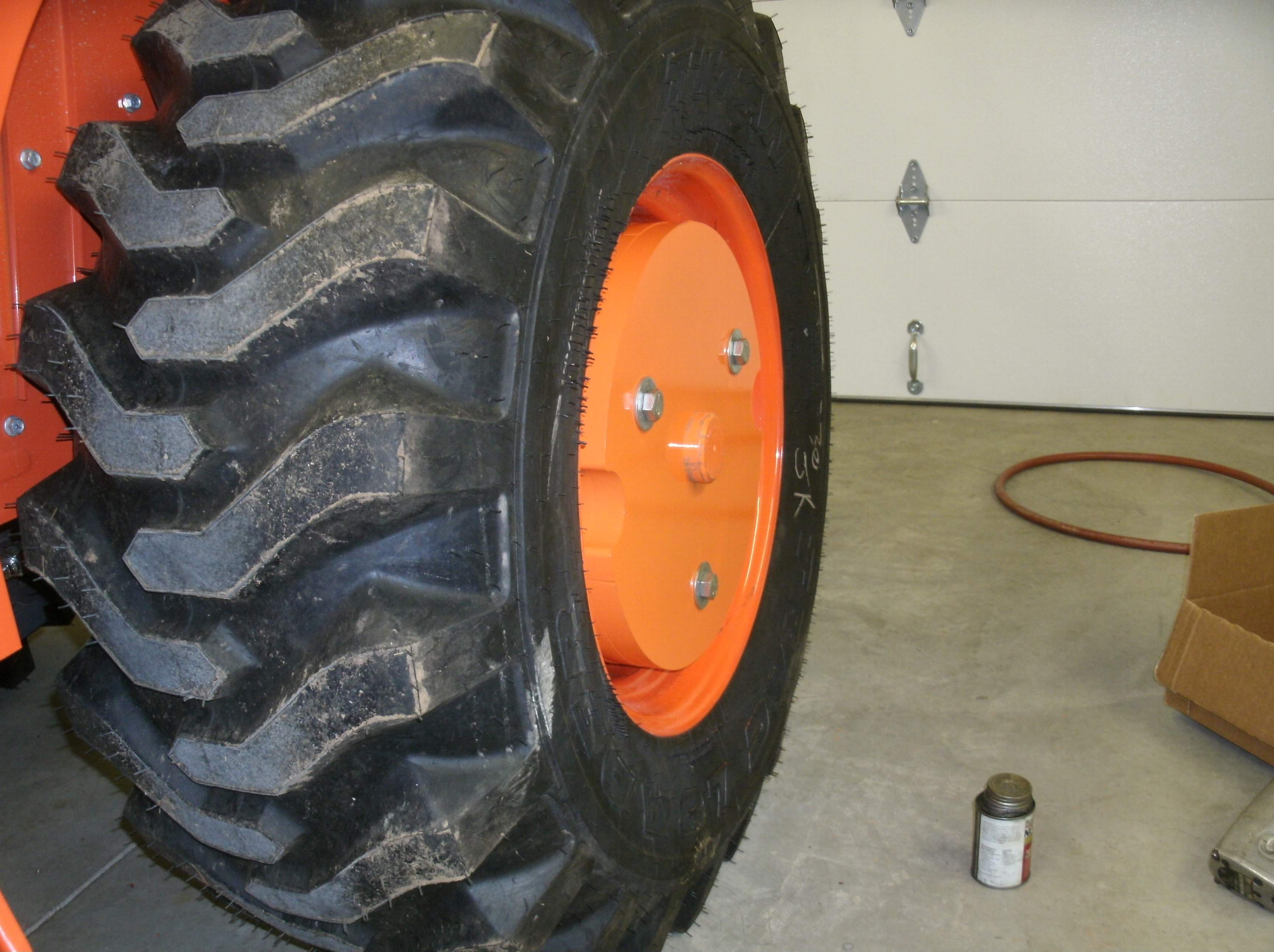

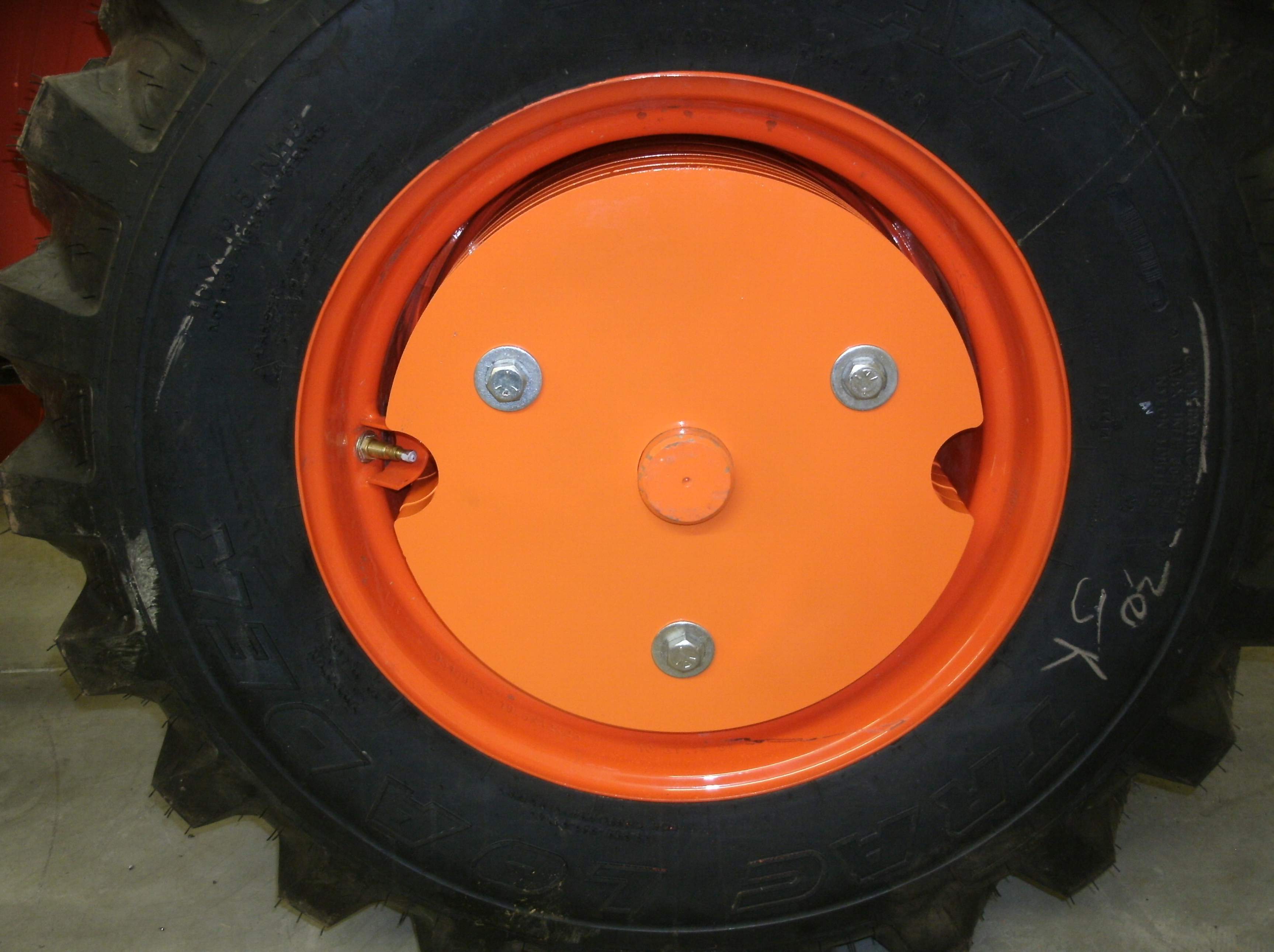

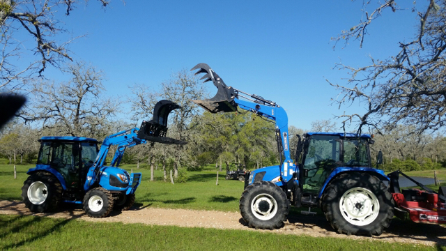

Here are a couple of pictures of the wheel weights that I made. You may not need to add this much for FEL work, but for grapple work it just made things operate so much smoother. Just love this tractor, BTW.
/ Ballast ? #18
Those look very nice!
/ Ballast ? #19
Yes they do. Steel plates?
