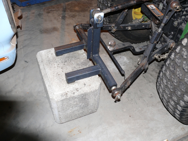

My 955 has turf tires, no liquid. I built a 3pt weight made from cement to balance out the weight of the 59" blower. No pics currently, I can get a couple if your interested.

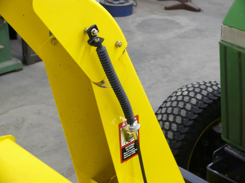

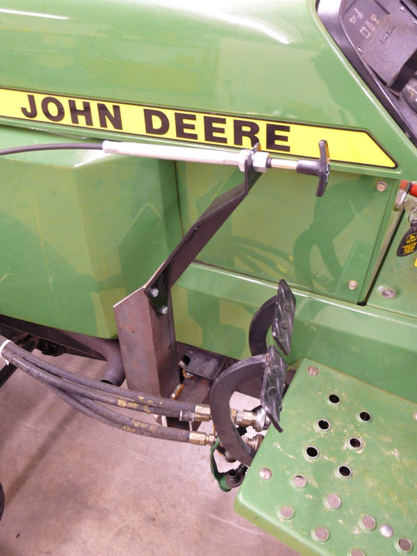

I did put the Deere remote spout control on this year, what little I've used the blower, its worked great.

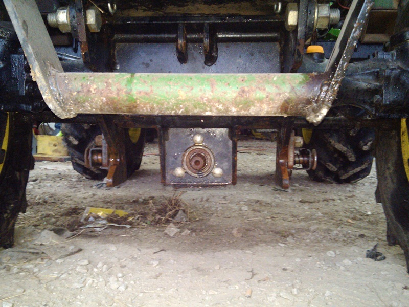

I have also been sitting and watching another add since December its a Gearbox, driveshaft, front bumper/hitch and hydraulics for a 755 as the gearbox s/n says. It is 20 hours away I am thinking of getting it shipped.
If i was to purchase this would i be better off as then i can get any 47" blower even another brand to make it work?
OR should i just hold off and wait for the 47.

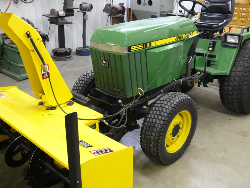

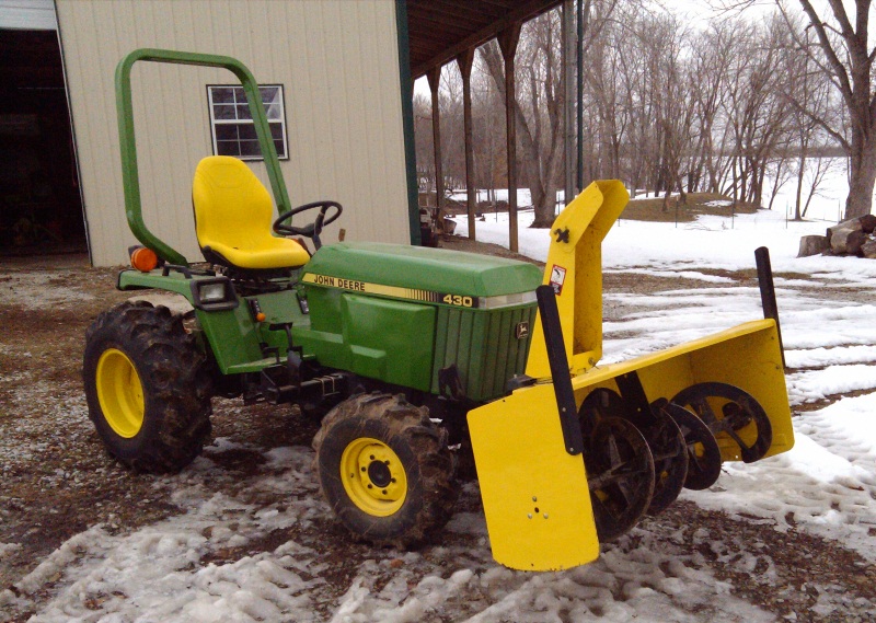

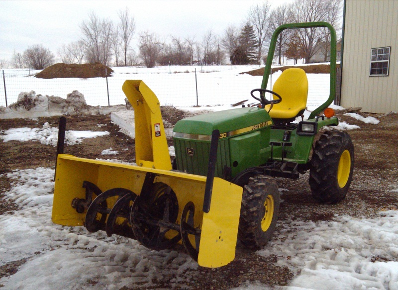

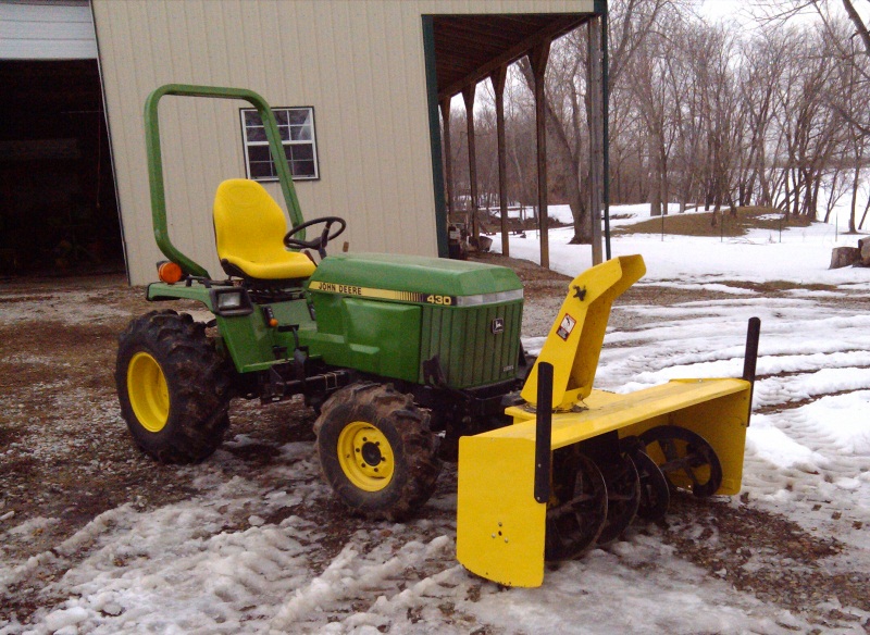

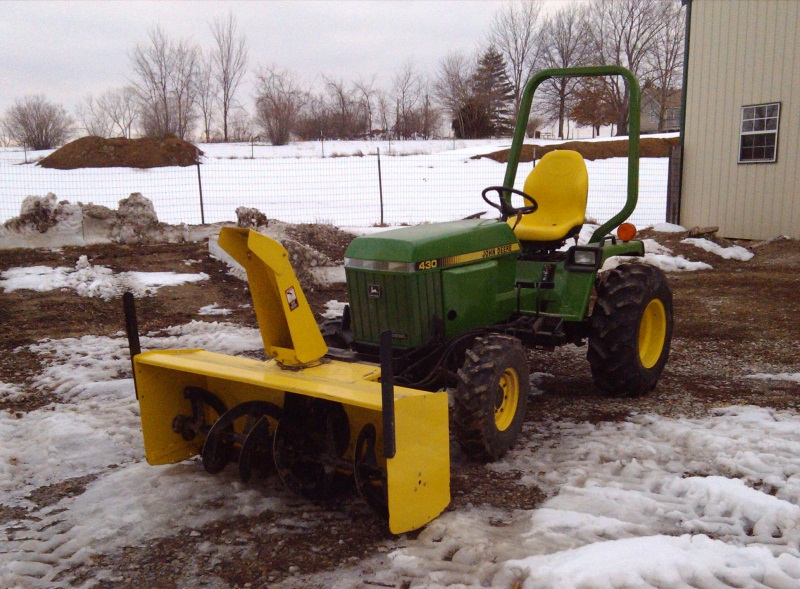

Just what is a good deal? I believe the answer to that question is different for everyone. It depends on the condition of the equipment, the availability of the equipment in your area (number of units and frequency that they come up for sale), and the popularity of the equipment when it does come up for sale. I've seen pristine 59's for sale for $5000 (I would consider this unit pristine... extremely low hours), used but not beaten units for $2500 to $3500, and well used to beaten units from $1500 on down depending on condition... and sometimes, that is for the blower itself not including the quick hitch and driveshaft. The price for the quick hitch and driveshaft for my 955 from JD is ~$1300... used is considerably less but a rare find. Those are the going rates in my area... and stuff for 955's doesn't come up all that often.
Let's just say that I paid in the "well used to beaten" range for a pristine blower with the quick hitch and driveshaft... complete setup. For me, that was a honey of a deal. Here are a few pics of the 59 mounted on my "430" :laughing:
View attachment 306596 View attachment 306597 View attachment 306598 View attachment 306599

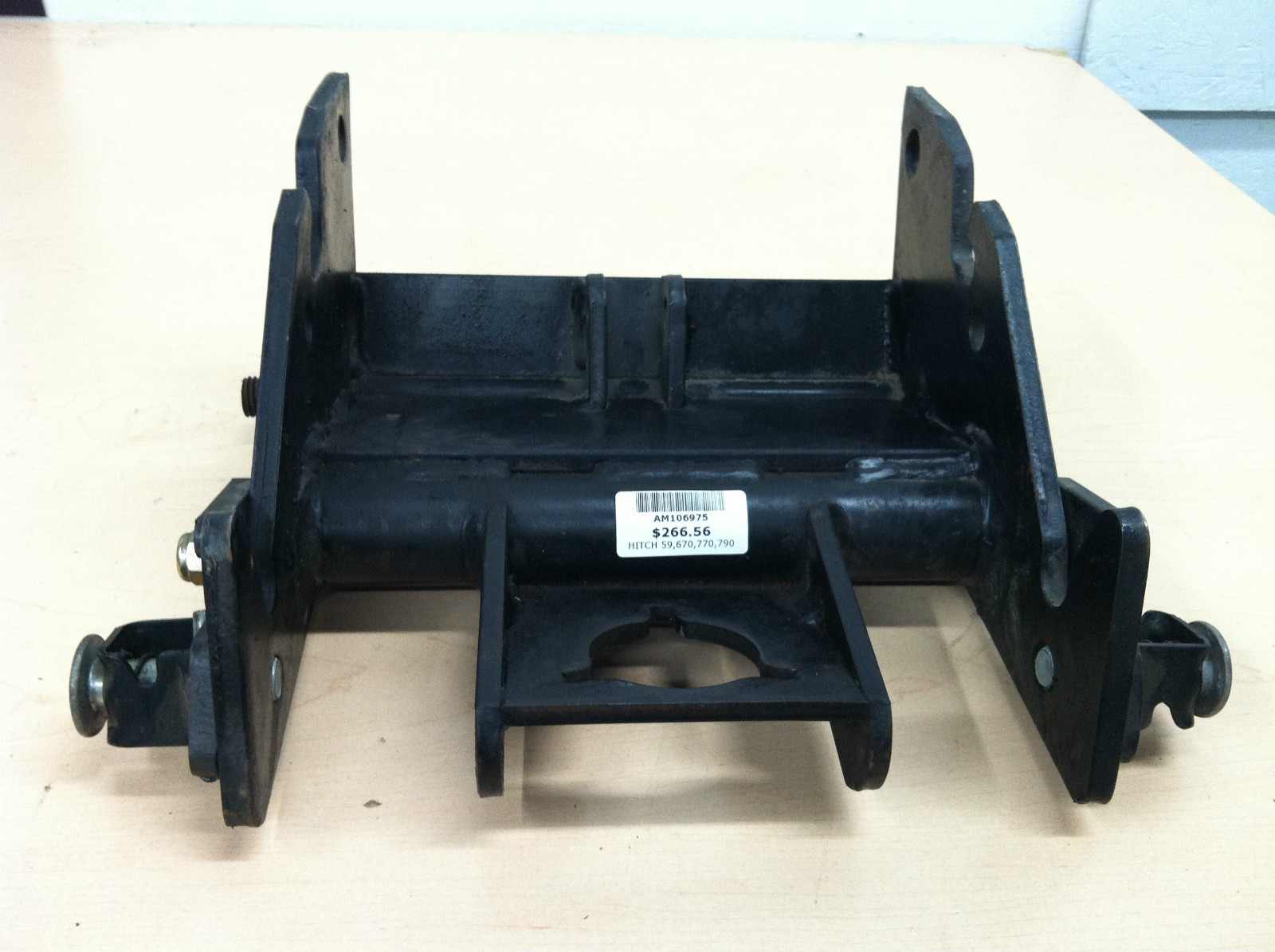

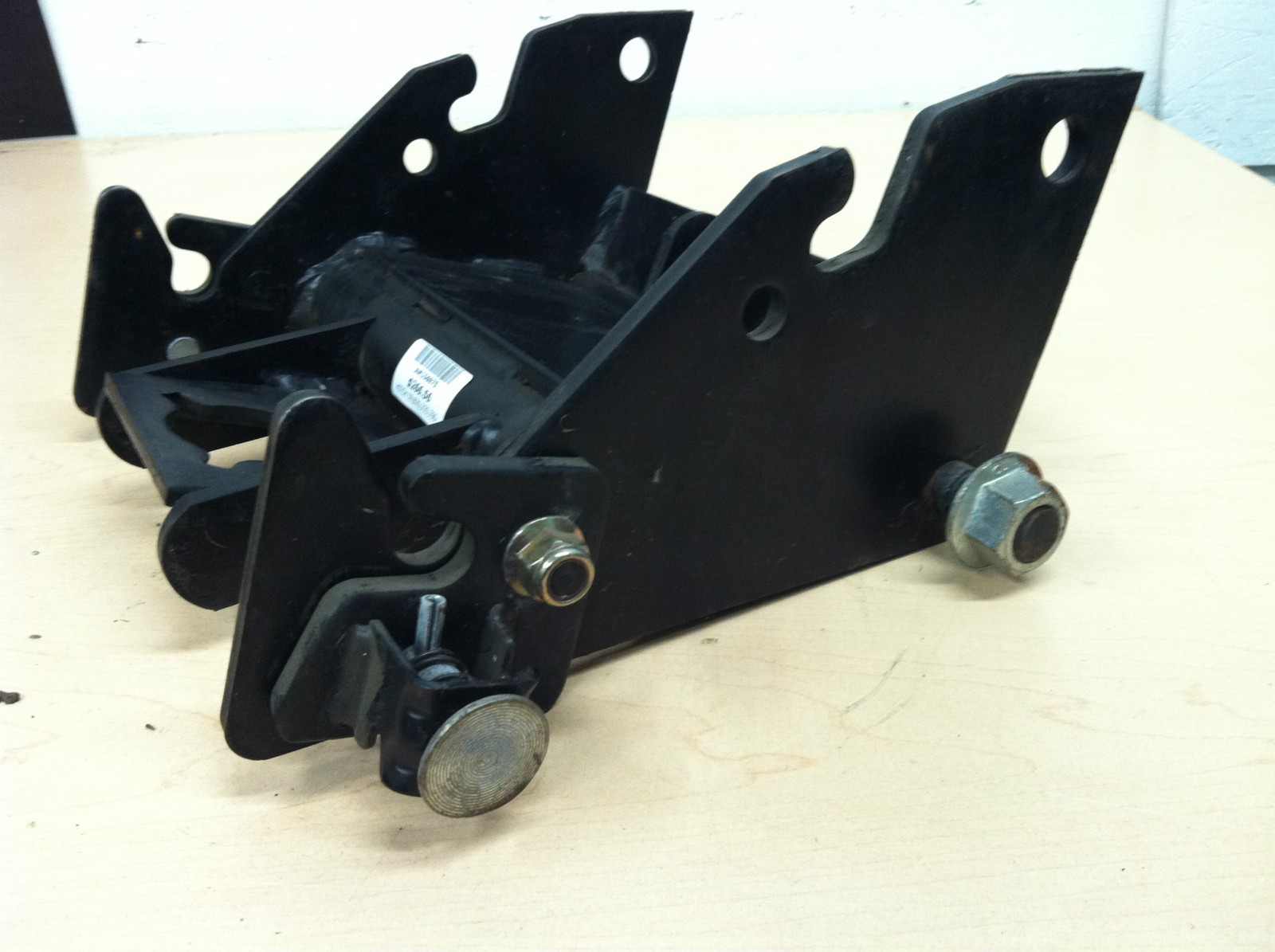

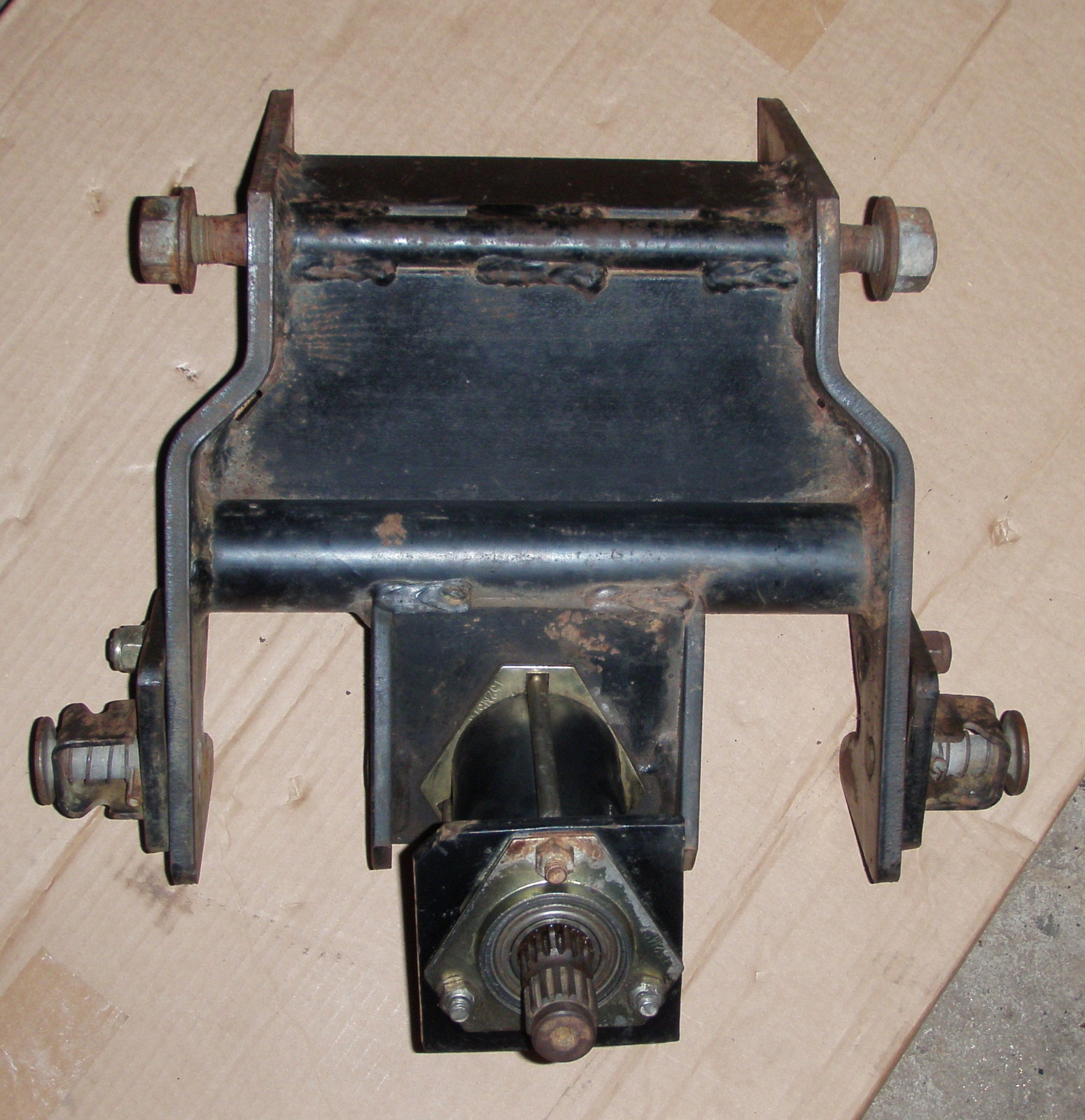

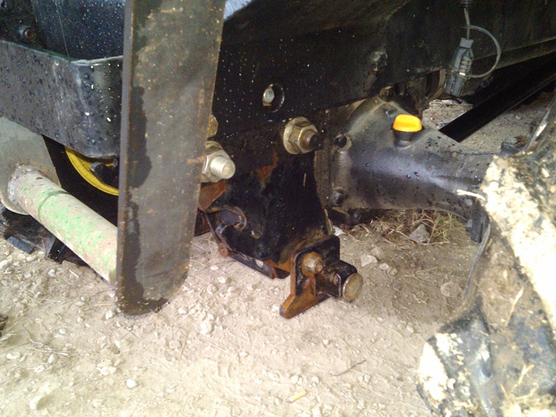

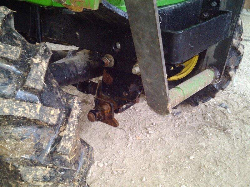

A word to the wise for all you 55 series owners shopping for a 59: The sticker on the blower says "855/955 & 670/770", so I've noticed that most people assume that the whole setup fits all these tractors and they are advertised as such. In reality, the blower will fit the 855/955, 670/770, 790 & 3005, BUT the Quick-Tatch mounting brackets are different. There is one bracket that fits the 55 series, and a different mount that fits the 70 series, 790 & 3005. Make sure the one you're looking at has the right mounting bracket for YOUR tractor! The 55 series bracket is straight up & down on the sides and the 70 series, 790 & 3005 mounting bracket is flared out on sides.
55 series mount: 55 series mount.jpg 55 series mount2.jpg
670/770, 790 & 3005 mount: 70-90-3005 mount.jpg

Heres the weight I built, its appx. 15" x 15" x 22" wide, the tubes that go down in have rebar welded to them to keep the cement from falling off or breaking. Total weight is about 400lbs, never had a problem with lack of traction.
Ed
