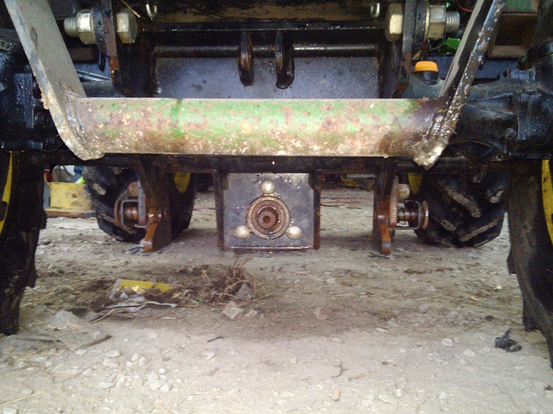

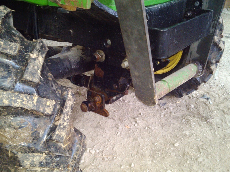

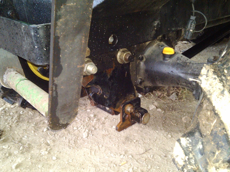

In case anyone is wondering (I was), on the 55 series tractors you can leave the Quick-Tatch bracket bolted to the tractor with the loader mounted. I needed to use the loader, but since I'm not 100% sure we won't get anymore snow this season, I didn't want to completely remove the Quick-Tatch bracket and Mid-to-bracket PTO shaft if I didn't have to. The design of the Quick-Tatch easily clears the parking stand of the 70A loader when mounting the loader on the tractor. It does hang down really low (below the front axle) so I wouldn't want to leave it there to do any serious loader work.

I suspected as much... another reason I wouldn't mind getting a 59. I did know the brackets are specific to the 55 series, hence why I would only consider a complete package from a 55.
I use my loader year-round and seldom even take it off during winter. Since my wallet won't allow me to buy an additional tractor, I need to get the most out of the one I have.
