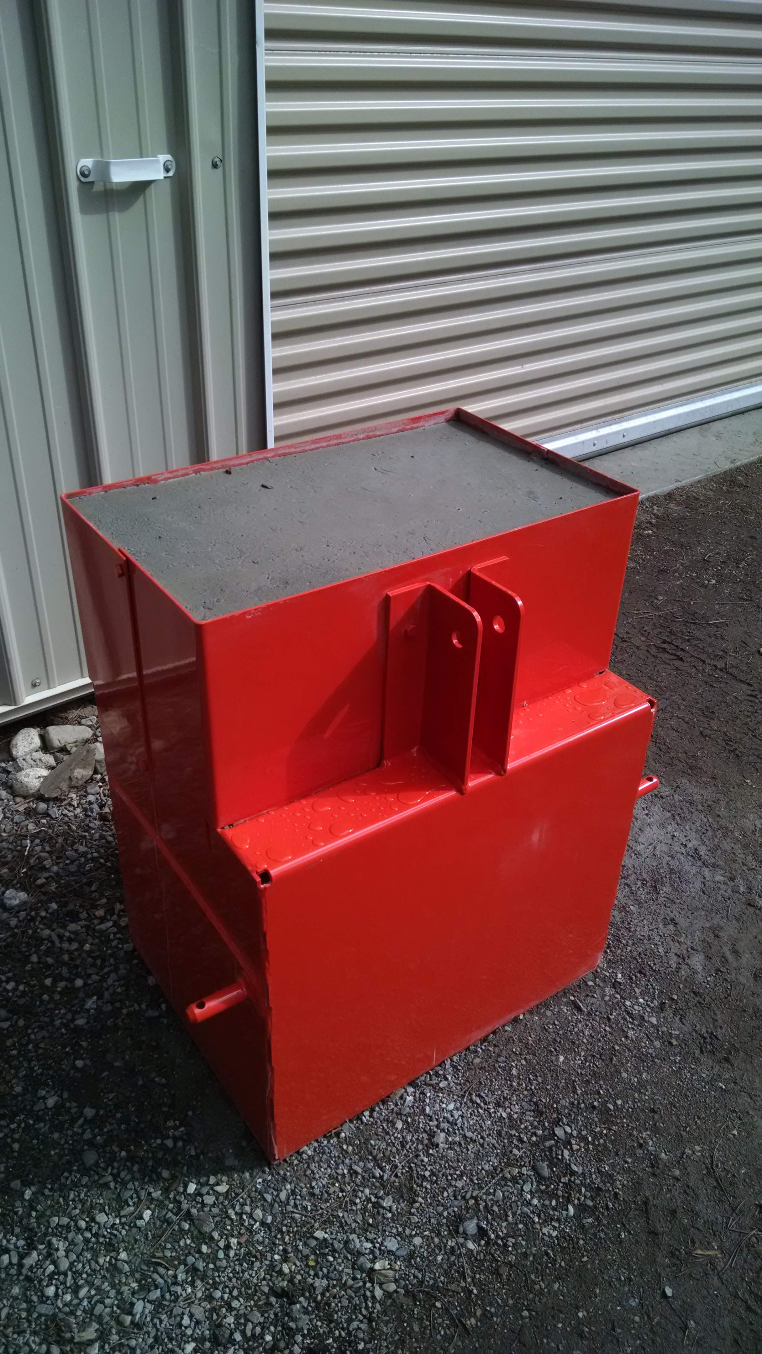

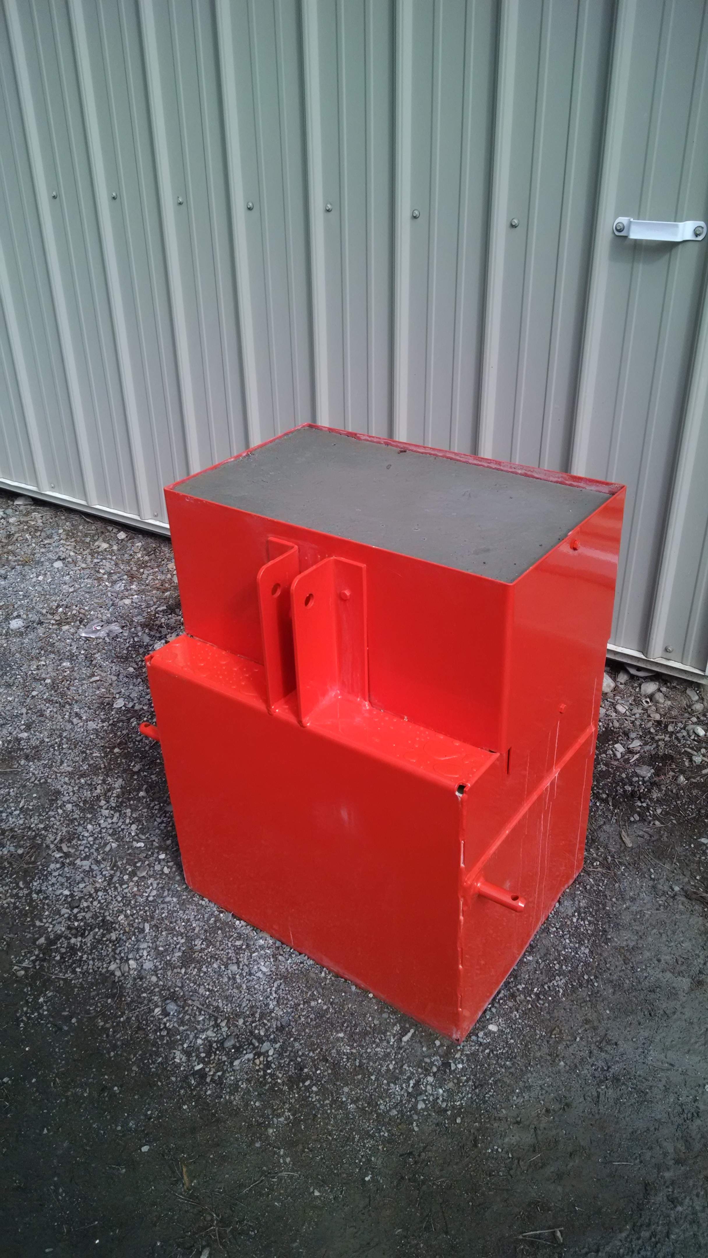

I keep having top move larger liquid cooled generators and the tractor was having issues lifting a 1,600 # unit with the forks. i kept lifting my tractor rear end.
had to break down and get a ballast box. Couldnt find a kioti or kubota brand anywheres, so i bought a Frontier (JD) box and extension ring.
Of course, i HAD to get it powder coated first. i mean really.
Added 880 # of concrete to the mix, and now i have 1,000# rear ballast box.
just in time. Have to order another 45KW generator next week. IMG_20150318_141524027.jpg IMG_20150318_141532427.jpg

i was going to weld one up also, but there not that expensive to buy.
i have a buddy that has powder coat shop, so that was reasonable also.
i didnt want an old oil drum look to my box.
