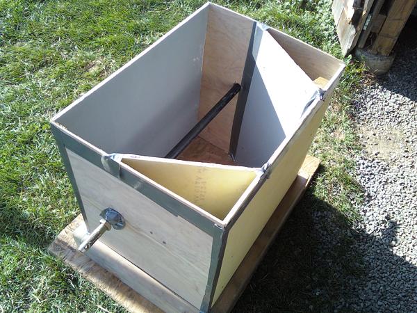

counter weight1.jpgSounds good, but just a suggestion. If you are going to permenatly fill it with concrete why not just skip the steel and build a wooden form and just cast the cube.Ballast 1.jpg If I where to remake this one I would use a drawbar with a 2" receiver and the tubes for tools as you suggested.

I guess I just don't really know how to build a concrete form. What thickness of plywood? How do you keep it from leaking? How do you keep the concrete from seeping up into the bottom of the tubes?
/ Ballast box design #4
Start with a plywood base , 1/2" is fine . Were sides meet bottom , you will get little if any seepage , if good straight cuts , You can also use Duck tape like in picture above . Screw plywood together from outside box , thus after cement cures for a couple of days you can get form off . With your vertical pipe for tools , etc.. , You can either drill holes same size as pipe in bottom form board and run them through , or simply silicon them in place . If you are concerned about plywood " Flex " on back or sides , From inside box , screw through to outside into 2" x 4" 's . The 2" x 4" 's then can be screwed to each other from outside , thus strengthening form . After Pour and cure , Remove screws holding 2" x 4"'s to each other , remove screws from plywood corners and base , then remove screws from inside plywood releasing 2" x 4" 's from plywood .
A pour that size , I would let cure likely at least several days , before trying to remove form . 3' x 14" x 6" steps I poured in back sat for 24 hours before removing form . Your design may allow the ability to use ballast sooner , as basically you would be making a metal bucket and carrying the cement , while a poured ballast would need time to cure before trying to " Lift " the ballast .
I don't need a ballast in back , always have some sort of attachment back there , from 1100 # disk , Backhoe or whatever , But have poured plenty of cement ( Not Commercially , just home use ) , and there is nothing more frustrating than trying to take a form off to soon and pulling the cement apart .

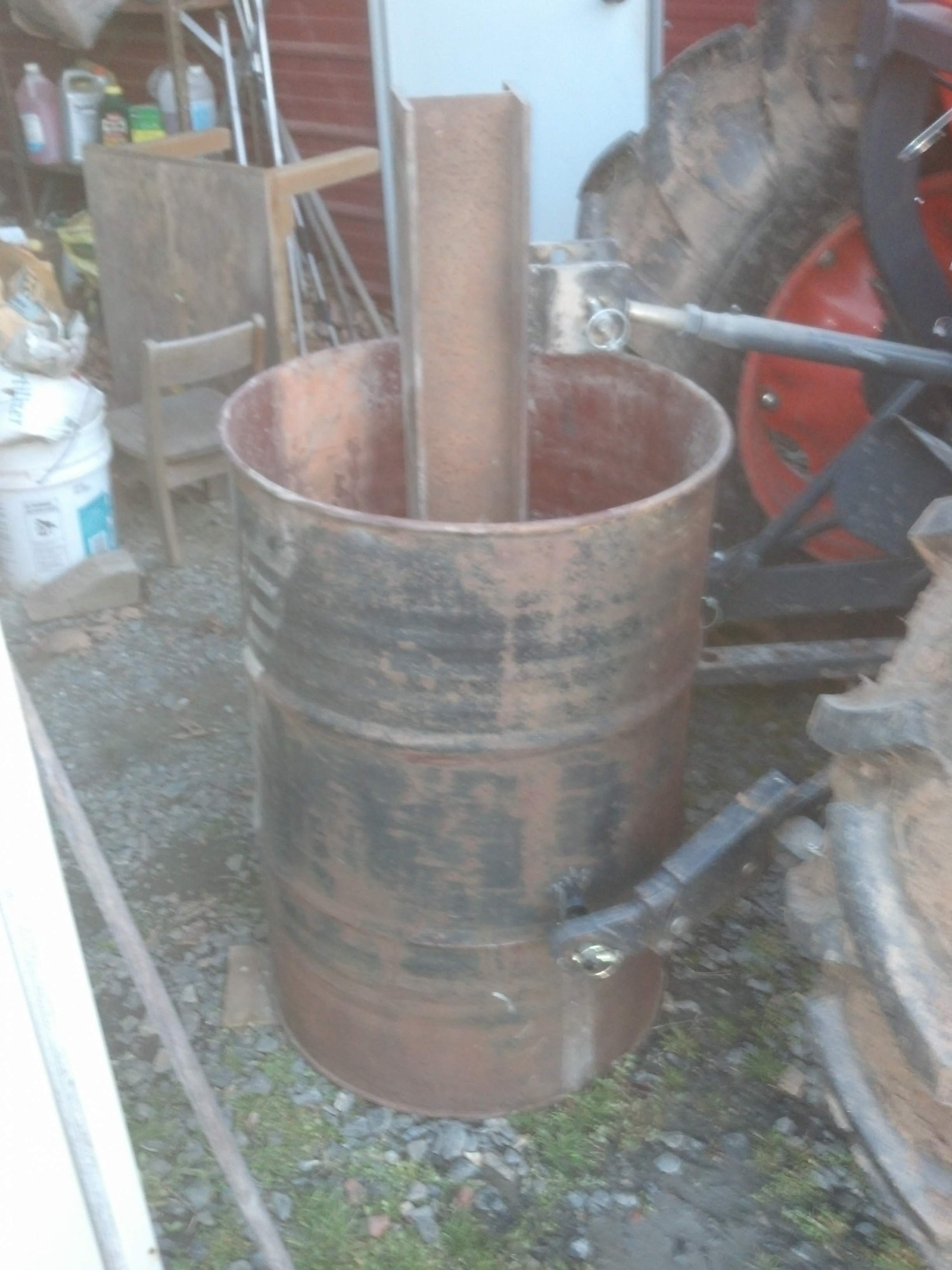

A used 55 gallon barrel will cost 10 to 15 dollars vs. the cost of steel or plywood to build the box/form. Nine 80 pound bags plus the rest of the hardware for the 3 pt hitch will put you in the 900 pound range. It will be stable and you can put your tool holders inside or out.
I built mine for the cost of the barrel, concrete and cat II drawbar. I'm guessing in the range of $90 total. The I beam was left over from another project = free.
It's totally vanity, but I want something that looks a little more professional than a 55-gallon drum hanging off the back of the tractor. But the price sure is right!

Joshua, as you know I went the 55 gal barrel route so I could have room in the top to store things.. Chains, Chainsaws, water bottles. etc. it is pretty cheap too. at $9 for the barrel. One more thing if you use the plywood forms, if you will coat the plywood with a brush on coating of old motor oil, they will release so much easier. Also on the 2 inch pipes for the handle tools, if you will put a bolt thru the bottom of the pipe this will retain your tool handle but still allow dirt and debris and water to fall thru the pipe. (I didn't do this but I should have) Good luck with your project!

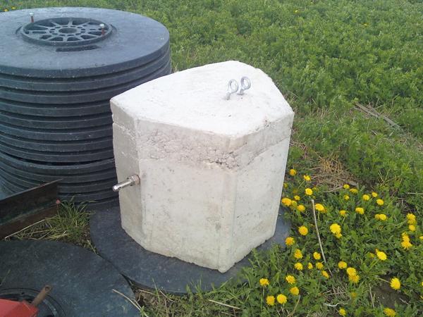

2nd on the oil to make the forms release. It will also smooth the finish. Use some cheap caulk on the box seams to make the finish smoother on the corners also. I would put some reinforcement in the block since it's pretty easy to do although it probably will be fine without it.

View attachment 316753Sounds good, but just a suggestion. If you are going to permenatly fill it with concrete why not just skip the steel and build a wooden form and just cast the cube.View attachment 316752 If I where to remake this one I would use a drawbar with a 2" receiver and the tubes for tools as you suggested.
That is how I am eventually going to make one. I can't figure out why almost everybody buys a ballast box on fills it with concrete :confused3: I keep eyeballing the bust bags at Lowes that are 1/2 price.
/ Ballast box design #13
FYI if you tap the sides of the form with a hammer or mallet as you go the sides wil be nice and smooth. If you look at the picture of mine see if you can tell where I forgot this step. :) Also instead of rebar I just set in scrap metal I had for added weight and strength.
