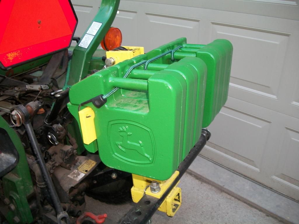

There have been a lot of threads and posts about ballast boxes etc....
Here is my version. I have about $10 of on hand material into it.
I only bought/needed 6 suitcase weights, as my tractor front bracket only holds 5 weights....
Good luck

That's a nice piece of hardware!
Looks sturdy as heck.
What is the red ororange pieceI see just below the weights, but above the drawbar?
Did I understand correctly that you got those weights from Home Despot? Online or in store?
Thomas

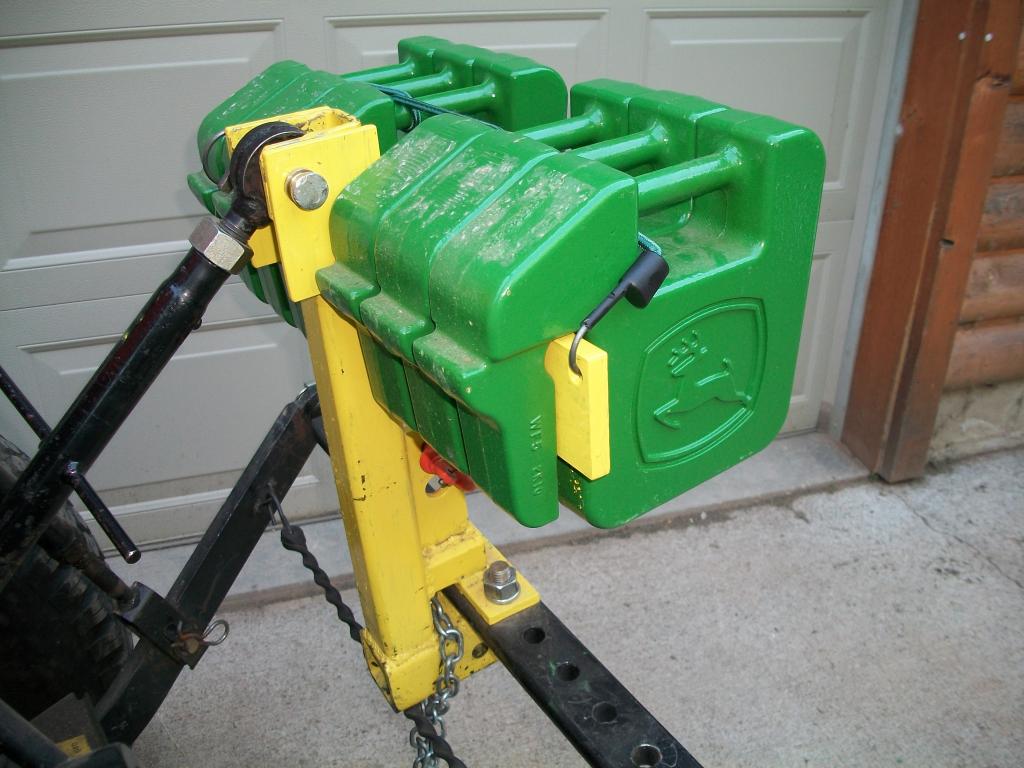

   / Ballast Bar for Suitcase Weights...
The orange thing just under the weights and above the 3pt draw bar, is a shackle in a hole drilled into a gusset.
The orange thing in the other picture is another shackle in the stationary draw bar.....
I try to paint things that are easily lost in either orange or yellow, to make them more findable.
Take care...
