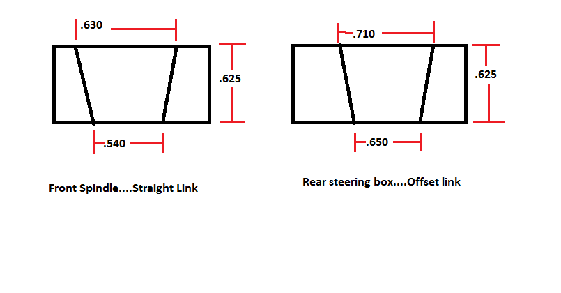

Working on this IH 300, ball joints/drag link ends are $50 each:confused2:
Looking for a suitable (and affordable) solution, the ones that fit most of the common fords of the era (N-series, 600/601 and 800/801 series and more)......Seem to have the same 11/16" x 18TPI threads. And look darn similar. But no one lists the dimensions of the taper part and castle nut.
So has anyone been down this road?? Will they interchange?? Or is there something else that will work and not cost $50 per joint???

Or....if anyone has one of the mentioned ford joints laying around, if they could take a measurment of the taper part. Diameter at the big end, small end, and taper length, I'll measure my old ones and compare??
Sucks that $50 per joint for the IH. IF the Ford ones will work, I can get all 4 for that price.

I am sure the threads are correct. The taper part is what I am unsure about. IF the threads are correct, but it dont fit in the spindle, it does no good.
Do you happen to have, or would be able to measure the tapered hole on the spindle in one of the fords?? Big end, Small end, and thickness?? Just to comfirm??

Here is what mine measure that I need the joints to fit.
The big end of the taper is hard to measure, but pretty close...

By typing in the IHC OEM part numbers, and doing as you say, it lists a bunch of ford models. Same as all state ag parts does.
Just wish I knew for sure before I order.....
Its just odd that most places like YTMAG, are charging $50+ for the joint if looked up under IHC, and $13 if pulled up under ford. Makes me wonder if there is indeed a difference??? Or if YTMAG is indeed pulling the parts from the same bin:confused3:
Was going to call them today, but got tied up. May have to give them a ring in the morning.
In the meantime, if anyone has a 1950's or 1960's ford of the models listed in my earlier link tore appart, if they could measure the spindle hole and the steering box hole and see how they stack up to my numbers?? It would be greatly appreciated.
