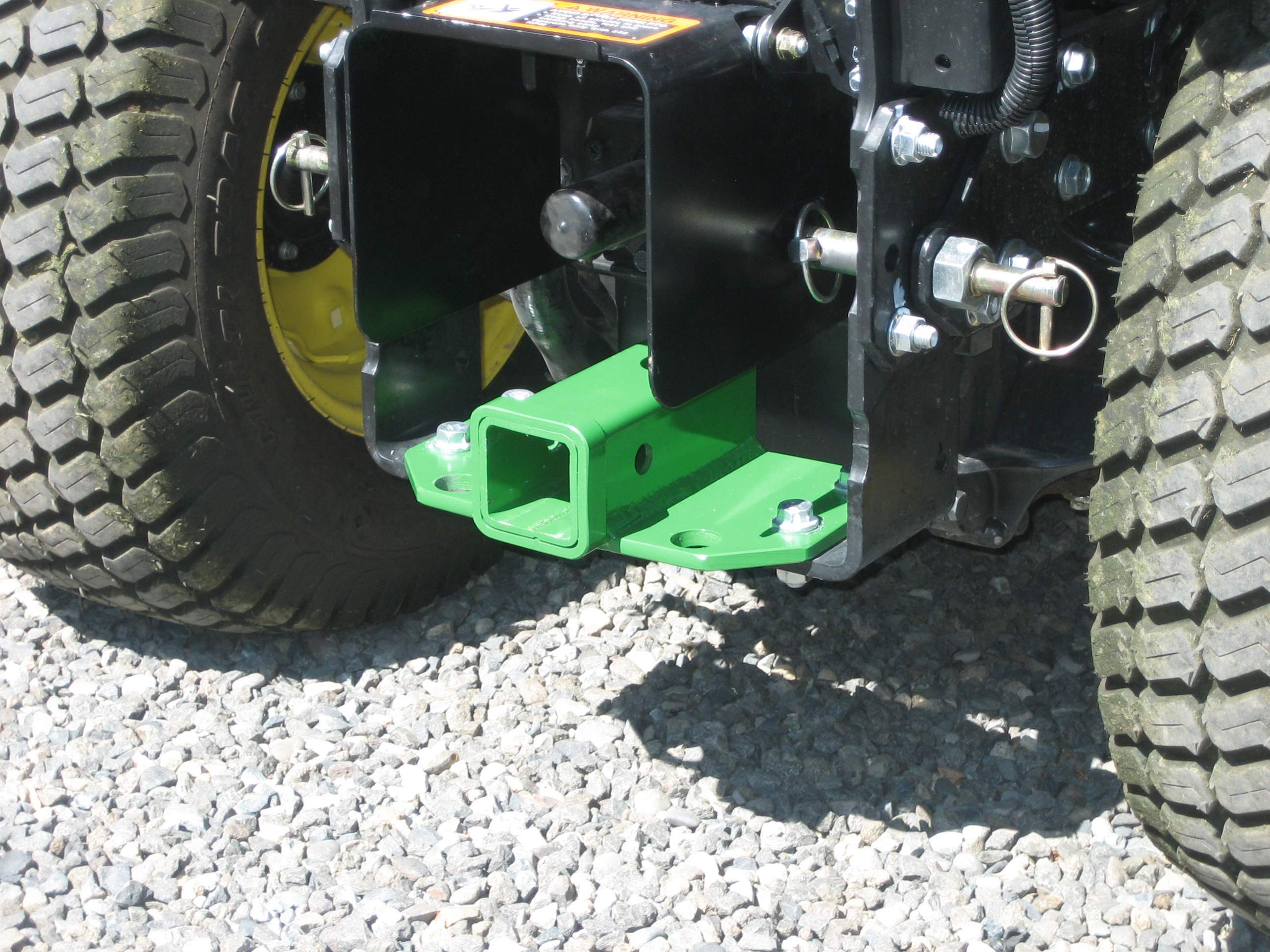

Quick-On Receiver Hitch
This one from BXpanded.com works really well.

I bought the BX24 receiver with the hope it would fit my BX23... the manufacturer thought it would but never tried one on a BX23...
The clearance must be different because it does not fit my BX23...
I also bought the front tie down points... also does not fit the 23 although I can adapt them easy enough.
