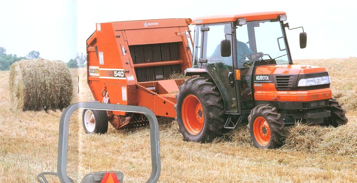

I had a Kubota full color brochure showing a Grand L pulling a Heston 500 series round baler (and I think it was a L4310). I don't know what I did with it but I'll look and try to post the picture of it. I don't think of a CUT being designed for haybaling so I never plan on using one for it but this picture would sure convince one that it was possible.

Hi Buck1,
John Miller III posted a similar <A target="_blank" HREF=http://www.tractorbynet.com/forumfiles/47-174963-KubotaL4310HSTBalingHay-cropped.jpg>picture</A> earlier in this thread.

Checked the John Deere site for spec.'s on square baler. The ones I looker at had a required PTO of 35 HP. Why would you not bale hay with a 4710 w/ 40 HP PTO?

You can sure do it. But all I've got to say is hook one up and try it. When that plunger comes around and packs the bales it does throw the tractor around. The tractor lurches forward and back every time the plunger comes around. I've baled a few times with my 4600 but I wouldn't want to do it very often.

A round baler is harder on a tractor Mike plus you've got ALOT of extra weight. I really can't believe that Kubota puts these tractors in their ads pulling a round baler. I guarantee you get on a hill sideways or up and down and you are going to have problems. I think it's complete lack of any common sense that they do that. I've seen guys with big tractors get in trouble with round balers on hills not to mention the hydraulics to run one as well. If you talk to a JD dealer they won't even sell you a compact tractor to bale hay with, be it a square baler or a round baler. It's kind of like taking one of these little Toyota pickups and hooking a big 4 horse gooseneck trailer to it. Sure it could probably pull it but it's not a very good idea and you are going to ruin something plus it's only a matter of time before you have an accident. Just like Ford pulling that ice cutter ship in their ad. Sure it may be able to do it but you're not going to!!! I abuse my 4600 alot and this is something even I wouldn't do.

If you're talking about one of the old balers that made looser bales and didn't have near the weight, size, or compaction ability then yes you may be able to get by with the bigger compacts. These new balers though I sure wouldn't do it and I wouldn't recommend doing it with an older one. If you need to bale hay buy a utility tractor. That's what they were made for.

That's the one! What's the latest on this story? After learning more about round balers, I'm surprised that Kubota would use this for advertising. Given this picture, I think this guy has a good argument for himself.

They flat out denied him warranty coverage. Said the baler was the cause and he never should have been baling with it as the tractor was not designed for baling hay. I don't know how they can say that seeing the brochures with the round balers. He's going to sue them according to the Moss/Magnuson Act so we will see.
