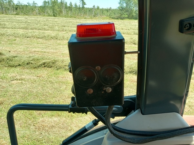

Anyone mount a round baler control box in an M7060 cab?
Been looking at either door post clamps or magnetic mounts, looking to see what others have done.
Also planning to power it with the 25 AMP plug in the cab versus running direct from the battery.
Had the control box on open tractors, easy to clamp it to the ROPS.

I ended up piecing together RAM style 1" ball mount components on the right door handle. SMV spade style mount for my basic NH box. I can adjust it to be the exact position I want and it does not obstruct any other controls and is easy to use. Box did not move from where I set the clamps despite all the bouncing in the fields and roads.
I did power it directly with the in cab plug. I did make a custom harness with heavier gauge wire and used the 25 AMP pin. I did not have any electrical issues with my non computerized monitor/control.
