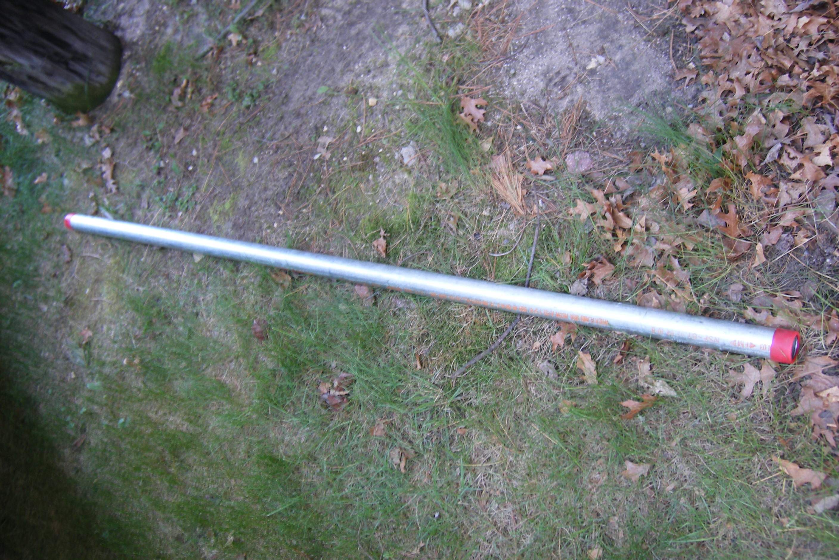

I'm driving a shallow well out in our garden area. I got the pipe and supplies from Menards and so far, I have trashed 3 of the pipes. The drive cap doesn't thread all the way down onto the pipe; it goes about half way (and that's using pipe wrenches to tighten it on). The drive cap appears to be slightly tapered on the inside. When I hit the drive cap, eventually the threads collapse in on themselves. The first time it happened, I blamed myself for not threading it on all the way...then I realized it wouldn't thread on all the way no matter what I did.
I have the point driven in far enough that I can't pull it out, but I was able to unscrew the pipe from the coupling (three different times) and get them out, and screw a new one in. I'd probably trash it if I tried pulling it out with the tractor.
I'm not even striking the drive cap that hard, I'm using an 8lb sledge and after mangling the first pipe I have been babying it. I'm driving it in and I'm not hitting any rocks, but the threads aren't holding out long enough for me to keep going deeper.
Has anybody experienced this before? Shouldn't the drive cap thread all the way onto the pipe? I have to think the threads are the weakest part of the pipe and the pipe fails right below where the drive cap stops. I think the pipe and the drive cap are both junk, I'm not sure if the pipe is schedule 80 or not but it has "well drive pipe" printed on the sides of each one. That doesn't mean much to me when it fails like it has been, though.

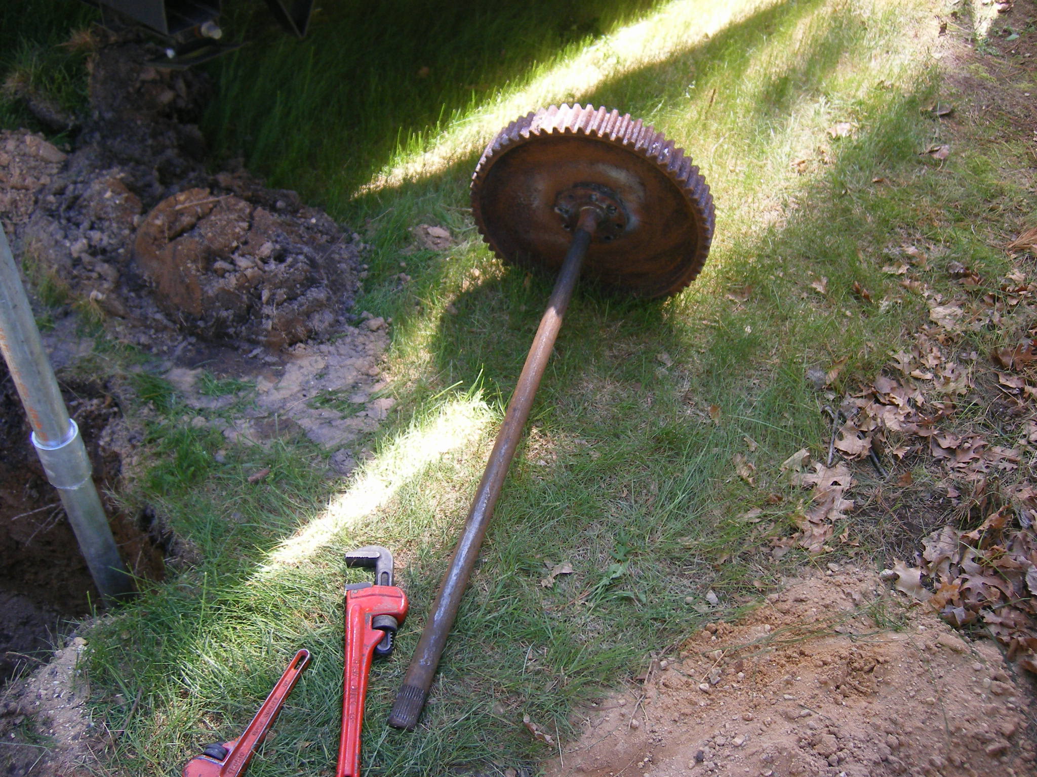

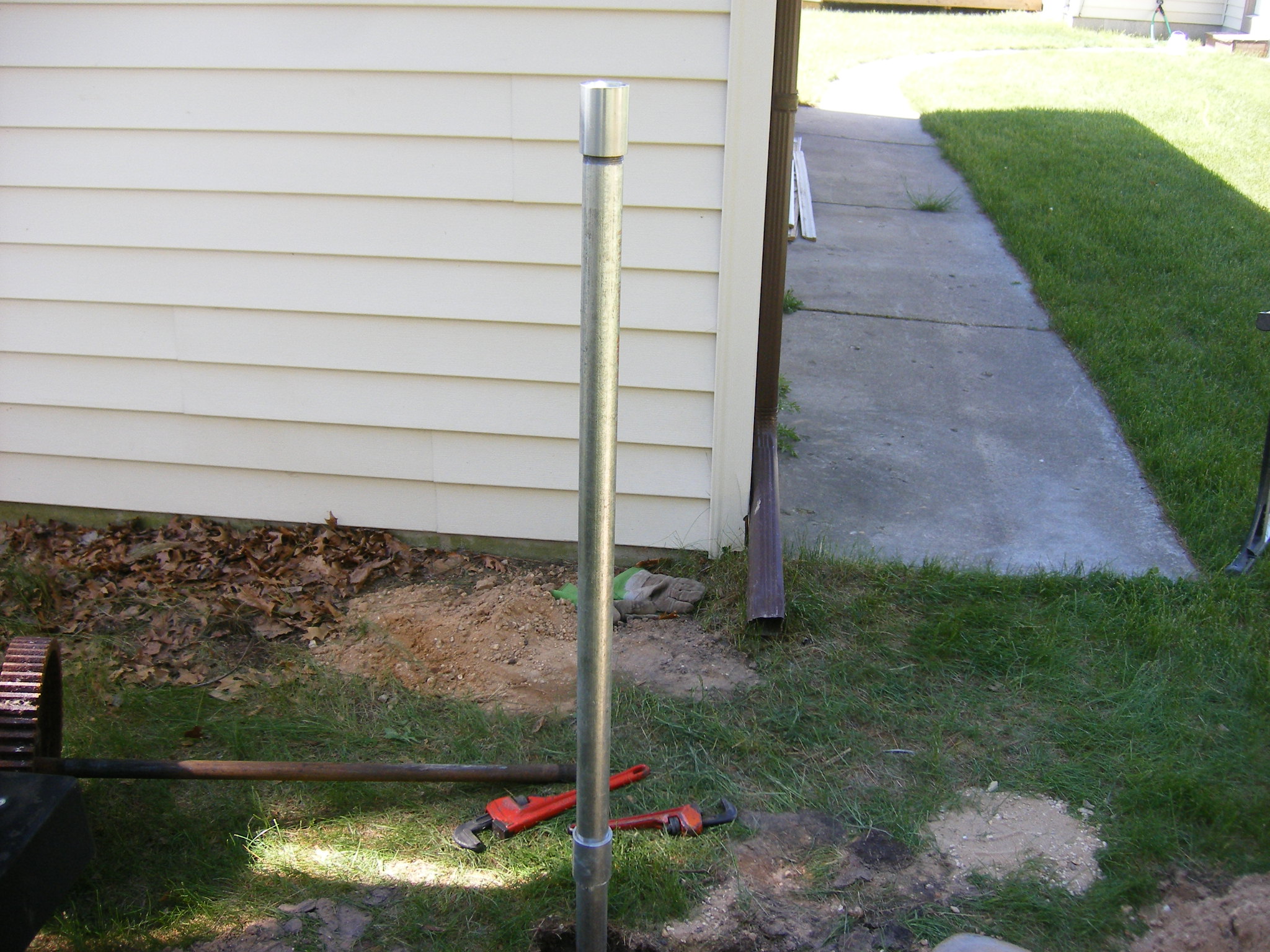

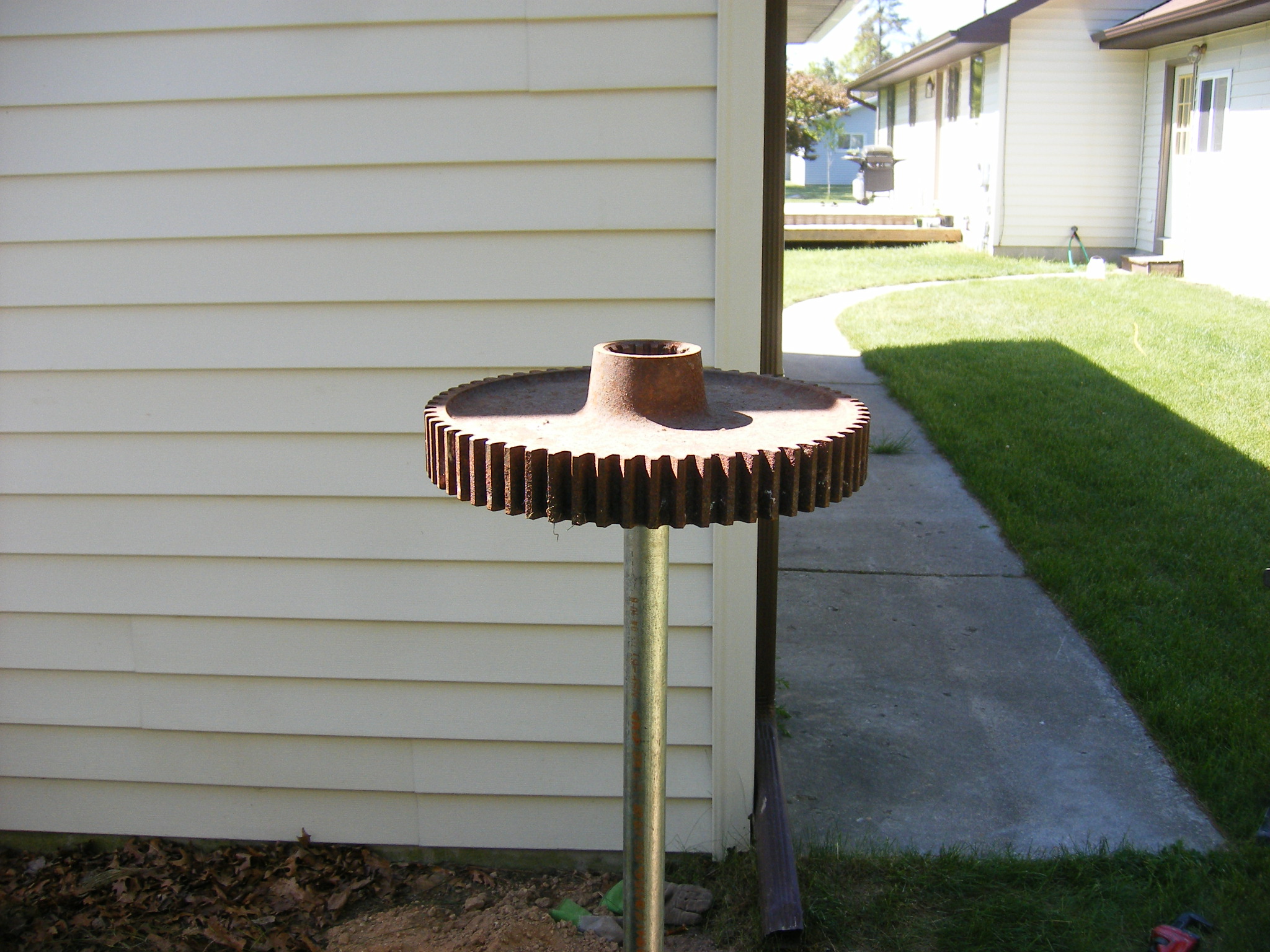

You've gotten pretty good guidance. I drove a well last week. Driving caps are alright, but they aren't necessary. You can just drive with the drive couplings if you use a different tool than a sledge.
My neighbor quickly welded up our driver. It is a 65 pound gear he picked up in the oil fields as scrap and tacked it to an axle shaft. Worked like an absolute charm and there is no damage to the drive coupling. Just for extra protection, I slipped a large washer with a 1 1/4" center hole over the axle before slipping the axle into the well pipe. Whatever nicking or distorting was absorbed by the washer and the drive coupling remained brand new looking.
I did have to re-tightening the drive coupling every dozen whacks. They do shock themselves loose a bit and loose mean quick damage. No problems.
Here is my thread from last week. Photos, etc.
