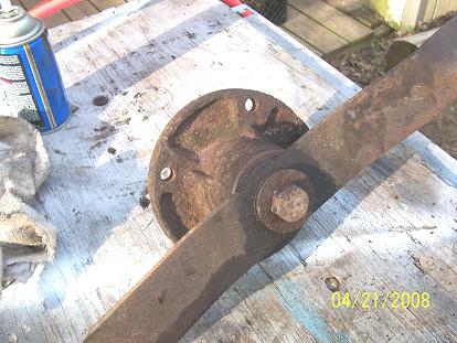

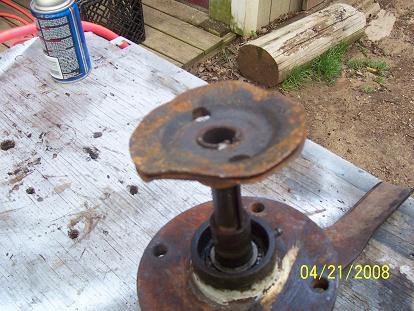

As you can see the pulley is kinda bent!!!! It took me two days to get it off the shaft. Lots of torch time, WD40 and the pulley jumped off about thirty times.. Getting another pulley is no problem... Now I am trying to get the blade off,, I do believe it is going to be harder than the pulley. Heat, WD40, impact wrench!!!!! Has not budged at all. Does anyone know if this bolt is counter or clockwise???? Tried both. Only thing I haven't done is drag it behind the truck down the road at 50 mph!!!!!
SUGGESTIONS!!!!!!!

That looks suspiciously familiar to a Woods deck. I have a RM-48 behind a standard clockwise rotation PTO. My blade bolts are left-hand thread. You have probably been tightening instead of loosening. WD-40 is not much help as a penetrating oil. PB Blaster works pretty good and is readily available.
/ BAD PULLEY!!!! "BAD" PULLEY.. #3
you may screw the bearing but, if you put enough heat on it. That bolt will come out

You know!!!! Gjamtrac sent me a message telling me it was counter clock. This morning I put it in a vise and went to work,, got it off. Now there is another problem,,, on the shaft where the pulley was is a piece that slides onto the shaft that holds the bearings in, it has a pin through it. Well it has turned on the shaft and the pin is bent inside the shaft,, been working on it. But this might be the stopping point,, but taking a break now....

If it is a Woods and I think it is, the manual gives you the parts breakdown complete with detailed drawings and descriptions of how to replace the bearings. It also said that you would be money ahead to just buy a new spindle. Well, my brother and I tried to disassemble one by the book. Used heat and a press. Broke the spindle housing. New spindles as of about 2 years ago for the RM-48 were $111.00.

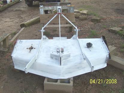

You guys hit it on the head.. It's work!!! But old farts like me just have to tackle something and see if it can be fixed. As far as the $$$;;; I can't afford a new one, so if I bought a used one;I would probably end up working on it... California!!!! Don't think I saved any $$$,, But didn't spend a whole lot of $$$. :D,,( Mower came with tractor.) Now;; Mr. Oliver: Since your a Tarheel,, I don't know about the Woods Mower, it says YM60A,,, Made in USA.... Maybe woods made it for yanmar... The spindle has been brazed as you can see in the picture, but is ok, if I just could get the shaft apart. Will try tomorrow!!!! The deck and rest of the mower is in really good shape, not beaten up or bent. I am going to look for a replacement spindle,, BUT !!!! I gotta try and get this one apart first.... WE ALL BEEN THERE AND DONE THAT :cool: THE THING GAVE ME A MIGRAINE HEADACHE TODAY; HAD TO TAKE PAIN PILL AND GO TO BED !!!!!! :mad:

Just went up and looked at it. Took it in hand, put it in vise.. Punched and drilled,,,, roll pin moved out some more;) .. Dang!!!! I'm gonna do it...

One thing about your deck that looks different than a Woods is the center brace bar coming down from the top link to the center of the back of the deck. Have not seen that on any Woods. Does it have a gear box?
#13
Yes it does. I have everything off for painting and replacing..
gear box: Superior,,, Stockton, MO.

Well I finally got the roll pin out of the bushing (shim)?? and shaft. The bushing is what holds the bearings in. I used my punch as far as it would go!!!! Looked and looked for something to use (to cheap to buy a smaller one). Picked up an allen wrench, kinda hard to drive it with the bend, so I cut it off and made a flat edge. This stuff is kinda strong.. Punched that roll pin right out!!!! Now have to take to a press and get bearings out.... SEE, TOLD YA!!!!!!!!!
