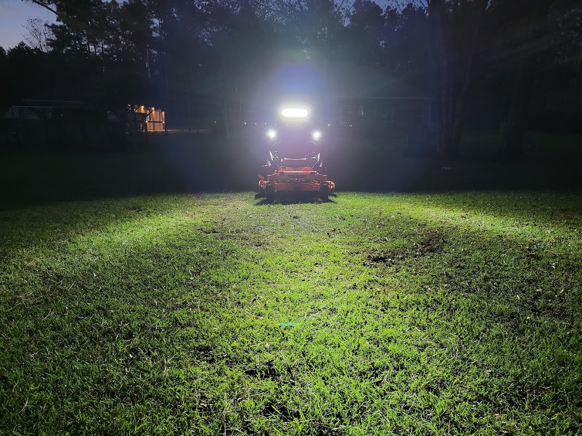

Purchased the Rogue 61 a couple weeks ago, due to all the rain we've had here lately, I have only been able to mow with it once, but I did get lights installed, as my wife often mows after dusk/sundown for some strange reason. Lights were originally purchased to install on my tractor, but used them on the mower instead, will reorder the same type for the tractor.
One thing I have noticed is blade selection seems limited on bad boy in general, let alone the odd 61 and 54 inch sizes.
Oregon blades don't list BB, (I'm looking for gator blades) and Amazon compatibility seems hit or miss, mostly miss. They may say it is for a 61, but measuring the actual blade length shows otherwise. Edit: Went out and measured, blades are 21" so these should work, Oregon 396-727, Gator® G6™ Blade, 21" | Oregon Products and are also available on amazon in 3 or 6 packs. Amazon.com : 6PK Oregon 396-727 G6 Blades Replacement for Great Dane 61" D18036, GDU10232 & Bad Boy Outlaw 61" Cut 038-6081-00 : Patio, Lawn & Garden
Just the initial light test between rain, not specifically aimed yet and lawn not mowed.

Would you mind posting what you actually used for the lights? Looks like you have a lightbar and a couple spots? I have wanted some on my Rogue but didn't want to spend the $250-ish for the BB kit.
Thanks,
Rob
   / Bad Boy Rogue zero turn mower #20
Sure, I purchased this kit, and I didn't use any of the wiring that came with it, so next time (for the tractor) I may see if I can get the lights without the harness and save a few bucks. If not, still cheap, $63
They aren't really 420w, maybe they claim that as non LED equivalent, I measured them just under 10 amps all combined, so 120-ish watts, lots of light regardless.
