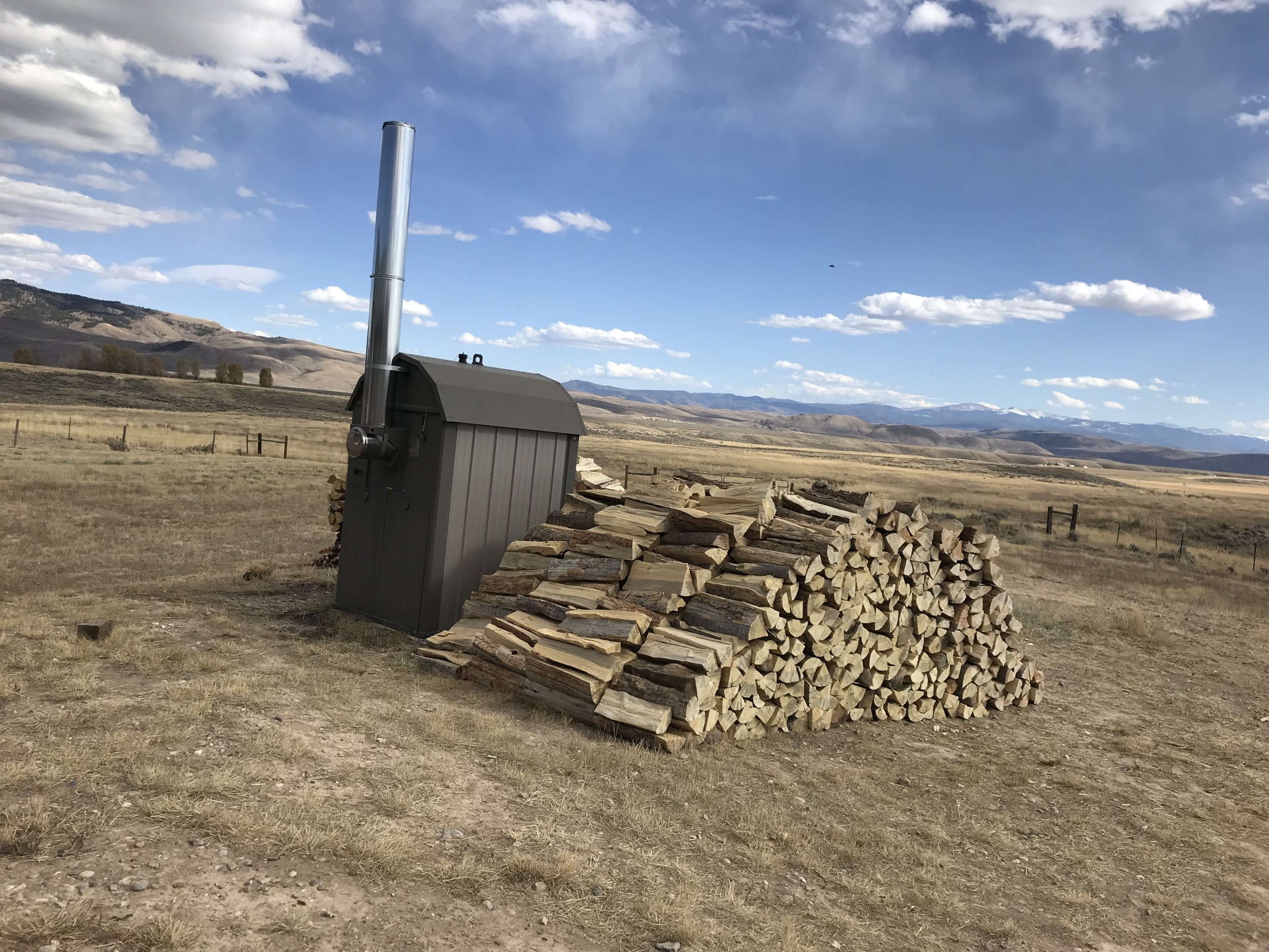

I own an outdoor wood boiler. It is a central boiler eclassic. It is 14 years old.
I would say that 99% of people are not motivated enough to run one. They are sold on the idea you fill it and forget about it. They just don’t work that way. I add wood 2x a day and clean it the first of every month. You cannot leave it unattended for more than 1 day. The more wood you add the more it burns. Everyone that I talk to tells me to fill it and forget. That doesn’t work. Or it is wasteful and inefficient.
Not clean or overfilled it will burn massive amounts of wood. But this morning, temp was 4°F, I added 2 pieces of split pine from a 16” round 24” long. So basically, 1 24” long 16” pine log split into 2 pieces. That will still be there in 12 hours. I will add 4 more pieces for sub zero temps tonight.
I have slowly reduced my total wood usage to about 4 cords a winter. It is very cold here, but luckily this year has been “warmer” as we have only had 20 days of temps less that -20° F and most days have reached positive temps for a high. I think we have had about 15 days that reached over 32° for a high.
But certainly most people will not have the results I have. They do not pay enough attention to what works and what doesn’t.

Its not to far off, 15 years seems to be more common, and its a crap shoot if its cracked or rusted through but same result.
They are not pressurized and open to the atmosphere so lots of oxygen in the system. Adding corrosion inhibitors to the water helps but doesn't eliminate it. They rust from the inside out, heat cycles from the fire crack them and Stainless steel ones don't necessary last longer as it expands/contracts more with heat cycles and cracks.
Most already have a shed prebuilt over them to protect from the weather

Mine is outside…. No protection.
Most people are just not willing to do what it takes. Clean it when it needs. Fill it a little and more often. It sucks to be out there troubleshooting a problem when it is -25°F. Trust me, I know. I try to plan ahead and if it is going to be really cold I clean it in advance. The colder the air it draws in the more it can get an air restriction. Once a little restricted, in a couple of days you might need to completely shut it down to fix the blockage…
I also cut/split wood in the early spring to dry all summer. I slowly am doing less to not have a bunch left over.

20th year on my Woodmaster 4400 not in a shed. Have replaced 2 circulating pumps and a rope seal.
