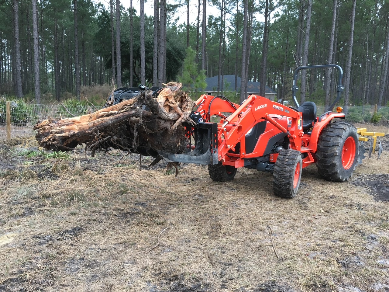

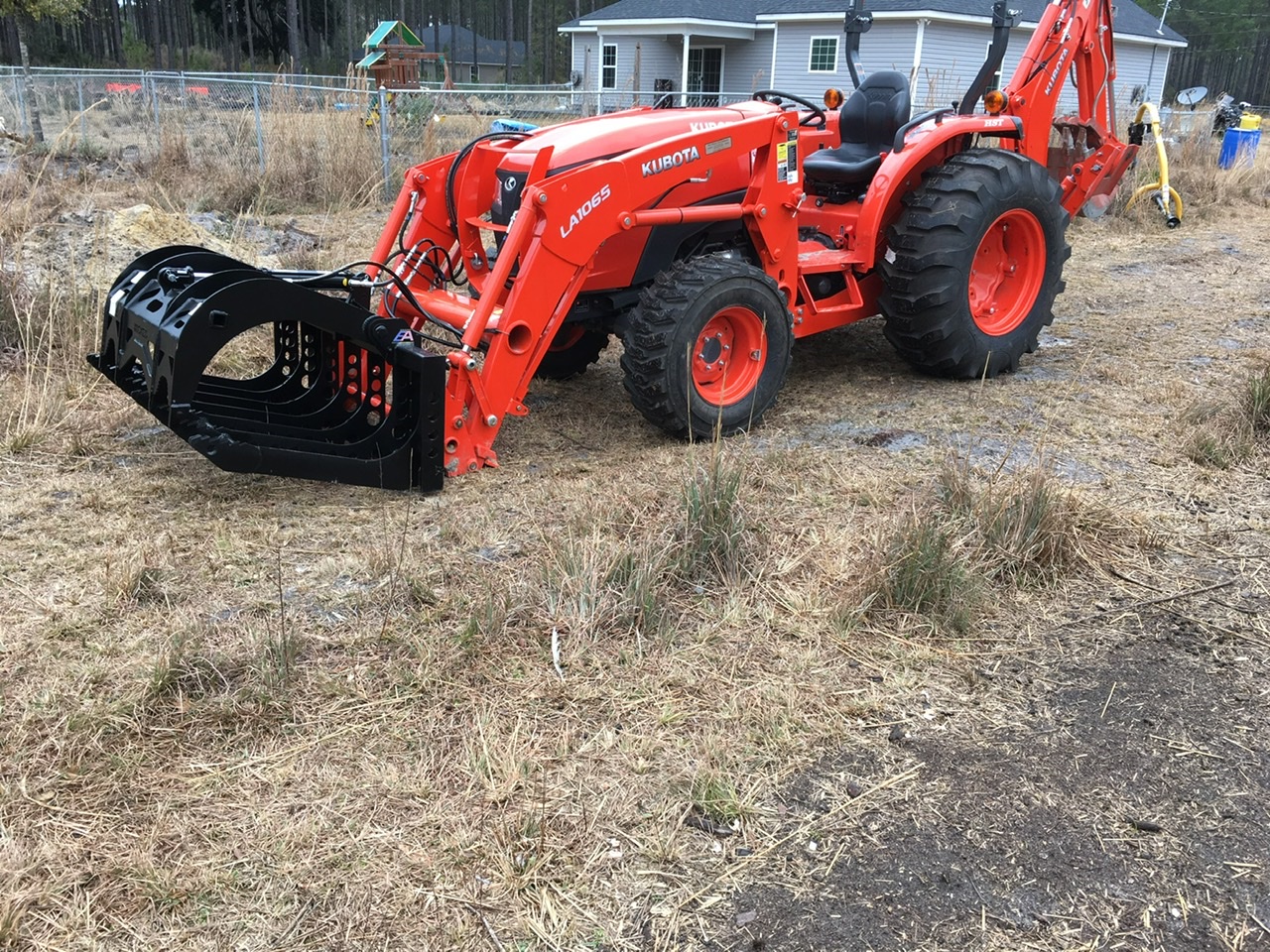

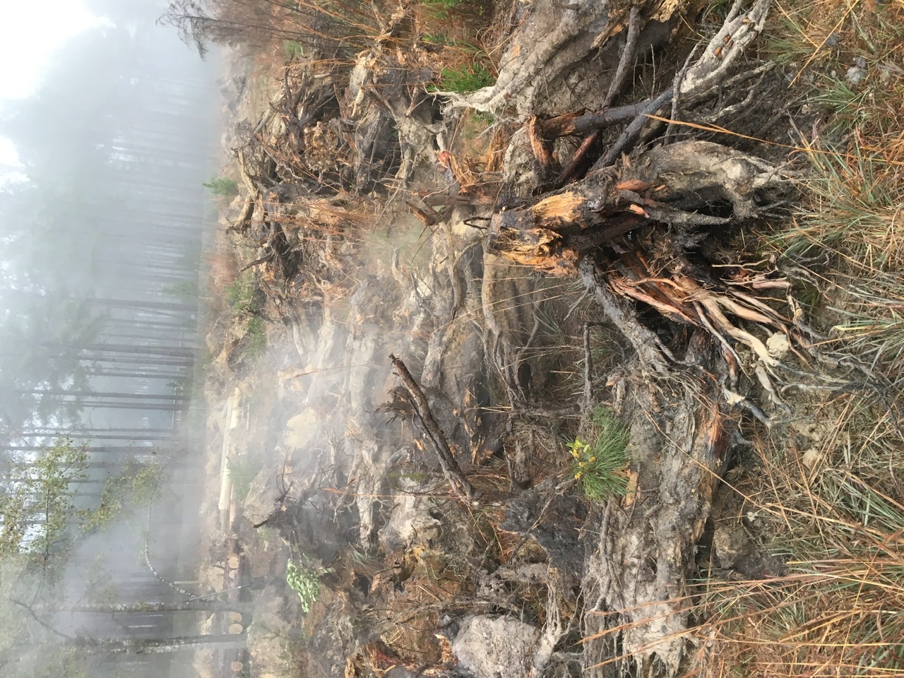

I've got a MX5800 with the hoe and hydraulic thumb and love it. Its first job was clearing 5 acres of harvested pine stumps most between 8-12? I averaged 10 per hour with it in pretty sandy soil. I helped a guy get a really large pine stump out after a storm, maybe a 24 tree and that one I think I had to reposition twice before it popped out, maybe half an hour?

The soil type makes a big difference. How long did it take to do the whole job. Around here in the mostly rock soil it would take a tractor backhoe 15 minutes per stump to get one out. My full size 310 was the minimum size machine I’d consider practical for clearing land and even then for doing 5 acres I’d want a full size trackhoe.
As I said, really sandy so acknowledge it's a lot easier to pop them out of that. You just said it couldn't be done which is hogwash. The whole job...pulling stumps like 3-4 weekends...finishing it out to pasture about a year of weekends:(
