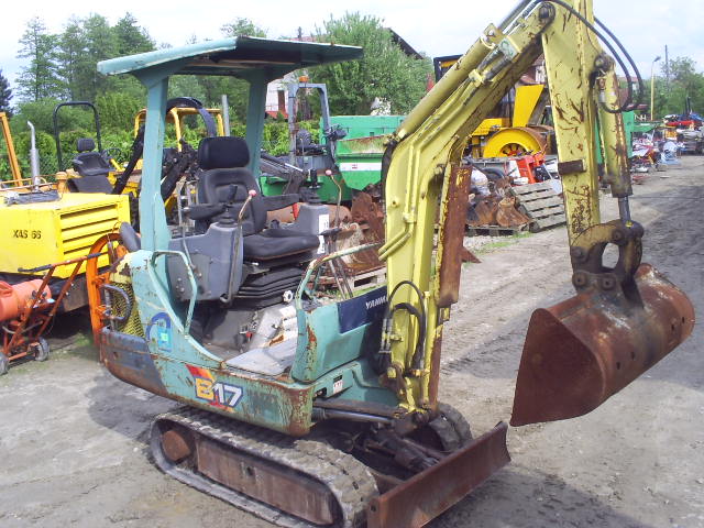

MJ, the little mini-excavators are quite appealing. I wish I could afford one, but they are kind of a one-trick pony for me, and it isn't a trick I really need. It's the old problem of specialization: The mini-ex is specialized at digging holes and trenches, but that's about all. Around here, for what one of them costs I can get a skid steer and backhoe, and have a more versatile package. Of course, I could just pocket the money and rent whatever is needed, but that is much less fun, and doesn't satisfy my urge to have instant gratification when I want to dig a hole.
I just want to clarify that I wasn't speaking badly of 4 point backhoes, or backhoes on tractors in general, or trying to position myself as an expert. I don't own a backhoe and never have, but I've used the 4 point versions on smallish tractors before. Even a light, tiny hoe is vastly better than a shovel, much like a 2wd tractor with a loader is much better than a wheelbarrow. It's my opinion that anything can be broken or mistreated. I also think that the 3 point backhoes have a much closer limit for abuse than other implements do.
