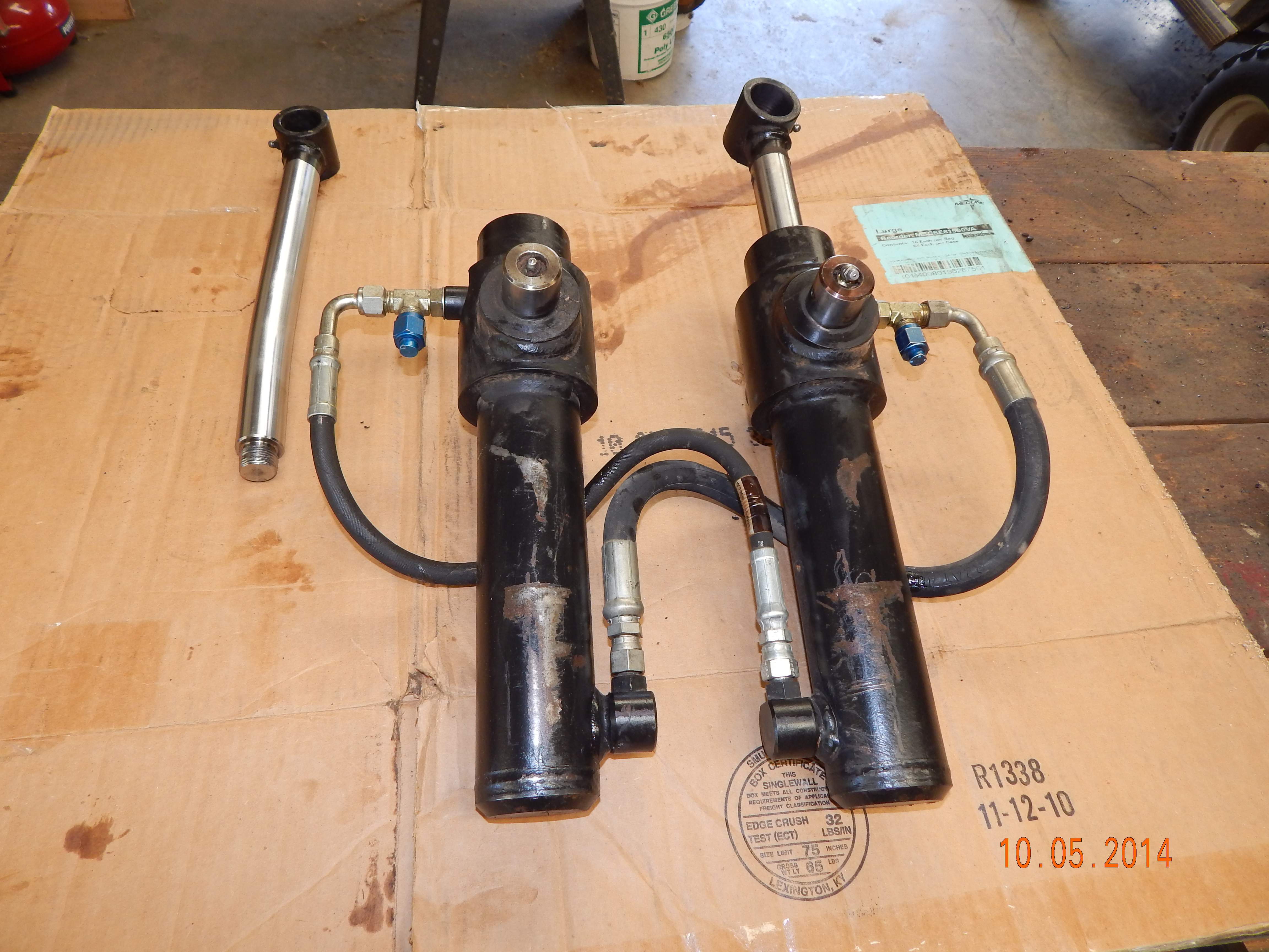

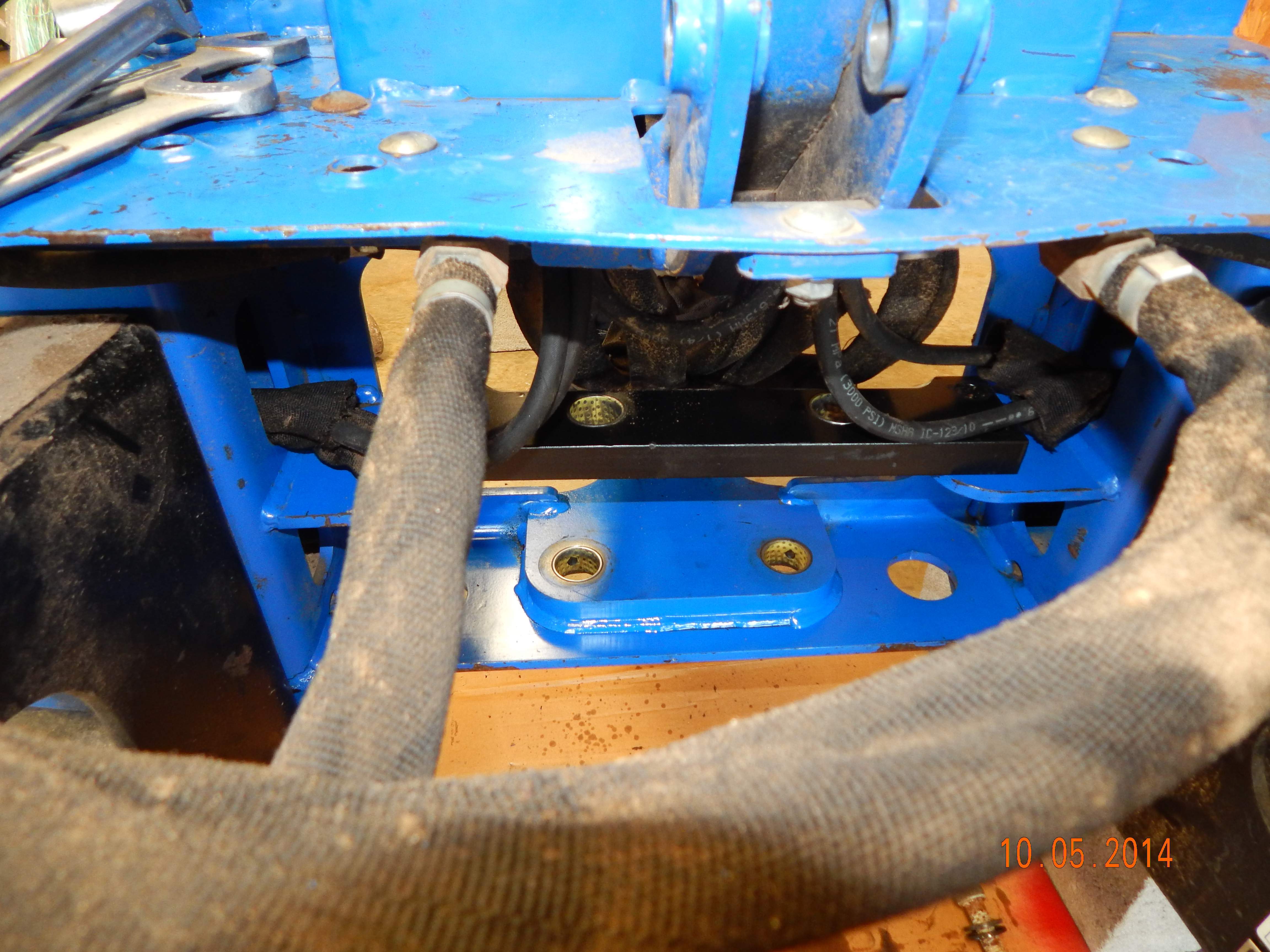

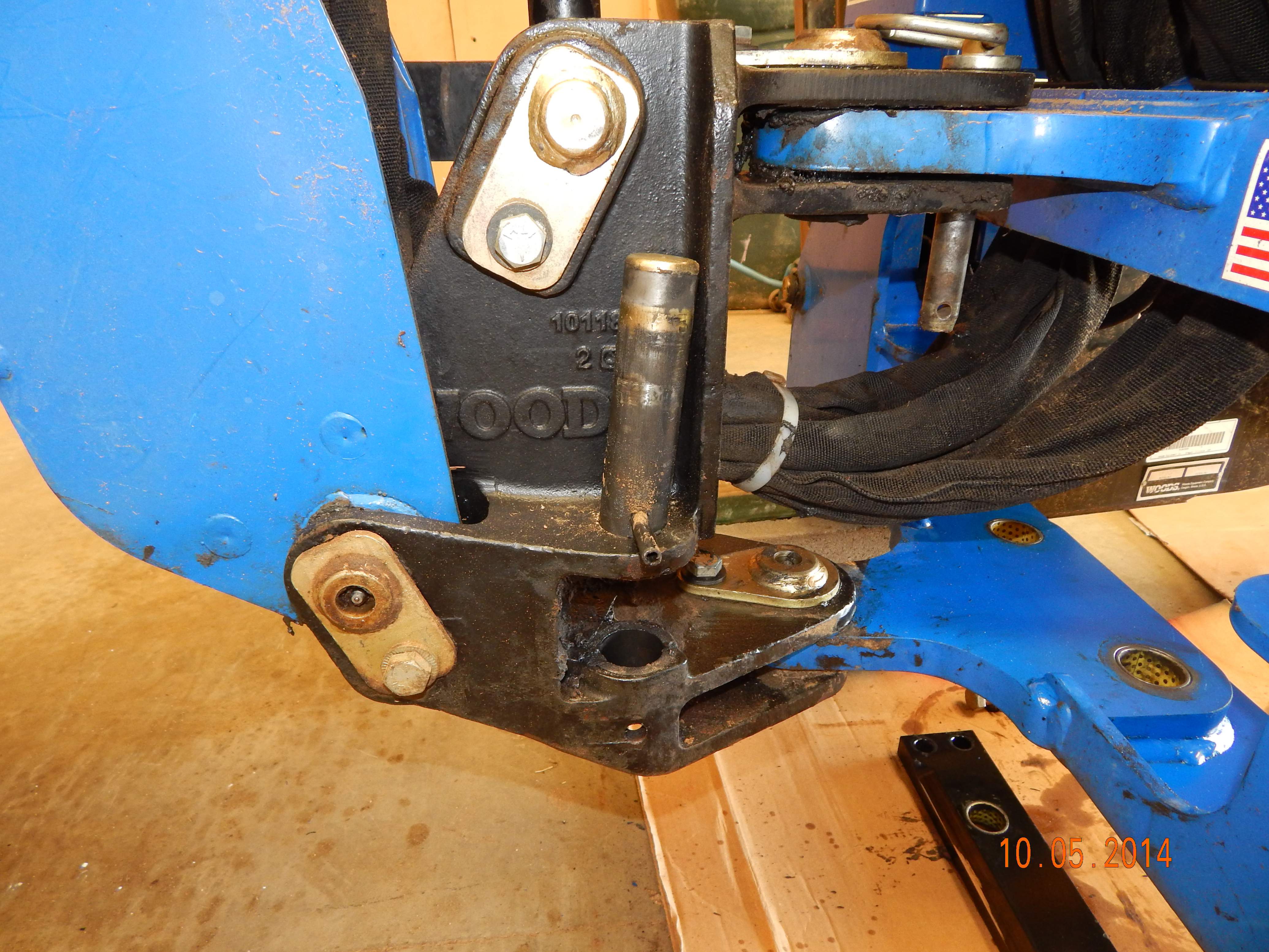

Today's plans got sidetracked so I figgered I'd try to see if I could get a handle on this thing. I put the hoe on the tractor then removed the pins holding the ends of the swing rods on, (pic1) then started the tractor thinking I would then move the stick back and forth and see which one wasn't moving....BUT as soon as I started the tractor I heard woosh - rattle rattle..one of the rods came flying out of it's cylinder volunteering to be the bad one. I got less than a gallon of fluid spilled before I cut the motor. You'll notice (pic2) that it has a bit of curvature and the threads on the end are stripped.....easy enough to figger I need a whole new assembly. Took the whole thing off the hoe (pic3) they are trapped via top and bottom bushings between the blue frame and a black cross member. Hope I can get them torqued back on as tight as the bolts were. I had to use a breaker bar and cheater to break the nuts loose. Guess I won't be able to over torque 'em leaving off the cheater. Being as incompetent a mechanic as I am ... I'm pretty proud of myself getting this far. Course it helped that the errant cylinder jumped out at me. Now all I gotta do is order a new swing cylinder and switch it out..in the meantime the hoe is in the middle of my shop on blocks....oh well.

/ backhoe woe
#11
Not having very satisfying results searching online for this cylinder. Guess I'll call Messicks in the a.m.......est. $300....WOW!
/ backhoe woe #12
consider yourself lucky you don't have an older Case hoe - replacement cylinders for mine, If I could even find one, run $700 to $1000. At that price, if I ever need more than a seal kit there'll be a machine shop involved :rolleyes:
Good job having a hoe that "self-diagnoses"... :D Steve

Mike,
Isn't it nice when the system does the hard trouble shooting for you. 6sunset6 was so right on this. I am glad to see you have the project under control. Rebecca will be coming here next weekend, so I will not be flying by Paige.
From looking at your photos, I see all kinds of room around those cylinders. Mine is so tight with the swing lock control rod coming down from the top. Yours has the room of a 6 cylinder engine in a pickup. Mine has the room of a V-12 packed in under a corvette hood.
hugs<<><><>>Brandi
/ backhoe woe #14
Woods might buy cylinders from some other manufacturer. The rod is obviously bent, but you might try a local cylinder repair/hydraulics shop to ask if its a common size or something they can straighten.
/ backhoe woe #15
I agree with 2many. Take it to a hyd. shop before replacing.
hugs<<><><>>Brandi

#16
Brandi---which hyd shop in Paige would you recommend? :rolleyes: My thought is by the time I found one in Austin that could help me - using the old cylinder - it would likely cost me as much as just ordering a new one and having it delivered to my door. Driving from here to Austin and around is a $40 bill to start with. Because of the bushing mount just any 'ol cylinder won't do.
/ backhoe woe #17
If the cylinder isn't damaged or all scorn up I don't see why you'd have to replace it. They would likely just remake the rod if that's the extent of the issue.
/ backhoe woe
#18
But at what cost? and it will need a new piston as well. The threads that are stripped screw into it. and again-- I'm not local to anywhere that has a shop....Austin would be the closest and no guarantee they even have that kind of shop. A lot of industrial work goes to Houston. Austin is all govt and academia and tech.
/ backhoe woe #19
You might be surprised.
Few years ago I had a badly scored FEL tilt cylinder shaft so I removed it thinking maybe polish and re-chrome.
When I picked up the cylinder the shop has re-welded the cross sleeve, machined a complete new shaft assembled with all new seals etc and even changed the short hose assy. Price was about $150.
Friend just last week blew the end off of his Kubota 7100 tilt cylinder.
A local hydraulic shop custom built up an exact replacement for $300.
From your pics it looks to me as a shaft and kit is all you need.
Check around for a hydraulic shop that has machining capabilities. From observation I think any serious shop has no choice but to have at minimum welding and lathe capabilities plus an inventory of ends, shafting and DOM stock.
/ backhoe woe
#20
OK --- y'all talked me right into it...I'll find a shop in Austin and at the very least take it in for an estimate. I have to go in for my hearing aid sometime this week anyway.....hate big cities...
