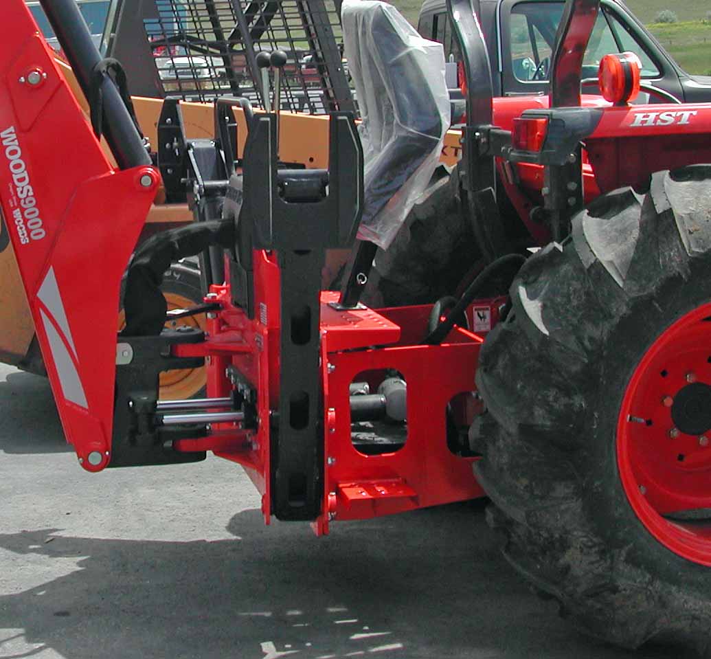

It's a Branson BH760 so it has the Branson subframe. In researching it here some people use the top link to reduce bounce (I assume from the subframe flexing).
/ Backhoe- which size? #15
Old style subframes (mostly under the tractor) really should use the toplink connection for extra stiffness. Modern subframes (so-called 4-point mounts) often do not. In my custom subframes, I sometimes use 4 mounting points PLUS the toplink holes. I don't know what Branson uses. Some of those OEM subframes (both kinds) really stick the hoe WAY out back.

The subframe hooks on the mounts for the lower 3pt links on the rear axle and the front part attached to a frame cross member at the front of the transmission. Bransons have two big bars that go from the axle to the rear of the engine and connect to the loader mount. The BH subframe fits between those. Is this the old style subframe? I've seen pics of Kubota's four point mount and that seems like it'd be easier to get on and off and the subframe would not be in the way when the backhoe's off.
/ Backhoe- which size? #17
That is the old style. I call them "ladder frames". The Kubota 4-point mount is the new style, and they have been around quite a while. These 4-point subframes are more like those on industrial/commercial TLBs, like the B26, L47, etc. The foreward half of the subframe stays on the tractor, while the rest stays on the hoe.
I viewed the video, and that subframe would benefit from the toplink holes being used with a link for stiffening.
Photo is a Kub with Woods 4-pt hoe.
