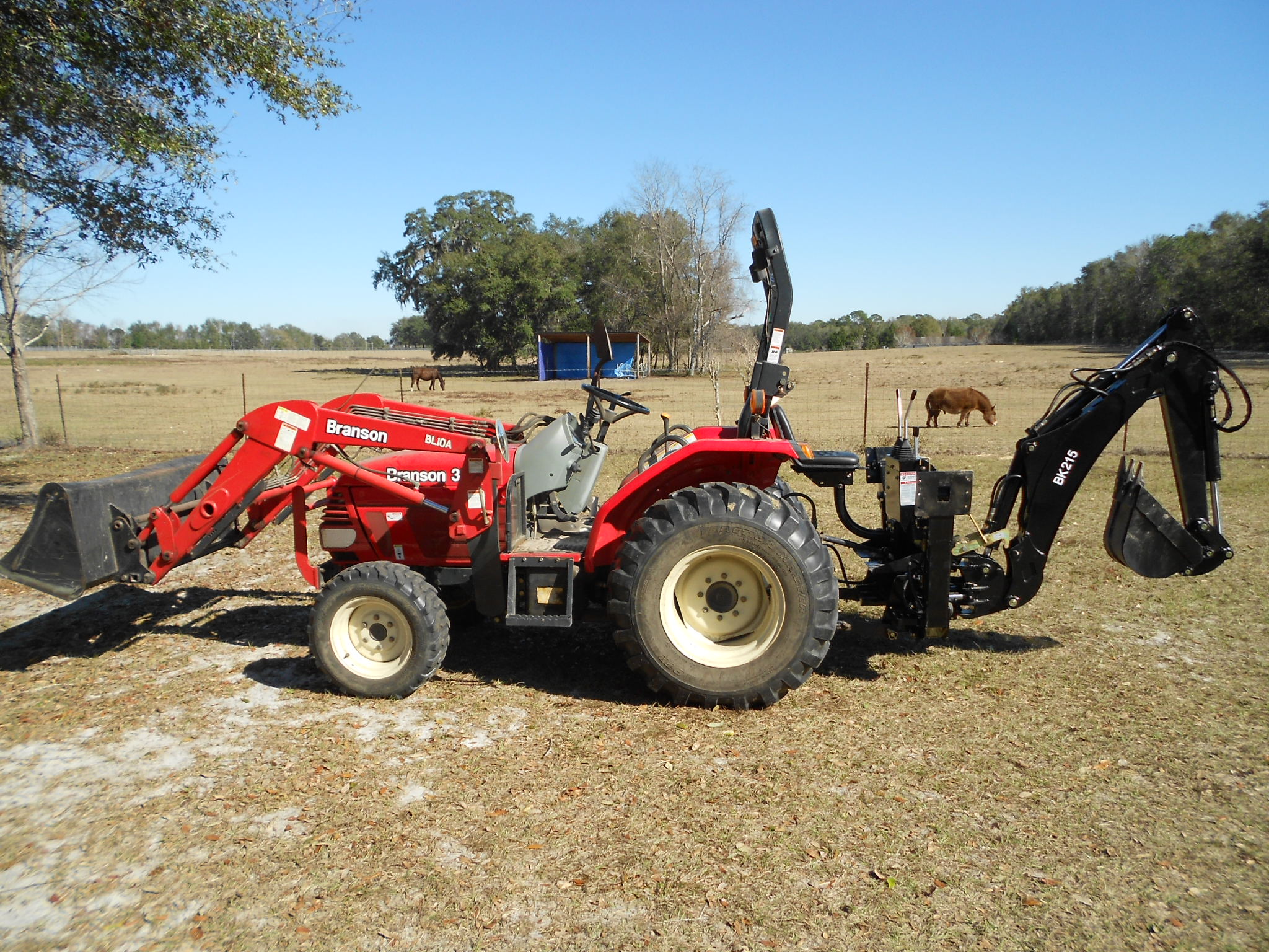

I bought this backhoe from- Titan Attachments - PalletForks.com - 8-65-8241
I bought it a year ago and had to build a subframe for it for my 3510.
If you keep watching their site they are always having sales and they give FREE shipping!
I paid $3400.00. It is very well made.

Thanks all. I'm looking at the Branson units so I can get a subframe. I don't have the skills or time to make my own at this point.
