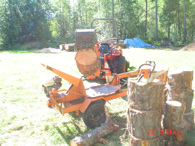

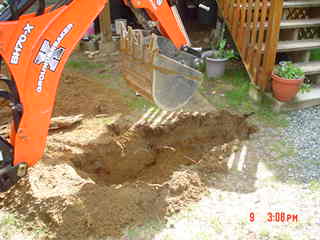

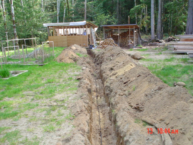

Take your time in learning how to use it. Safety should be at the top of your list. Read your manual, it should have tips in it on how to use it. Greasing it frequently is a good idea; make sure you find all the grease nipples. Enjoy and happy digging. :thumbsup:

Mouse' has become an expert with that backhoe, but we need to ask the homeowner what shape those flower pots were in after Mouse' was finished

OK I did it. :laughing: Nudged the grey one in pic #2. :eek: It was right at the corner of the stairs. He moved it towards the house after that, as you can see its now just behind the backhoe bucket. It was plastic and just cracked the rim but no real damage. :cool:
