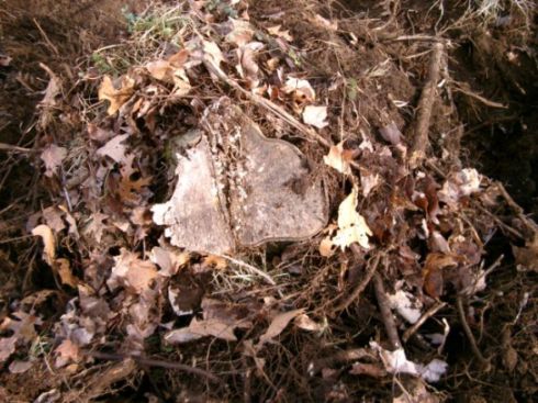

Got a chance to try out the backhoe root ripper recently. Here is the test subject - an approx 8 inch hardwood stump.
John

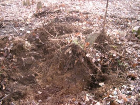

Here is a shot of the carnage that resulted from the battle. Ripper worked pretty well at finding and ripping the roots but it did little for helping to remove the dirt around the root ball.
John

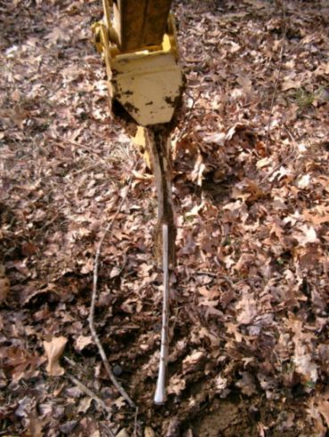

Although the Magnatrac and ripper ultimately won the battle it was not without casualty - bent the ripper holder /forums/images/graemlins/mad.gif
This tool may find its use for ocasional difficult root cutting/ripping or with the other ripper point to break up frozen or really hard packed ground, but my feeling is that it is definitely not better than a bucket for stump removal use.
My suggestion would be to make the ripper like a backhoe sized broad blade pick axe or a small spade (with some hardened teeth on bottom). Shorter and stout is what you want - not long and slender. This would help with dirt removal as you could do some digging. Adding a serated plate or something similar as knife edge vertically right in the center of the spade would help with the root ripping. This would also add reinforcement to the blade so it could better stand up to the punishment of stump ripping.
John
