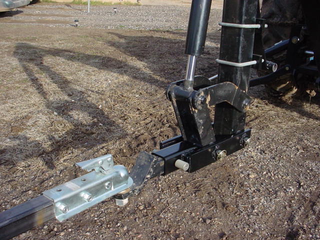

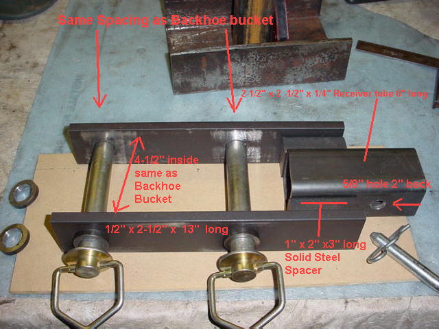

Here is a Saturday project I dreamed up for lack of something better to do. The mud here is REALLY bad so can't do much outside on the homestead so I worked in the shop on this project. /forums/images/graemlins/cool.gif
Please see all the attachments for the complete project.

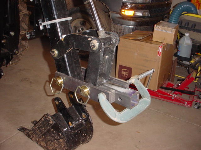

/ Backhoe - Trailer Receiver Hitch & Boom Pole
#2
Test Fit prior to welding
Welded and painted

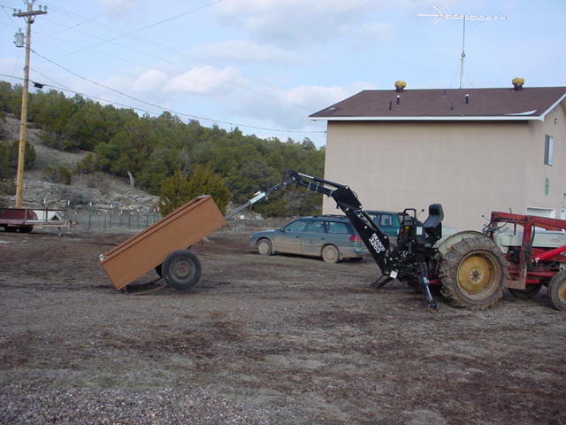

So you might ask why in the world would he want to attach a trailer to his backhoe ?

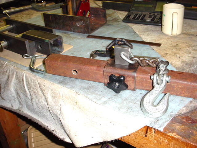

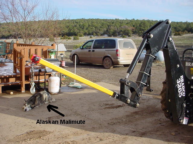

The advantage of having a receiver hitch to the backhoe is that I can make a varity of attachments for it. The possibilities are endless. So Here is the fabrication process for the boom pole.
Boom Pole & Drop chain pre welding & painting

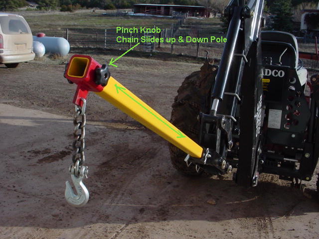

This is a shot of the boom pole welded and painted.

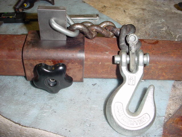

Detail of the adjustable drop chain.

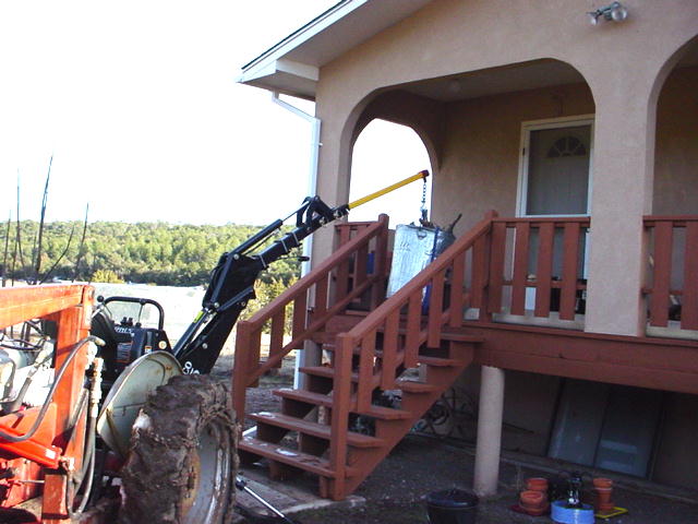

OK so next question is what is this guy thinking?
I need to get wood into my huge house to keep my wife and I warm by the fire.
The main floor of the house is about 5 feet above grade level so there are stairs to carry the wood up. My knees are giving out so this is the mother of all inventions for me. This is a pic of the boom pole lifting up the wood for me up to the back porch.

/ Backhoe - Trailer Receiver Hitch & Boom Pole #16
Nice job, and very timely for me. RonJHall and I were just talking yesterday about doing something similar to my FEL. After beefingup the top of my bucket, I'm thinking of welding some 2 1/2 X 2 1/2 for a reciever for a ball mount/boompole combination. How much weight do you think the pole will handle?
Hey, I've got a Malamut myself, without checking other parts, it looks like you've got a female too. How's she do in the heat down your way? /forums/images/graemlins/grin.gif
#17
The Boom Pole I used is about 4 feet long and is the thin wall (1/8" thick) the one pictured is for light duty ~ 200 lbs max.
Because of leverage and length on a backhoe it would not handle much more weight without exceeding the capacity of the backhoe.
A FEL is a different story - if you use the thick 1/4" 2"x2" tube for the boom pole id say about 6 ' long max you could lift about 600 lbs without bending the pole.
However keep in mind that because of leverage the force on the receiver tube is going to be multiplied by the length & weight of the boom pole ie 6' x600 lbs = 3600 lbs of bending force at the receiver. So in this case shorter is better. The horizontal pulling capacity would easily exceed 5000 lbs.
The Malamutes we have 3 of them 2 Males 1 Female they actually do pretty well we are at 7000' elevation so it does not get that hot up here in the foothills of the Manzano Mountains.
Winter seems to last 6 monts gets very cold at night and we do get a fair amount of snow.
