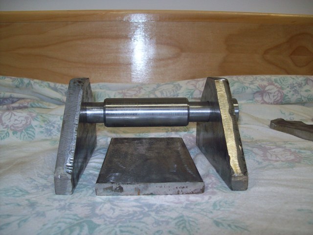

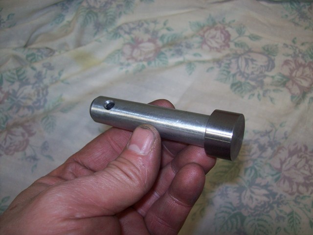

DOM=drawn-over-mandrel
I keep on hand 2 sizes: .750" ID, and 1.000" ID, both with .25" walls
It is pricey stuff, about $1/inch, depending on where you get it. If you
can't find it in your area, buy it mail-order.
I use this stuff for pin bushings (see photo). You need pins that have
.010-.015 grease clearance, so I often use 25mm rod stock with the
1.000". In the photo, I am using a piece of DOM tubing to align my
holes for welding.
I also use the .750 for CAT 1 pins, which are not greased. CAT 1 pins
fit tighter, so weld heat management is tougher.

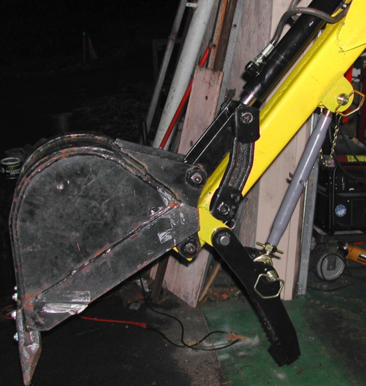

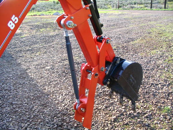

When I set about to fab my thumb, I called the BH (Rhino) Mfg. They said welding onto the stick would void the warranty (heat).
I bolted.

/ Backhoe Thumb...weld or bolt? #26
Nicely-made brackets, RFB. Some have found that the bolted brackets
will slide on the dipper under the force of use.
Your 85 bkt seems to be of the older non-curved style. How long IS the
warranty?
/ Backhoe Thumb...weld or bolt? #27
df,
Thank you.
I did this when it was about 1 month old, and the warranty was 1 year. Rhino said that they were concerned regarding the welding heat on the stick.
I thought about slippage, and that is why I imagineered the upper plate to rest against the weld boss of that diamond shaped gusset plate. If it were to slip, the force vector is up towards that gusset, and it would have to spread the bracket to climb the weld boss. I also used right-angle partitions on the brackets to preclude any leverage induced angle shifting. I used grade 8 hardware throughout.
RFB

/ Backhoe Thumb...weld or bolt? #29
I went back to look closer at your photo and I see what you are talking
about. Excellent idea, RF. Some folks underestimate the 1000s of lbs
of force experienced by the upper bracket.
BTW, I doubt that ServisRhino used any exotic steels in the dipper...it
is probably just A36.

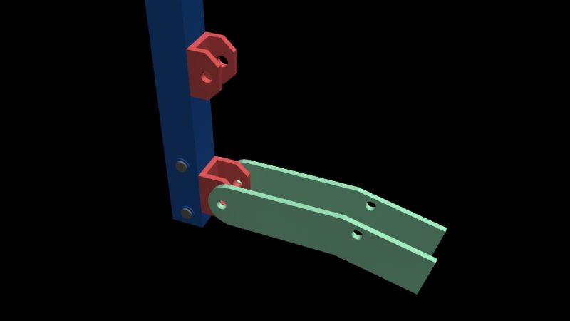

Thanks for the tips. I'll be TIG welding most of it, so it will have time to get pretty hot :)
Welding is part of my vocation, but I very rarely weld anything thicker than 1/4", I do mostly light industrial stuff, custom shelving, brackets, funiture etc.
I'll be MIG'ing the stuff to the dipper, .045 "outershield" wire....so there could be some more tweaking there...although I'll probably "box" the brackets a bit with some 1/2" plate to try to keep them stable.
Below is a basic image of what I have planned.
My largest drill bit is 1 7/64, so I was thinking I'd work up to that, then use the boring head in the mill to take it out to exactly the fit I want. Or maybe drill, then weld, then put the whole bracket in the mill and align bore the holes...assuming my boring bar is long enough.
The dipper is only 3" wide...not going to be a lot of room for bushings. A Cat 1 top link is 1.5" wide at the pivot, so 3" minus the two 1/2" plates leaves 2" between them, or 1/4" of free play on either side at the top end of the top link. At the bottom I may offset the side plates outside the dipper to get more width for stability at the hinge (an idea not shown in the image)...so bushings will be called for there.
Before I start I'll tweak the images and submit for final comment :)

Johnny, the bracket you weld near the end of the dipper is mounted
to some pretty thin steel, so you may want to have it wrap around the
dipper so the tension forces do not distort it.

Yep, that was a worry of mine. Do you think wrapping some 1/4" flat around there would be enough? I'm thinking the 1/2" would be a bit much. Maybe just some side plates to sandwich the dipper?

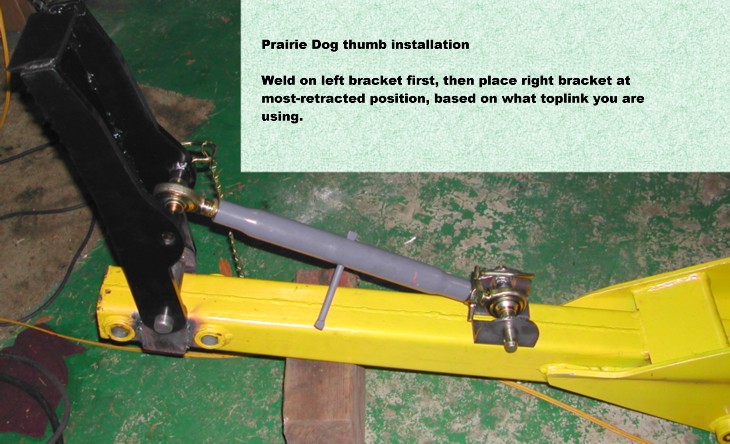

Here is a photo of the parts for one of my mechanical thumbs....I put it
in the form of a kit for the last guy I sold it to. The dipper bracket for
the thumb pivot is just 1/4" steel, but it extends along the sides all the
way to the other side of the dipper. Forces are distributed along the SIDEs
of the dipper, and the welds are in shear, not tension. 1/4" is strong
enough, but thin enough to install below the level of the other 2 dipper
pivot hole bushings, which sit proud of the surface by maybe 5/16-3/8".
That way, the bucket action does not hit the thumb bracket. All of these
(six total) have stood up well. My dipper is only 3/16" thick!
The photo is from one of my thumb threads....you can see the dipper
bracket welded at the lower left.

Yep, I should be able to squeeze some 1/4" between the bucket pivots and sandwich the dipper as shown in your image. Same issue on my dipper..it's 3/16" too.
Better safe than sorry, I tend to abuse things.

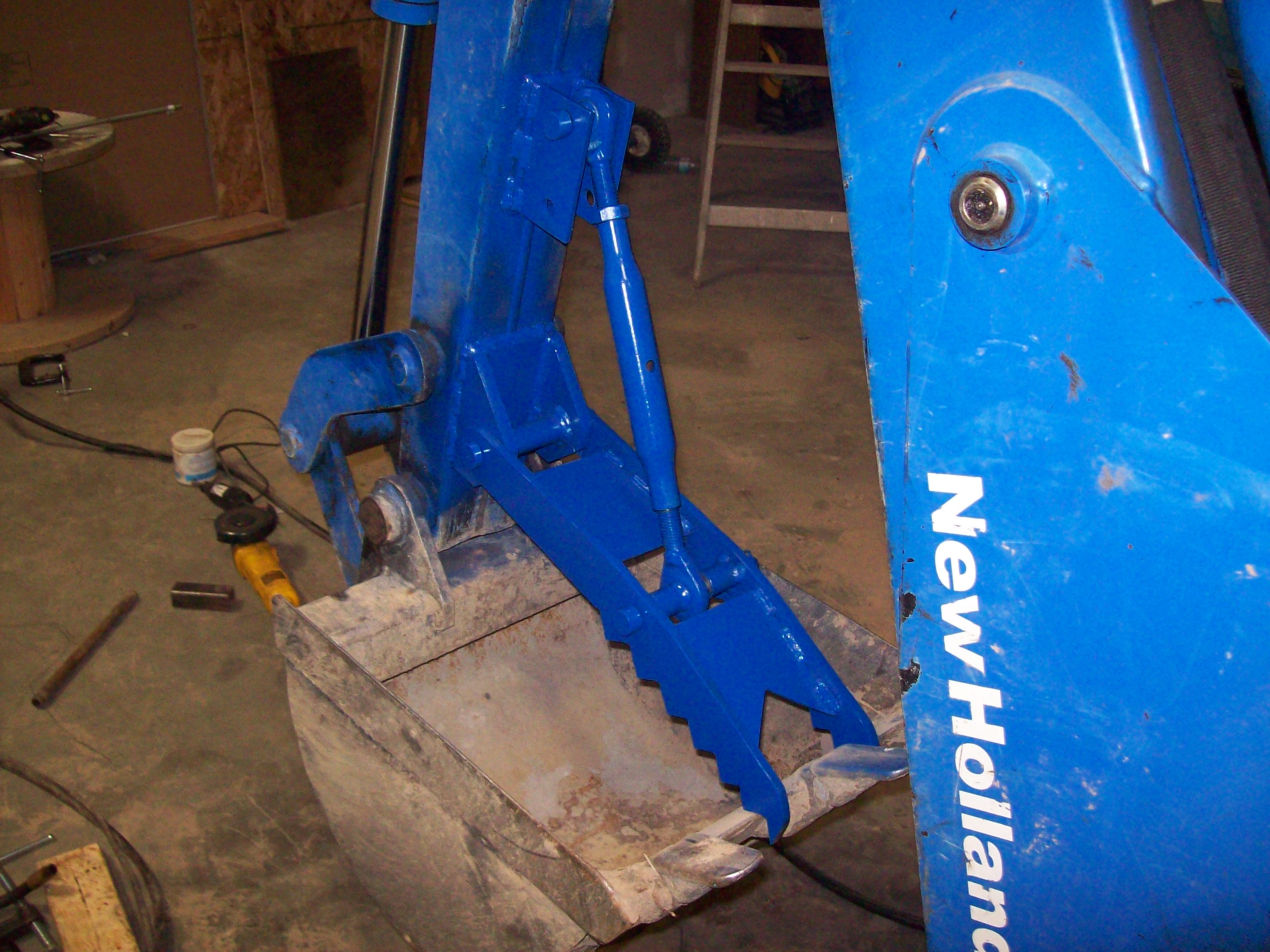

I agree with dataway......everyone is "hard wired" different, I get way more satisfaction out of building rather than buying, however as dataway said there are times it doesn't make economic sense.
I haven't used may thumb very much to give much input...however I have been digging in the frost for the last several days, That bottom thumb mount takes a beating, soooo........ make it tough or you will bend it!!:) The cross tube for the pin adds a lot of strenght, so far mine has done well.
