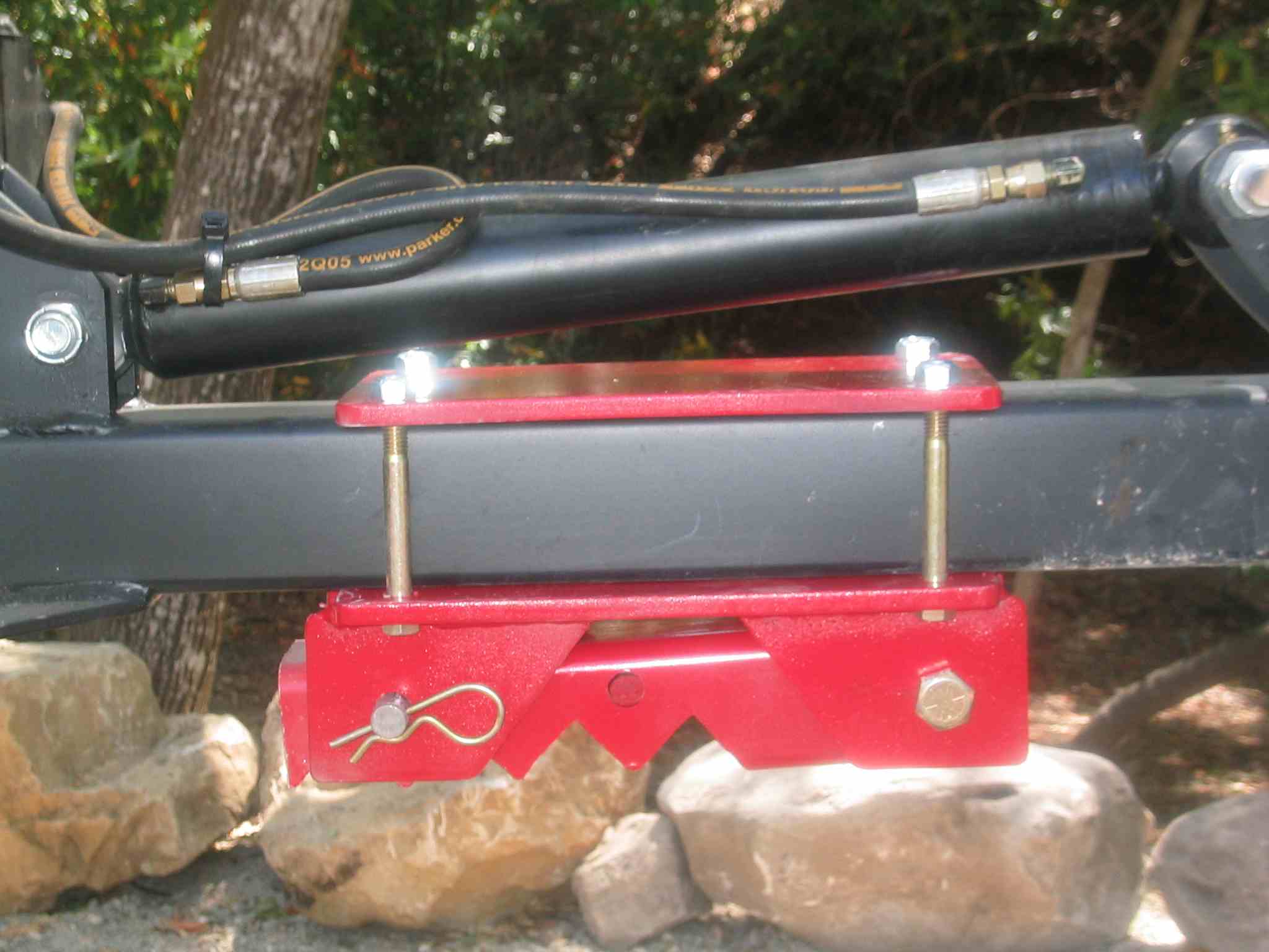

I haven't done mine yet, but when I do, I'm going to mount the thumb on a plate with four holes drilled in it, two on each side of the boom. Then, I'll place another plate on the opposite side, sandwiching the boom in between and use some long bolts to hold the two plates together.
I want to be able to remove/reposition it, just in case.
/ Backhoe Thumb...weld or bolt? #10
...like this one

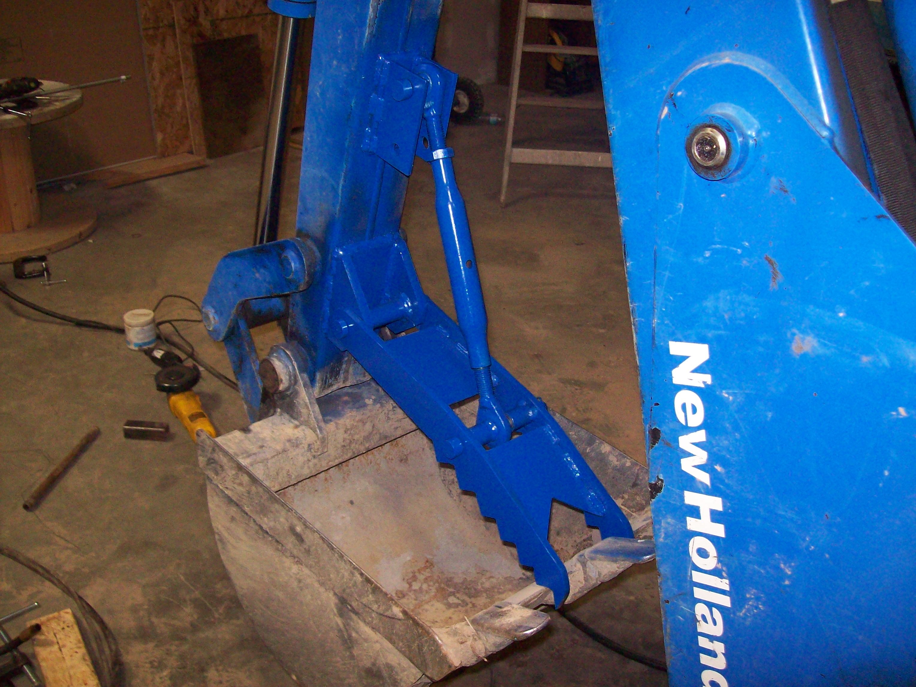

I considered both options, in the end I chose to weld it on, it didn't weigh as much and it was simpler.

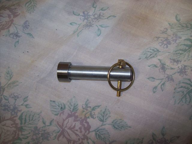

Pilot...have you got your 1" pins running through bushings there?
If so, what did you use for bushings? I'd rather not have to make something up on the lathe...anything off the shelf with a nice enough fit?

I made 7/8" pins with my new lathe (for the practice) I didn't use any bushing material as they won't be roatating except for when I fold it up, therefore I didn't see much value. I'm going to drill the pins for grease zerks mainly to keep the rust down in the joint, if left on for long periods.

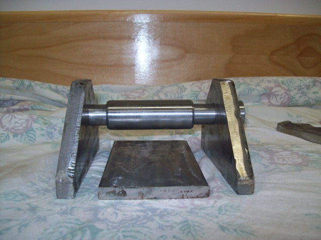

Bushings was probably the wrong word...it looks like you have sleeves covering the pins in areas between the thumb halves.... the sleeves look to be welded to the inside of the thumb halves and the pins slide through them. It appears you have the sleeves limiting the side to side movement on one end of the link rod. I'd like to do a similar setup.

sorry ....They are made from heavy wall tubing that I bored to the correct size for the pins, here is a pic just prior to welding the main mount.

Thanks pilot...just what I needed to know.
