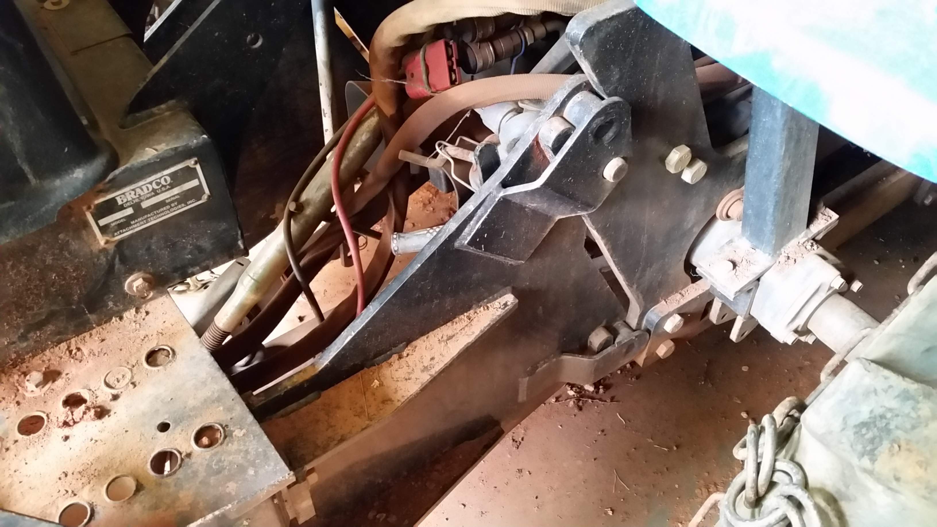

Here are a few better pictures of the 'donor' mount I'm using for reference in my build:
The 4 point style are easier to hook up because you don't have to stick your head under the tractor to try to line the long ladder frame up to fit in the FEL cross member slot.
You just backup to close like you do when connecting/disconnecting FEL. You mess with the controls until you set the 4 pins in their cradle ... can all be done standing at the rear of the tractor.
Not quite as easy as that. The issue with 4pt mounts is that all 4 contact points need to be lined up at the same time in 3 dimensions. Not terribly easy even after hooking up hydraulics and controlling the pitch and height of the BH with stabilizers and then backing into the BH. You can only control the BH height and pitch while off the tractor and can only back up the tractor while on the tractor. Not always simple. And, with the Woods, you hook the bottom pins into slots but the top pins are actually bolts that pass through the subframe so need to be lined up nearly perfectly in order to pass the bolt through and then attach the castle nut. You cannot just persuade it though the hole with a hammer as you'll strip the threads.
The advantage of the other style is that you can back the tractor over the subframe, use the BH hydraulics to raise the front part of the subframe to the right height (not nearly as fussy as with 4pt) and then back the tractor on to the front mounts and then adjust the rear mount height before backing the tractor to secure the rear mount. Two steps but each step is easy. I never had to stick my head under the tractor either. Yes, you need to judge where the front part of the subframe is as you raise it but you can do that from the side. Once you have the front mounts lined up and in contact, the rear mount just slides in and you use tapered pins to lock it in place. The tapered pins can be whacked with a mallet/hammer to make the final 1/4" adjustment.
I remember mounting the Kioti BH in 5-10 minutes most of the time. The Woods routinely takes me a minimum of 15 and sometimes double that.

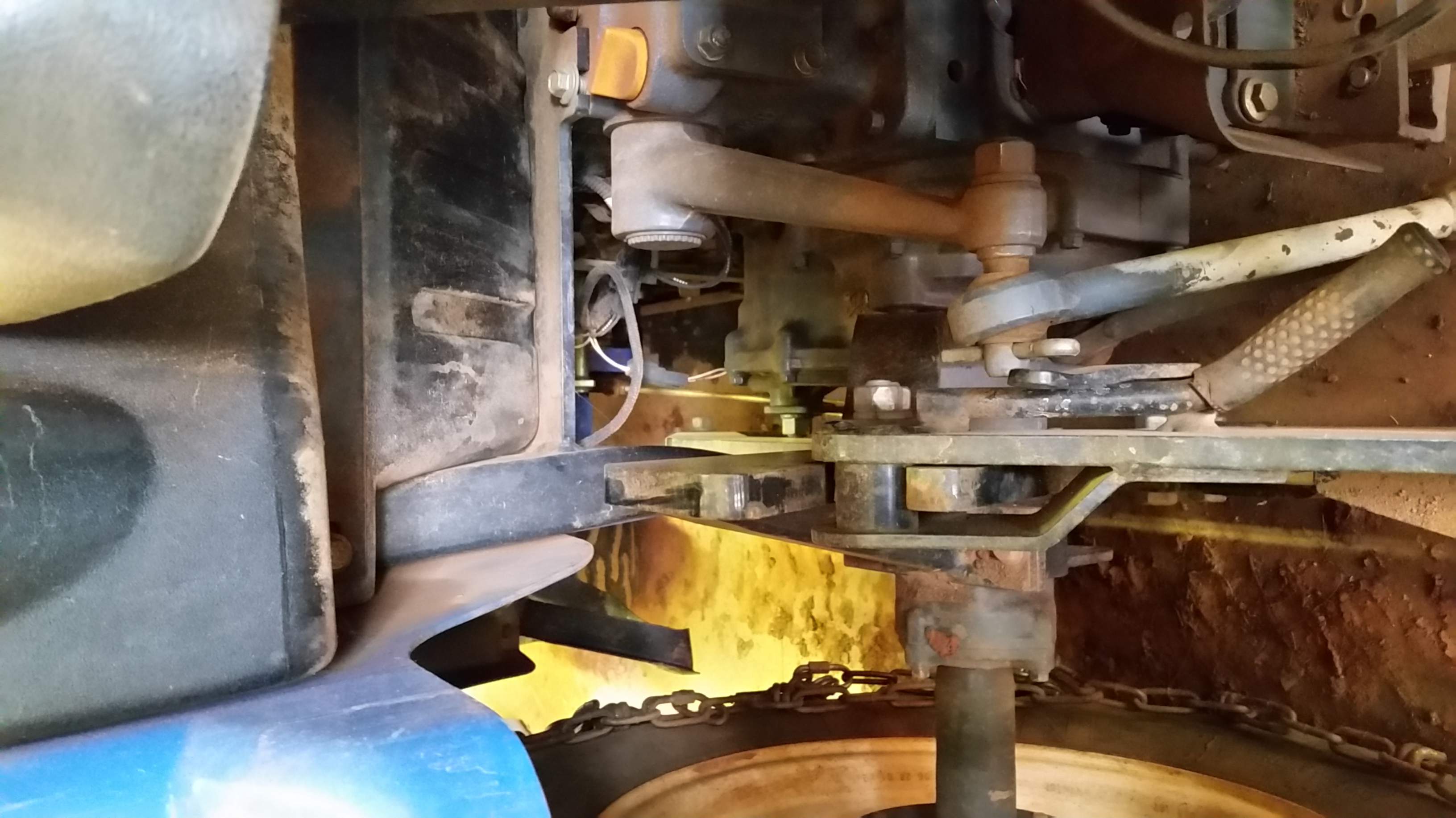

Yes. Here is a post I made last week in response to someone who was trying to build a subframe for a Kioti. The photos show from various angles the portions of the subframe that are attached to the tractor and those that are attached to the BH. If you look at all the photos I think the story will be clear. Note that all the gray metal below the PTO is part of the subframe attached to the tractor. There is one shot of the BH dismounted and you can see the ladder part that slides into the slot on the tractor mounted subframe to be pinned in place. I know exactly where they are so I can see the holes where the pins are inserted but I admit it doesn't show well in the photo.
http://www.tractorbynet.com/forums/...ioti-backhoe-subframe-mounts.html#post4236522

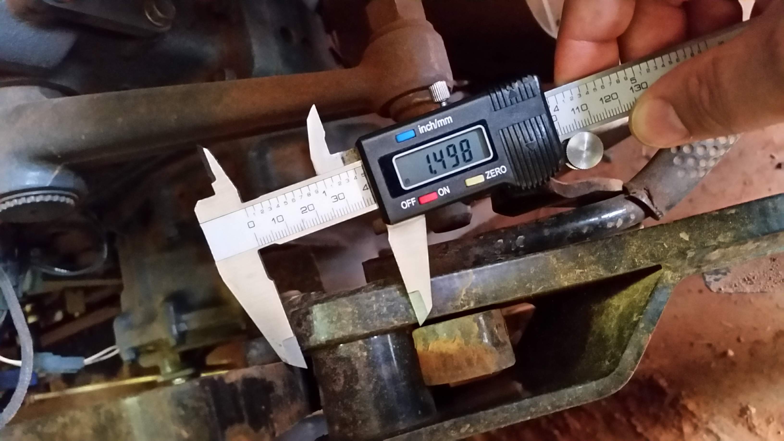

The Deere 448 backhoes use two plates mounted to the transmission housing and ROPs mounts. Once the 3PH draft links are removed, the 'hoe is lifted with the rockshaft lift links, two pins (each about 1.5" in diameter) are installed through the 'hoe frame and tractor mounted plates. The lower 'hoe frame sets in two slots in the tractor mounted plates. After all that, the lift links are lowered and the backhoe hydraulic hoses are plugged into the tractor's hydraulics.
It's a pretty robust and the stresses seem to be well distributed.
The manual doesn't specify it, but the illustrations indicate the stabilizers are to stabilize, not lift the tractor. I've only used my backhoe once, and that was just to try it out (I didn't buy the tractor for the backhoe...backhoe was just part of the deal) and all four tires were on the ground.
