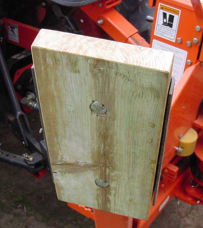

   / backhoe stabilizer pads #9
I made a set of pads out of treated 2" x 10" for my BL4690. Used carage bolts and wing nuts for fast on/off.
See photos.
ksmmoto

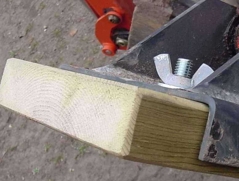

   / backhoe stabilizer pads #10
Another Photo.
ksmmoto
