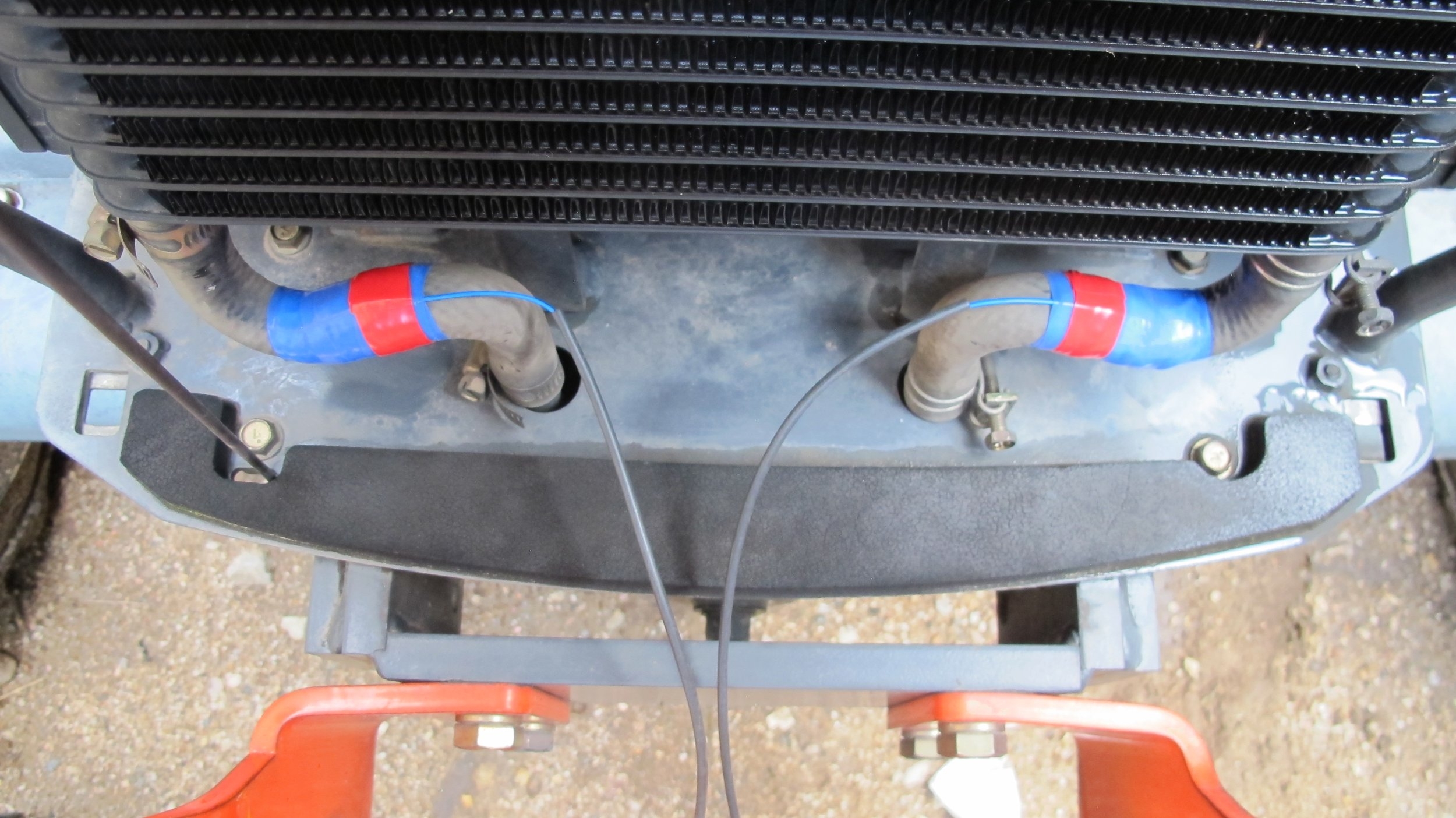

I would think lower temperature probe would identify the outlet. I wasn’t exactly sure which side either.

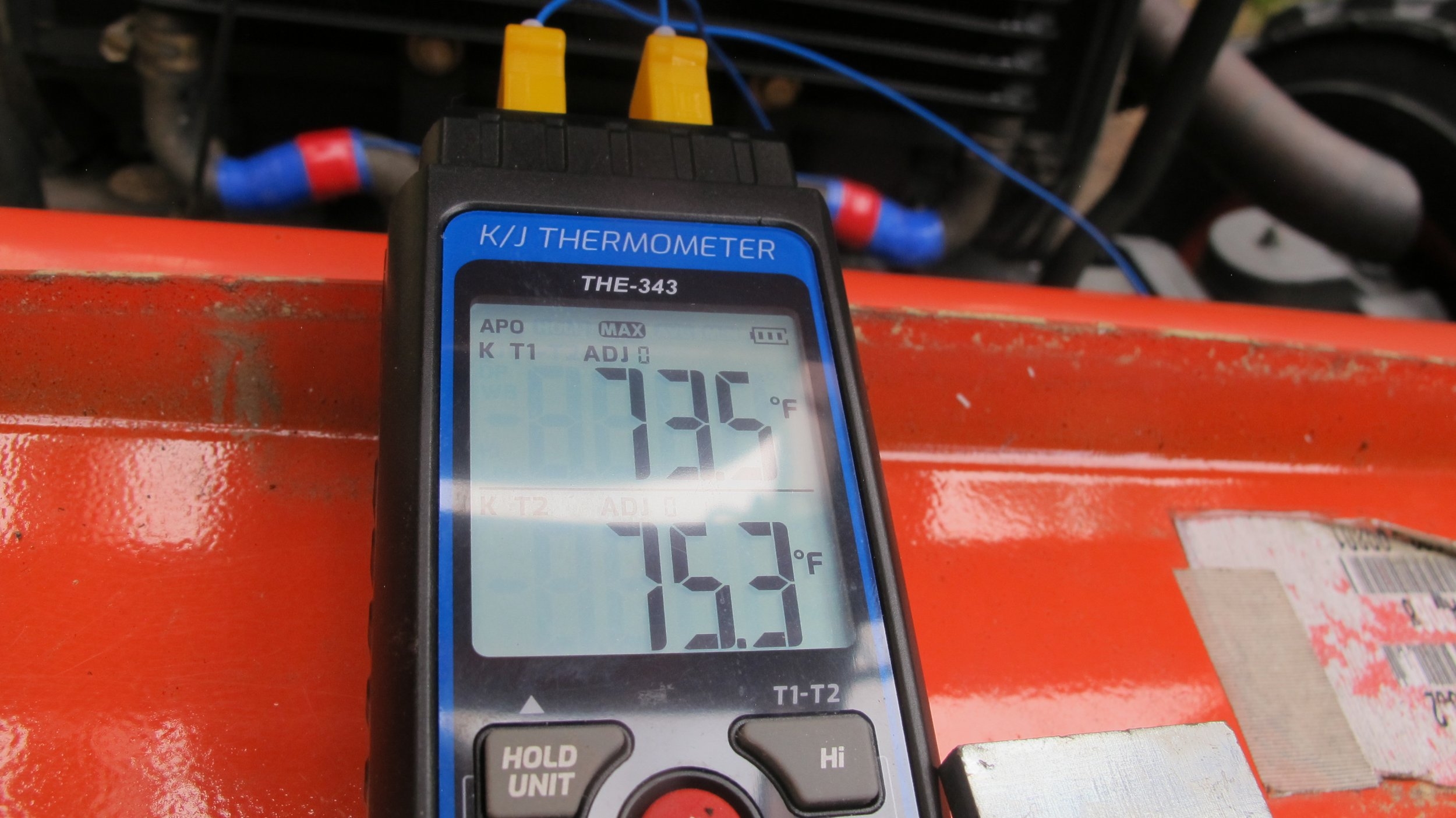

I'm not even sure that hydraulic cooler has a specific output. Can you tell?? I just cannot tell from Kubota's schematic. Does the flow through the cooler depend on whether the power steering is being used??

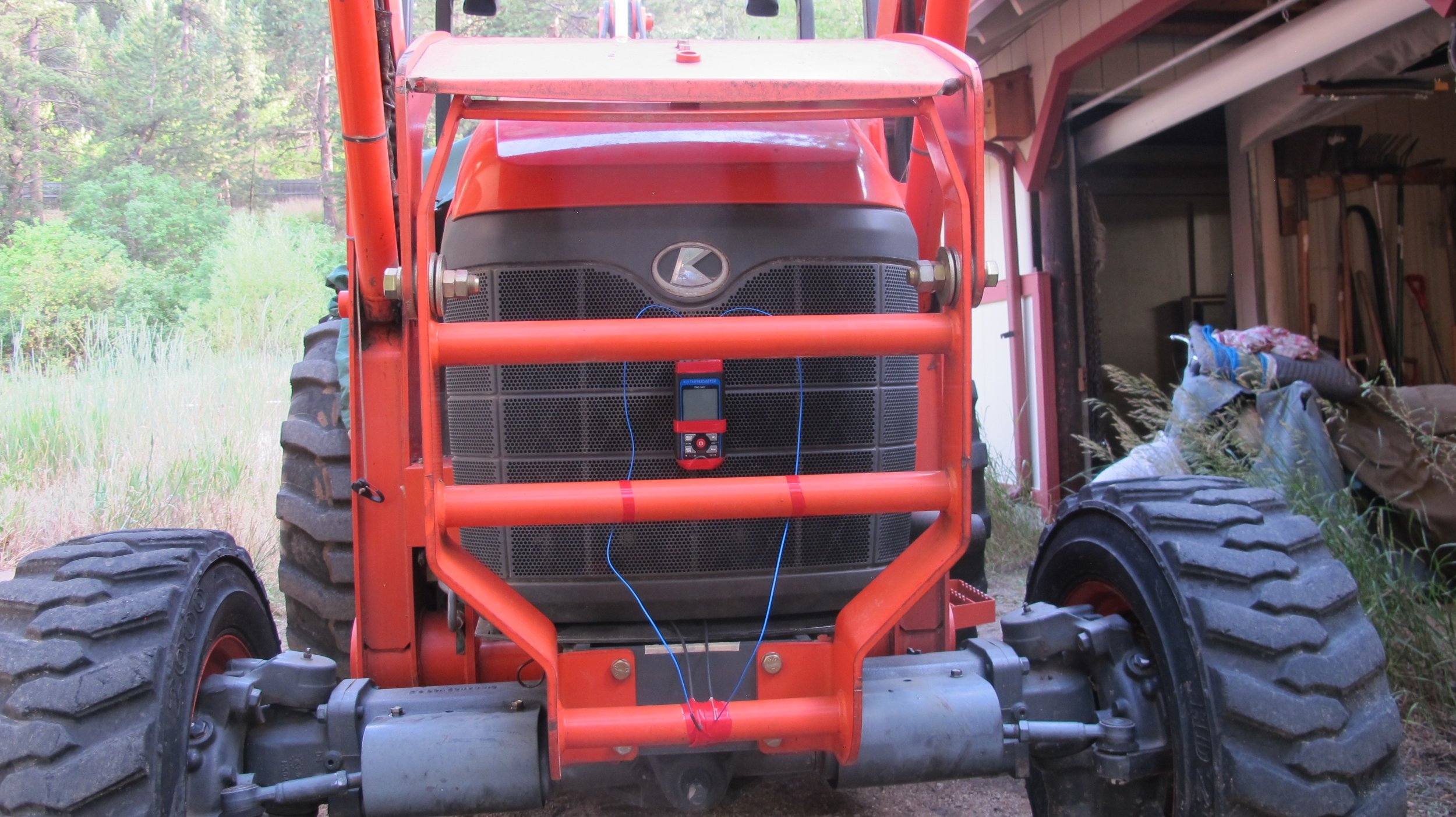

I thought I could tell by the temperature difference too. But so far I only get a couple of degrees difference, and that could be due to anything...probably heat transfer through the mastic. I'm thinking I may instrument the backhoe separately just to see if it is different. It's cheap enough to do.

I don't know much about the state of IR gun technology. I haven't tried an IR gun since about 5 years ago when I bought several and tested them. At the time, they were not even close to what I measured with a contact type thermister. The guns were not repeatable on metal, and slightly better on non-metal surfaces - but not good enough for absolute temperature. Maybe since then the IR guns have solved their emissivity/reflection problem - or whatever their problem was.

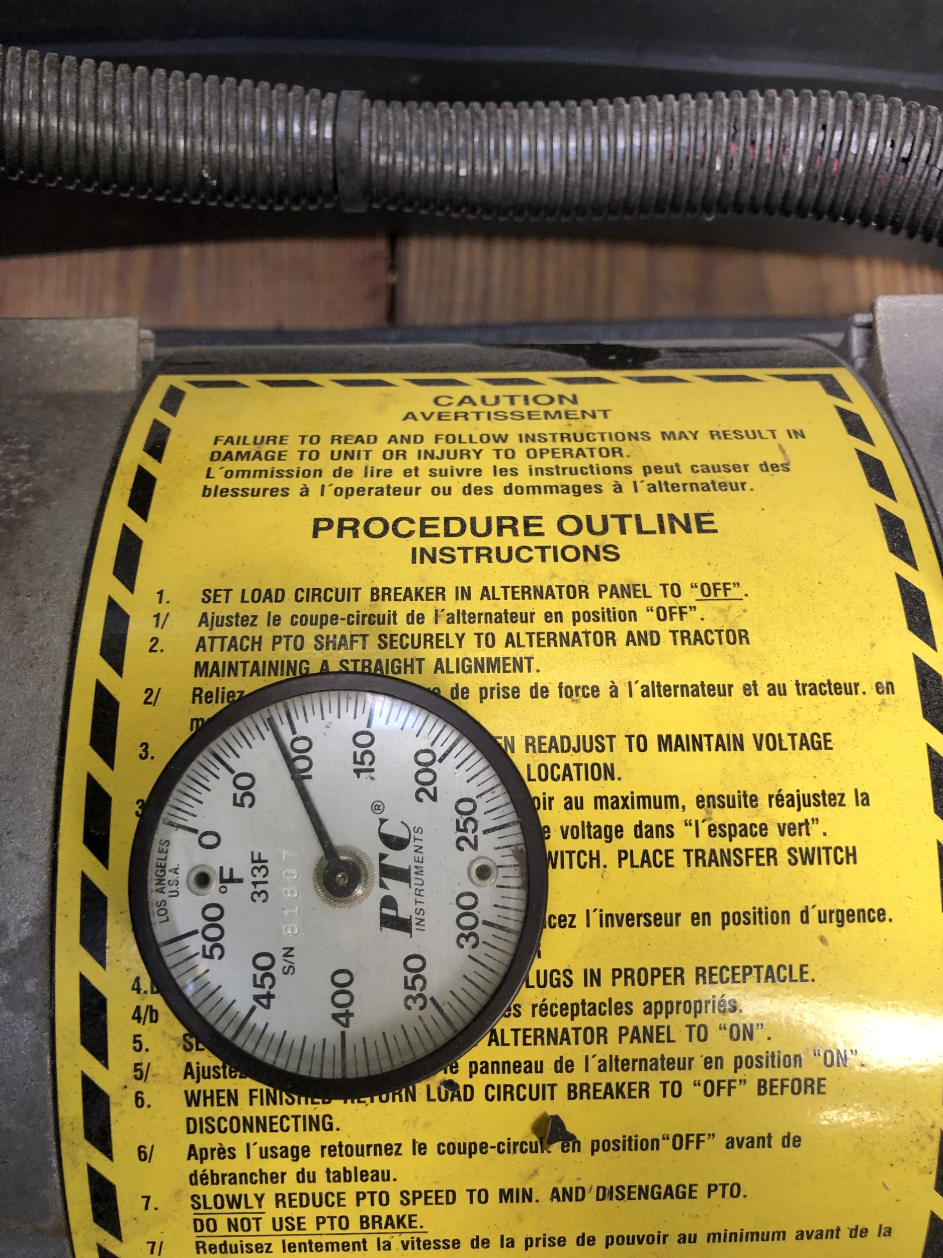

Understand getting good representative temperature measurement. All methods required some technique. Do like magnetic simple bimetal coil thermometers for things like motors, metal pipe or cylinders in the temperature range we are dealing with.

Now you have a mechanism to read temperatures and could see how driving around compares to backhoe operations. We will have you looking more like a space shuttle than tractor soon.

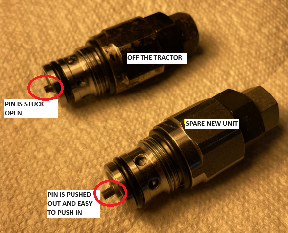

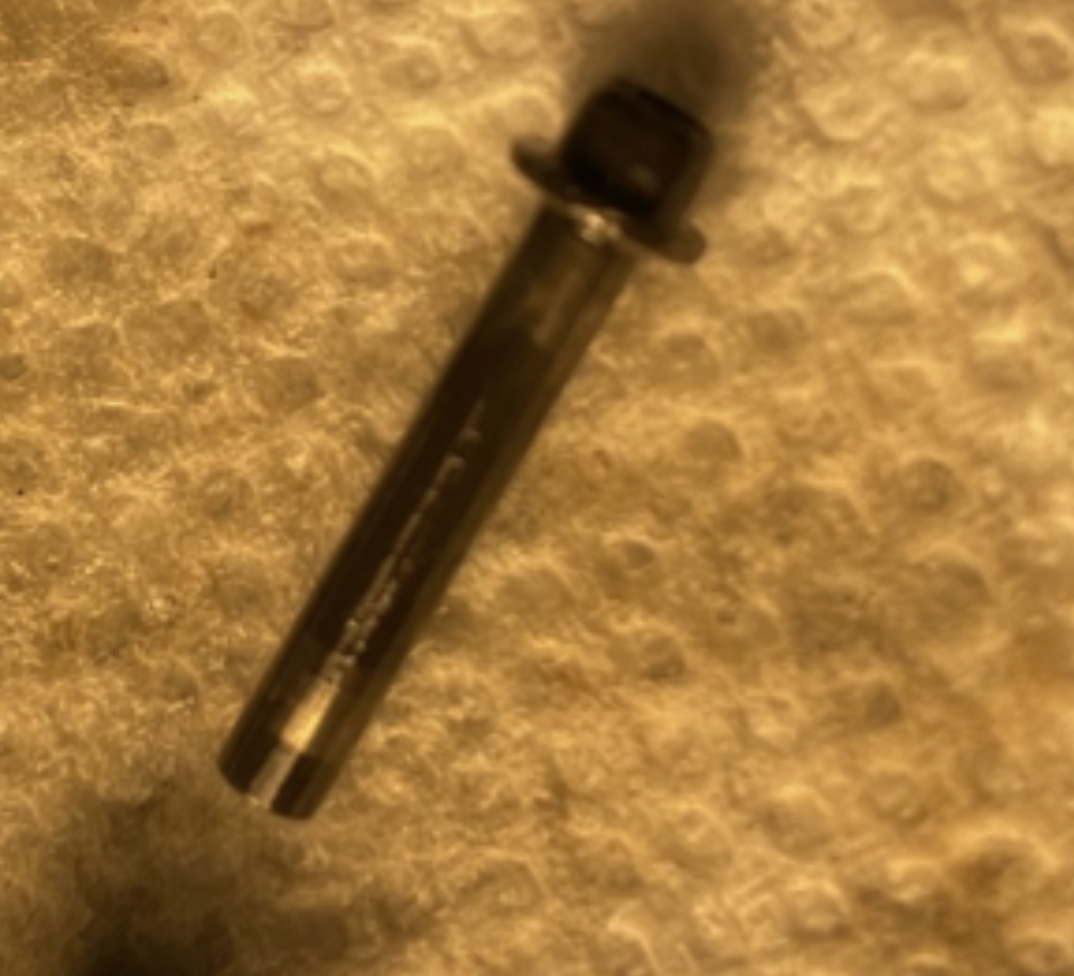

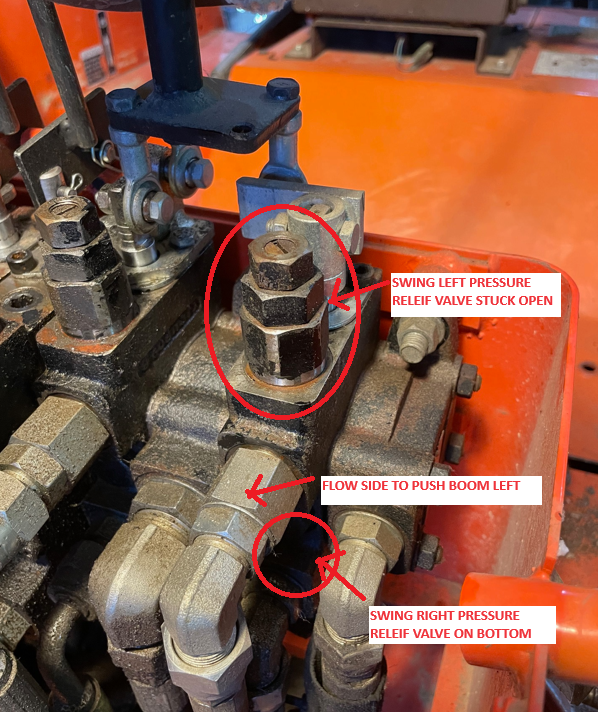

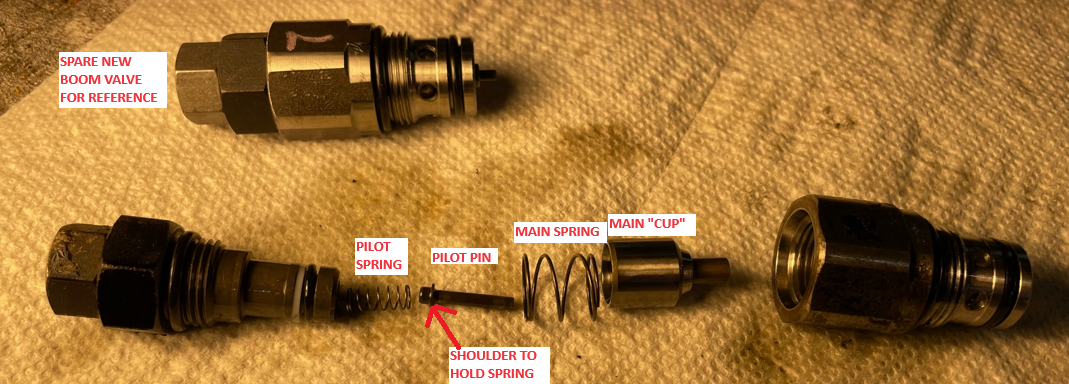

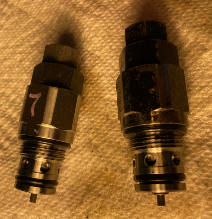

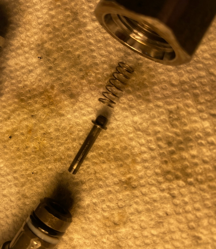

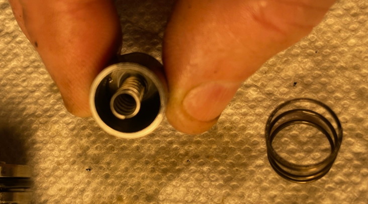

I want to update that mine has had issues again and every-time I open up to check the pin is stuck.
I originally cleaned it, so I thought... but this time I ran it for hours in my ultra-sonic cleaner at a higher temp and it came out MUCH cleaner. I'm not sure if the overheat hydraulic system "baked it" with mm or so of black gunk but when that is stuck it doesn't work as expected, with it free moving it works 100% fine. I popped off all the gaskets off and ultra-sonic cleaned EVERYTHING in carb\engine safe cleaner (made for ultrasonic cleaner).
I think this may be a combination issue:
1) 100% from pin getting stuck
2) pin gets stuck from hydraulic fluid baking on the pin making it not move smoothly
3) hydraulic fluid baking on the pin is from over-heating the fluid, or, possibly just running it very hot (within spec) for long-periods of time. Not necessarily running at high rpm for long periods but running it very hot (ie: hard use)
I've yet to find any contaminants in my fluid like others have mentioned finding little pieces of something.
Since I've been able to fix mine at least 4 times now by cleaning that pin (before this deep-clean) I'm rather sure I've isolated the problem to the valve\pin and the heat.

I'm original\new owner.
The fluid was fresh as were all 3 filters.
The only new hydraulic anything was 5+ years ago, and the fluids have been changed at-least 2x since then. Yes, my cylinders get that hot when operating as well. The fluid was not dirty, different color, off-color, hazy, or in any other way contaminated, my assumption was heat, as my radiators were partially clogged due to the conditions I operate in, and that's why I assumed some fluid baked onto the small pin not allowing movement. Either way, once I cleaned it, it worked as expected. I've taken apart the valve stack components to examine, and clean, and all of them are spotless that I've looked at.
I purchased a new valve for the swing (one direction) and installed that, and the pin IS coated with something, my old one was NOT anymore, it was worn out, which is why I think a very-very thin layer of hydraulic fluid film or "burn on" hydraulic fluid was causing it to not function as expected. Note- I did not replace the left and right valves, just one that was causing the issue. (important to note for anyone reading this in the future that each direction needs it's own, you'll see this as one on top the valve stack and one on the bottom for each function)
Either way, wanted to update this thread with the "I replaced it with a new one" ($700) for piece of mind, and kept the old one as a spare, spare components, etc...
